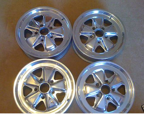

Sorry guys, I appreciate your help, but I want to be sure that the fuchs I have been offered are right for my narrow bodied 914.
They are 16 x 6 and I have asked for the seller to send me the part numbers, fo r which I have received the following reply...
911 361.020 [43]. And 911 362.113. There are two wheels with the first part number and two wheels with the second part number on them. All the wheels have as10.62 on them. I'm pretty sure the offset is et36
Would these be good for me to spend my $$$ on??

6x16
36 mm
911.362.113.00 (late)
911.361.020.43 (early)
I dont know the diff on the sixes , But on the sevens thearly and late have a different shape triangle window between the spokes.
One being square on the rim side and the other curved .
Get pictures of- each.-

QUOTE(sixnotfour @ Oct 2 2009, 08:40 PM) *
6x16
36 mm
Thanks for your help - here is a picture of them all

brant
post Oct 2 2009, 03:27 PM
Posts: 12,183
From: Colorado
Member No.: 47
I think Jeff might have mis-read
on the 16's, I don't think there is an earyl/late, heart issue
your good
16 x6's fit well
probably 16x7s would fit with a narrow tire..
but the 6's are really safe
your good to go!

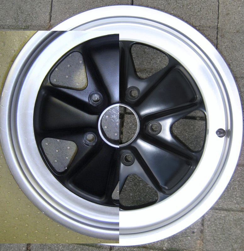

There is a early and late PN and on the 16x7's the base of the heart early curved and late straight.

QUOTE(sixnotfour @ Oct 2 2009, 11:14 PM) *
So what are the differences between the four wheels, bar the part number? (IMG:style_emoticons/default/pray.gif)

I found some documentation, All mine are early.pre 85 The 7's definately have a different shape heart.
http://forums.pelicanparts.com/porsche-911...variations.html
