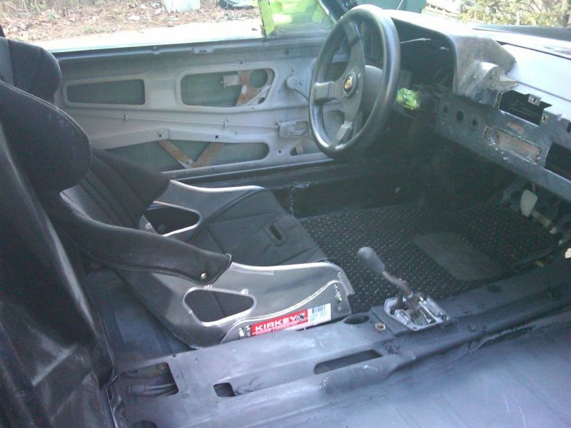

d914   seats,,,ultra shield rally   Oct 4 2009, 02:56 PM

ghuff   What is that shifter setup? That looks delightfull...   Oct 4 2009, 07:37 PM
d914   Im using the suby tranny with a honda cable shifte...   Oct 4 2009, 07:39 PM

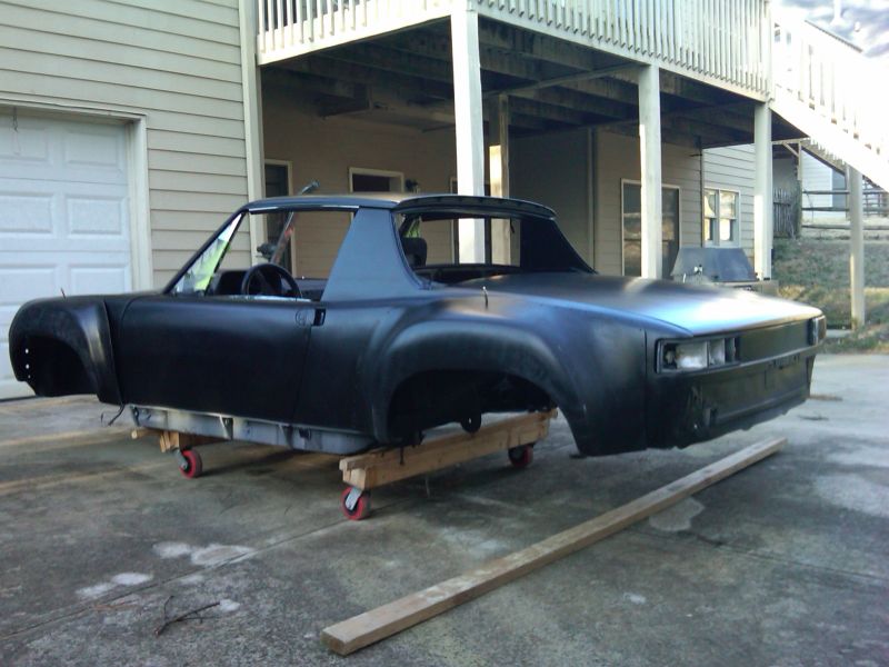

d914   painted and putting the flares on!!   Nov 13 2010, 02:25 PM
d914   one side done, came out reasonably well conciderin...   Nov 13 2010, 02:27 PM
