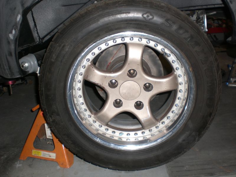

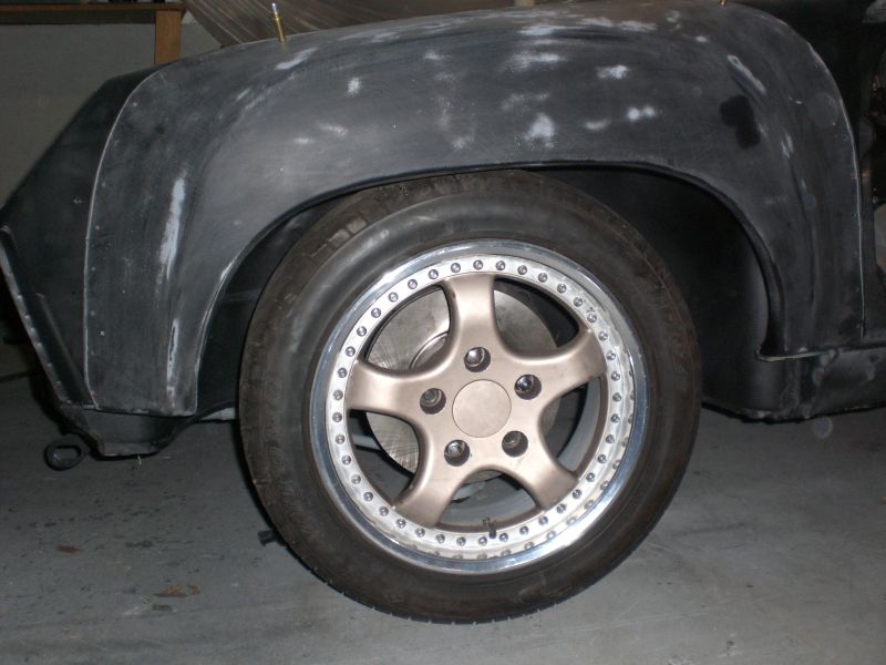

picked up a set of three piece wheels...16" 8&9's... unknown manufacturer..
only info on back... Made in Japan....F-206
Im going to paint the centers black,,, and give the rest a good cleaning

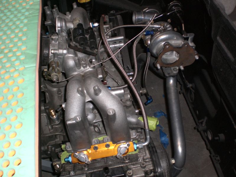

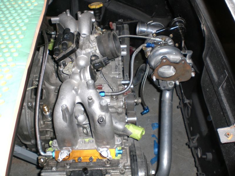

engine in and mocked up two ways..
First intake forward.. To do this must move alternator( I have the bracket) raise the turbo and run a 180 turn in the intercooler.
the other is to run with intake to the rear.. I think I have room of the pipes.. I can still raise the turbo a little , to make pipe angles easier, and hvae a 180 in the back with a straight thru intercooler..

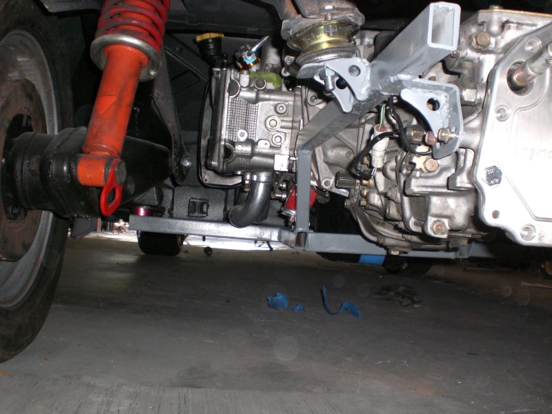

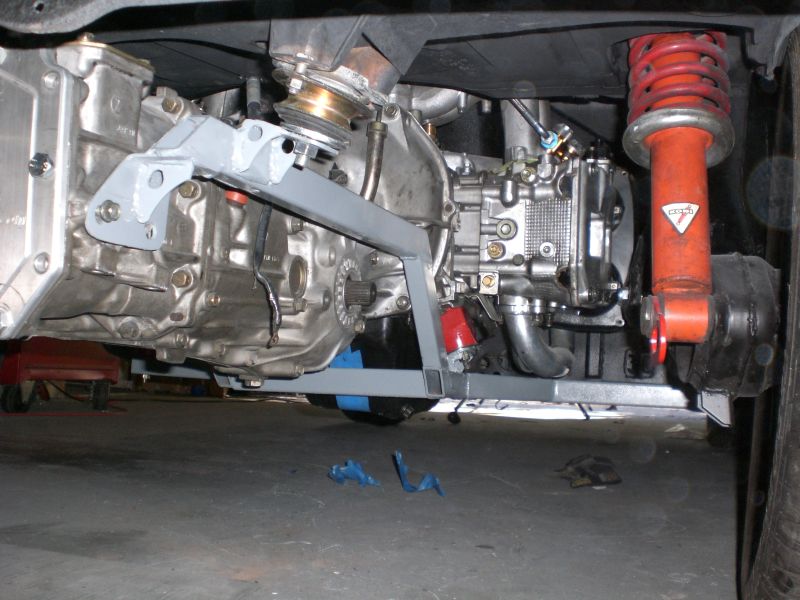

engine bar back in

I took out the engine tray to keep things clean and give some better access.. I could so something like that and use fasteners to drop out of the way for service...uummmm phase 2... I need this thing on the ground and under power for some fun.. its been drug out way to long..

QUOTE(d914 @ Oct 31 2010, 09:29 PM) *
the way you built the engine frame, it's easy to make a flat bottom!
Keep up the Nice work!

Greg I was looking at the turbo and thought about the restrictor that goes in the oil line to the turbo. Are you using one? We had to use a smaller one on my sons sti because we used a 12mm oil pump with a external pressure regulator and the oil pressure was higher so we had to change to a smaller restrictor to the turbo line to keep from blowing the seal or pumping oil through the turbo.

I got the line from outback,,,its like a dash 3 or 4 and a -10 as the drain. I also retained stock oil pump.. The engine is bone stock w the exception of elimination of unneede sub systems.. The engine itself is a roll of the dice on life span... I see a rebuilt short block in my future!!
