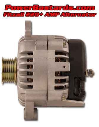

I just googled it and found a nice 220 amp replacment as opposed to our 55 amp stock. (if it fits)Click to view attachment
Holy Shit!
http://powerbastards.com/proddetail.asp?prod=Fitzall%2D220
