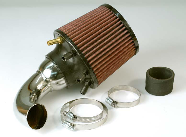

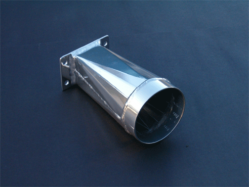

I was browsing the AA catalog and came across the MSDS high flow cone air filter (catalog page 28). The ad claims that one can gain upto 10 more HP using this air filter. Is this true? Has anyone else used one of these?
BTW my engine is a 2056, stock FI with Raby's 9550 cam and tuned MPS.
HPH sells a bored throttle body and claims HP gain with the TB. True?

Martin Schneider makes these You could call him at msds and ask, anytime one increases the air flow the horsepower increases. Of course personally I would NEVER install one on my car unless I had a racing car where I would always be running at maximum RPM.

if you engine is well tuned, my guess would be in the 2-3hp gain
if it's having issues getting enough air, then it might help 5-6hp
basically, I don't think they help much...
edit:
nevermind, even the guy standing to make a few pennies is telling you don't bother...

Even claims of 2-3 HP is pushing the envelope of reality. But you WILL, after an extended period, get a really loose motor from all the crap that passes through that "filter". More air flow through fewer square inches of filter material = larger pores in the material.

My only real interest in a setup like that is -weight-. The stock air box for a 2.0L is not light by any stretch. And I would say that something like this fits well under Brant's $50/lb threshold for investment.
I doubt it actually improves power by much (if any) unless the air filter element you're replacing is totally clogged up with cr*p.
Louder? Sure.
Lighter? Very likely.
More power? Doubtful.

Don't know if it would either, but in either case I think the limiting factor would be the tiny throttle bodies anyway. especially the 1.7. If my car actually ran I could see the difference between the two with the megasquirt and log it on the computer. But those little pieces of teeth in the bell housing are a different story.

For what it is worth, I have spent quite a bit of time on a dyno tuning my spec miata and there are 3-5 hp differences between a stock miata airbox and cone filter assembly. The early miata and the 1.8 914 have a similar intake because they use a airbox with a snorkel and bosch AFM. On the miata we found that the AFM is a large restriction and the box itself is a restriction but only one of those can be fixed, basically you can reduce all the restriction you want from the air filter assembly but only so much air is going to go through the AFM. So, the goal is to find a filter assembly that will flow air the best THROUGH the AFM. Someone with more time on their hands than me has done the testing with a flowbench and found that the AFM and the airbox were the restrictions in the system of the miata. I am pretty sure that no one has really done that kind of testing on a 1.8 914, I mean why would you. The fact is, if the 1.8L doesn't flow enough to max out the flow of the AFM or the air box/filter then you probably aren't leaving that much on the table. Then again, if it is maxing it out then there could potentially be some good HP being left on the table.
It also goes without saying that you should probably adjust your AFM if you are going to modify your intake filter assembly etc.
So, is it worth it for 0-5hp? Well, if it is a 5hp gain well thats like a 6-7% gain in HP at the wheels on a stock 914. I guess its up to you.
