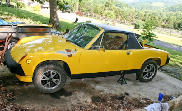

Thanks for the tips guys. Had a great weekend working on the 914. Didn't get a lot done but I did post pics and started a blog. Check out my sig line if you're interested. Have a good one!
IPB Image
