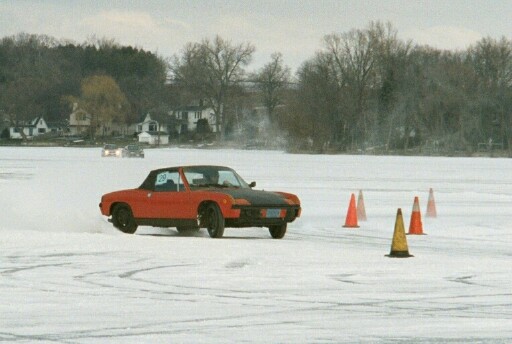

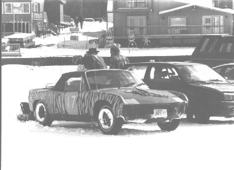

I love driving in the snow as well, easy to get sideways driving.gif ...but not in my 914-6.....i went with #1
Bruce Hinds
I love it! Drive it man! That's what it was built for. It bugs the whits out of me to hear all the pussies say "I don't drive it in the rain." The're missing all the fun! The reason they were built was for German weather. I drove mine all year long when we were in Colorado, but they don't use salt on the road. I love driving it when it's slippery, it's just too much fun.
There's one town as you head west of Denver and just get back into the mountains that has ice racing each year. Some of those nuts actually put bolts in the tires for the studs and tear up the ice. I'd always wanted to do that with the teener.

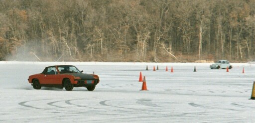

Georgetown. I am one of those nuts. Burned up 2 craftsman drills bolting a set of junk yard tires for my old GTI back in the 90's.... GREAT fun! All the events I did in those days were under the SCCA.
