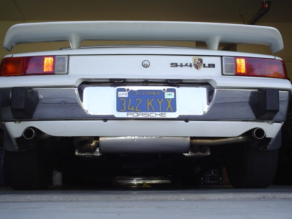

Here is a picture of the Monza i just took off, and a custom job that was sent to me from chris Banus- My h.e.'s were shot(75 2.0) so i am backdating to a 74 system, picked up new/used S.S. h.e. for great price, now have to decide which muffler- I liked the Monza sound not tinny or raspy. However, Chris had this but all the pipes had surface rust, so as you can see i removed the rust with wire brush, then rust remover from eastwood, then high temp. manifold paint(silver) -
if you look close I think this was custom made using the central pipes from a monza, someone welded in the new mufflers and added the single pipe on both sides. If it works out and i like the sound- i will cut the tips off and add SS tips from local auto supply.
(thanks Chris!)
I think the Magnaflow is a great Idea, just take the central pipes and the flanges off the monza if you do not like it, and have them place the magnaflow sport SS in there and you will be set!
