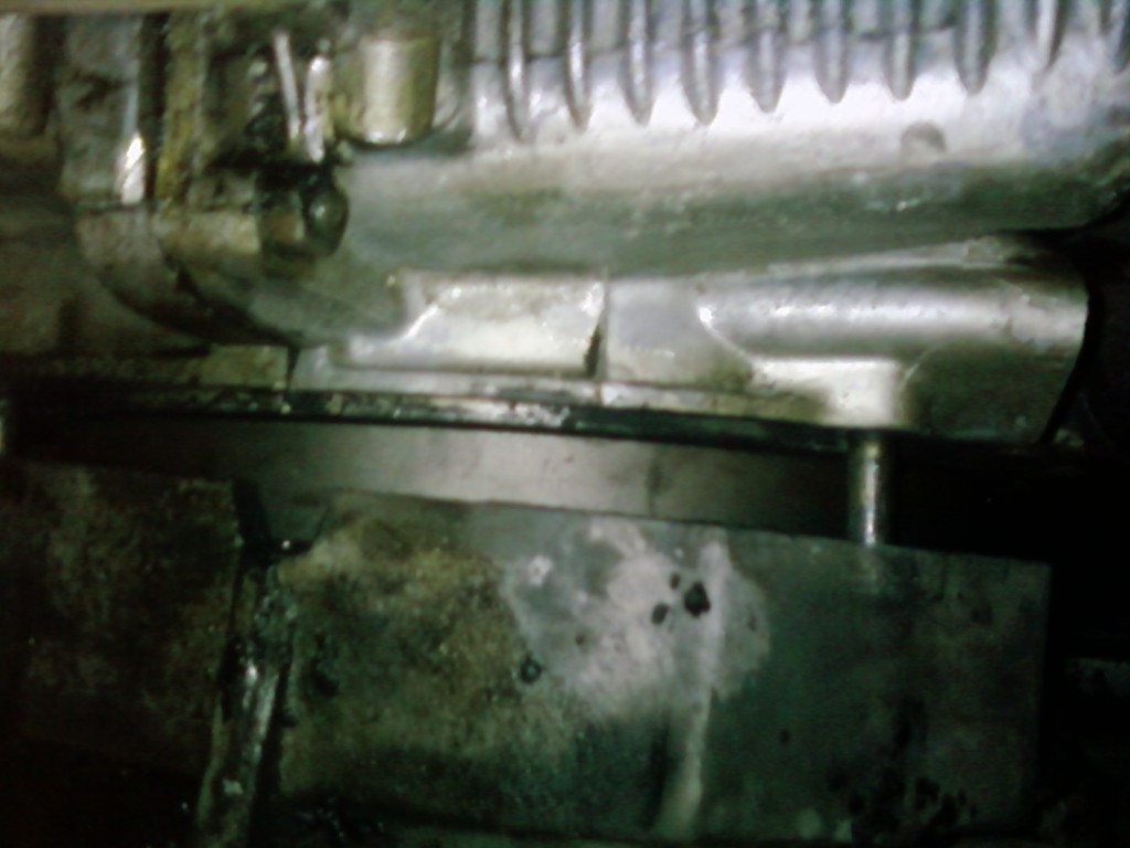

Now we can't get the transmission back on, theres a gap of nearly an inch and it's not going on...
jsaum
It sounds like the splines aren't lining up with the pressure plate. Did you use an alignment tool when you installed the new clutch and pressure plate? If so and you're sure they're aligned properly try turning the axle with the transmission in gear to turn the input shaft. you should be able to feel the splines line up and be able to push the transmission and engine together. Make sure that you have the transmission and the engine lined up at equal levels. If the transmission isn't level then the input shaft could be hanging up.

Heres the gap
IPB Image

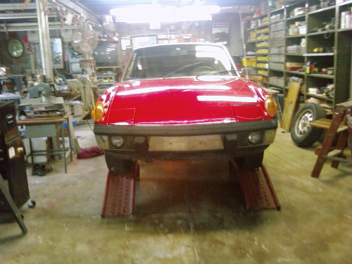

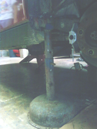

I ended up using ramps up front and jackstands in the back
IPB Image
IPB Image

I'd take the transmission back off, loosen the pressure plate bolts and be sure you have the clutch plate properly aligned with the clutch tool inserted all the way. Then retighten the pressure plate bolts, retorque, and the remove the tool. The transmission should line up easily, though you often have to raise the back end up a bit as the natural tendency is to have that end drooping. You can also try twisting the transmission to help align the splines, but it should slide in fairly easily.
