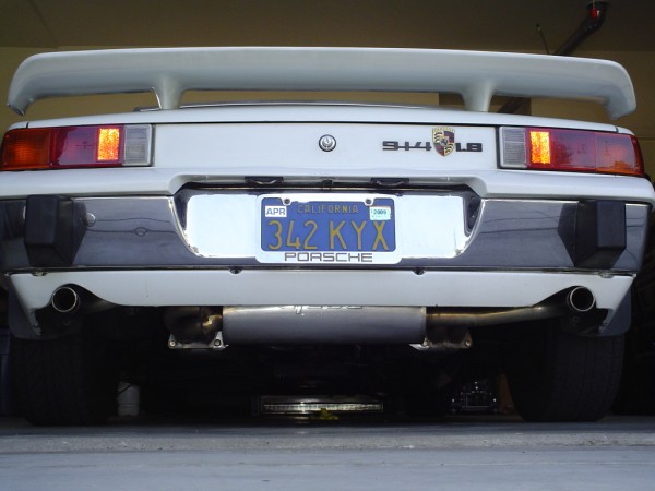

or you could......
william1764
QUOTE(DanT @ Aug 23 2010, 07:03 PM) *
or you could......
That is cool looking - who makes it?

DanT
QUOTE(william1764 @ Aug 24 2010, 09:14 AM) *
or you could......
Me...it is a modified stock 2.0L banana....

william1764
QUOTE(DanT @ Aug 24 2010, 09:53 AM) *
or you could......
