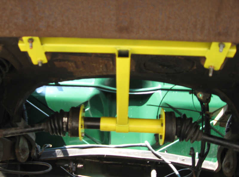

I was tired of the axle shafts hanging down on a car with the engine removed a long time ago.
I've used bungees, coat hangers, tie downs, etc. to hold them up out of the way while crawling about under the car.
Its even worse when you have to move the car and the halfshafts bang around, sometimes jamming a CV joint.
Some time ago I came up with the idea of using a 2 ft. piece of cardboard tube over the inner CVs to keep them together but the tube rolls off to one side quickly and one axle falls out.
Its only a minor irritation but with the number of cars we have at the shop which are engine-less, often needing to be pushed around from one area to another, I wanted a better solution.
So here it is:
The bracket bolts to the rear trans mounts, and the flange/tube assembly acts like an open diff. The flanges will have bolt holes for 3 different CV sizes often used on 914s.

doesn't look like the right side will rotate... how does the car roll? idea.gif

Take a better look, the two sides move independent of each other. Chris did that as a low tech diff so you're not fighting a solid shaft when turning corners.
The assembly comprises three independent sleeves. It works perfectly.
I wish I had thought of this a long time ago. We already have 2 prototypes in use and a third nearly ready for service.

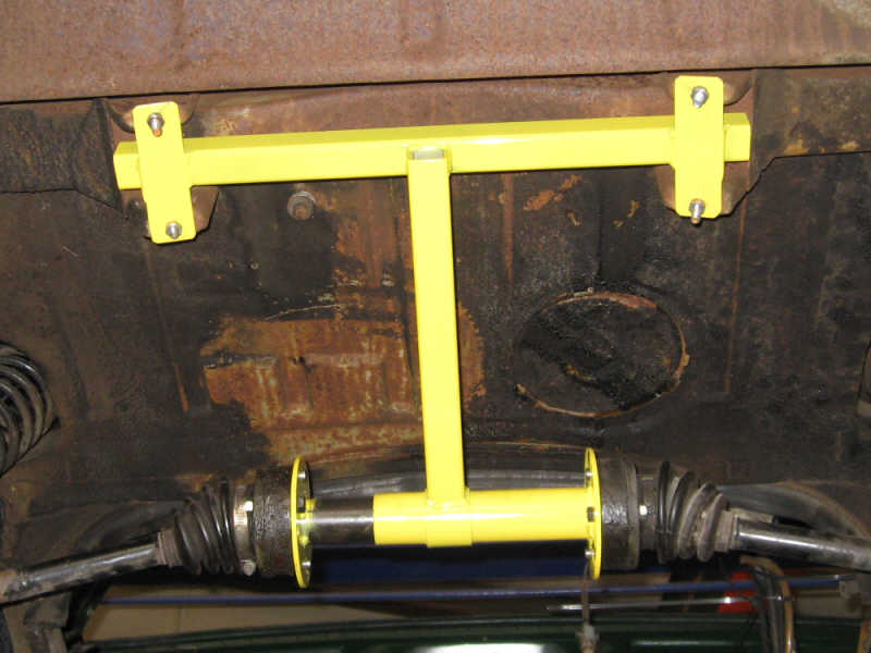

Drill two independant holes that accept hitch pins or grade 8 bolts. This will allow for the locking of the unit that doesn't allow it to rotate. Then you can break the castle nuts on the outside AFTER the motor has been removed! (the two bolts also keep it together for storage =bonus!)
It can also act as a LOCK to keep the car from rolling....

Ooh, I don't think I want to try implementing that idea. Those nuts take too much force for the fixture to withstand.

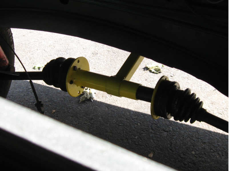

Also, what does it take to remove the shafts from the trailing arms?
You can unbolt the stub axle using a big ass wrench or reach into the hole in the back side of the trailing arm and remove the four 12 point bolts that hold the CV to the stub axle.
If the CV joints are removed can the car still be rolled?
Its not wise to move the car without stub axles bolted into the hubs.
