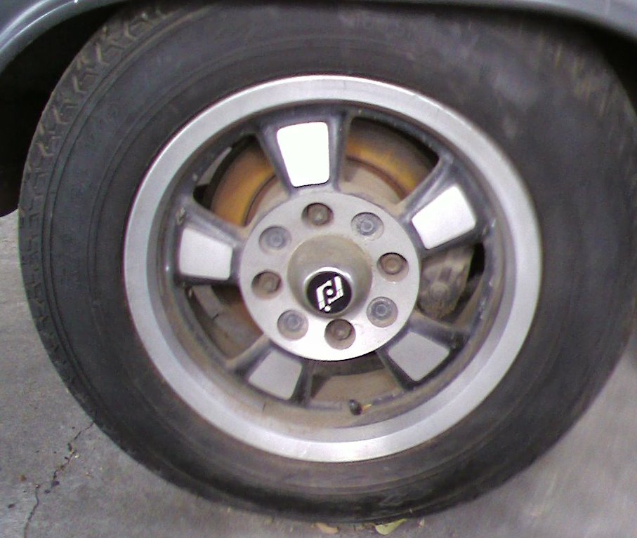

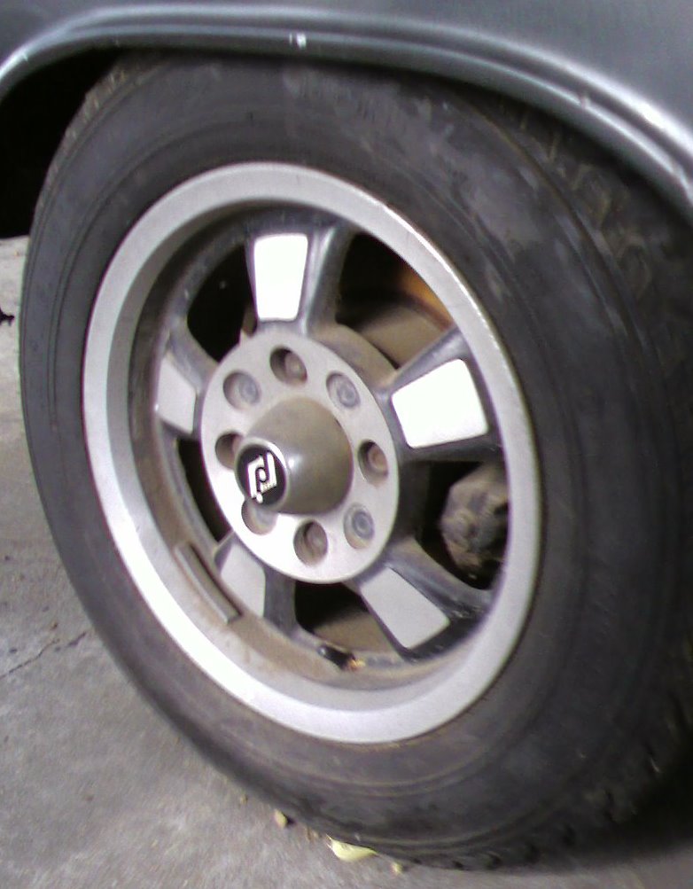

Nope - at least not with my original Rivs - the later repops may be different, or you may have a bent/tweaked rim, or the tires may the problem.
FYI - the "real" Rivs look like this with the smooth outer rim (and interlocking lower case "r" logo on the center caps), whereas the repops have the lip to attach clip-on weights (not advised in any case & they look tacky).
Click to view attachmentClick to view attachment

gothspeed
QUOTE(Tom_T @ Oct 19 2010, 07:57 PM) *
QUOTE(914 shifter @ Oct 19 2010, 07:47 PM) *
i had my wheels balanced and they had to put a lot of weights on them.are rivieras known for this? lol-2.gif
Freakin awesome!!!! Thanks for the pics!!!! I guess I have REAL Rivieras on my 73' smile.gif!!!!!!!!!!!!!!!
