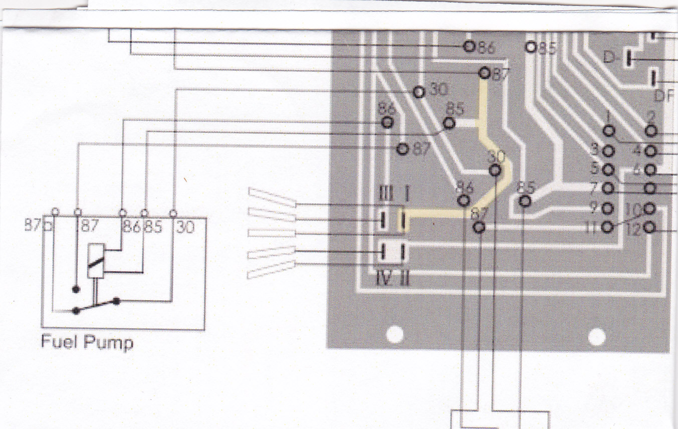

Click to view attachmentWhich terminal does the yellow wire plug into I or III?

Look at the rest of the wiring diagram. It's available on the Bird Board, I believe.

The Yellow wire on my '75 relay board goes to IV
dr914@autoatlanta.com
yup right rear. For all 1.8 models.
QUOTE(jim_hoyland @ Oct 21 2010, 07:16 AM) *
ClayPerrine
QUOTE(dr914@autoatlanta.com @ Oct 21 2010, 10:14 AM) *
It can plug into either rear connector. Also makes an easy way to crank the engine. Just feed power there and the starter engages.

idea.gif If the coil and that rear connector get 12v, it's gonna start ?
