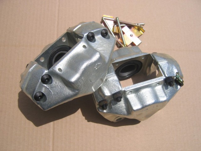

M-Calipers:
IPB Image
* 48mm Pistons
* Steel
* Ribe M8 Fasteners (13mm nuts)
* AP31 pad size (same as the early 914 front and 914-6 rear)
* Side Fluid inlet
* 3" mounting ear spacing
* 7lbs 6oz without pads

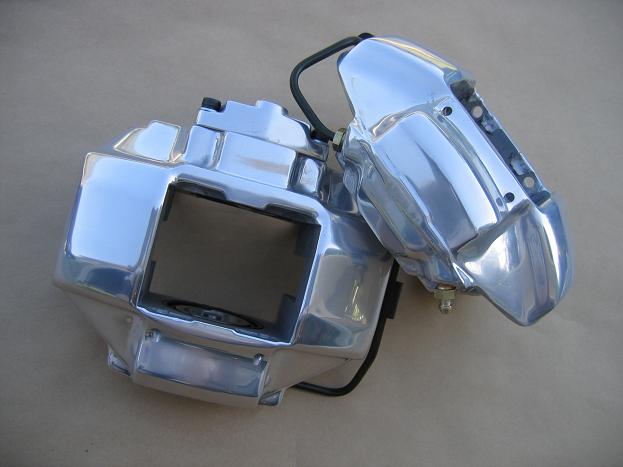

S-Caliper:
IPB Image
* 48mm Pistons
* Aluminum
* Early units are cast off the 908 caliper casting and are clear anodized.
* Later units are a combination of the 910 style nose and 908 rear and are greenish in color due to the dichromate sealant.
* AP45T pad size (same as the A-Caliper but the "T" stands for thicker)
* Side Fluid inlet
* 3.5" mounting ear spacing
* 5lbs 6oz without pads

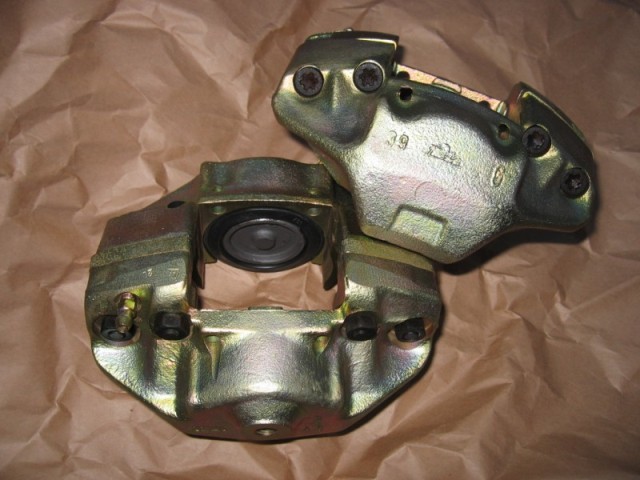

A-Caliper:
IPB Image
* 48mm Pistons
* Steel
* Ribe M9 Fasteners (14mm nuts but small R6 heads)
* AP45 pad size (same as the S-Caliper but not as thick)
* Fluid inlet on the bottom of the widows peak in the back
* Heaviest caliper ever made for a Porsche at 9lbs 4oz without pads. Read: PIG in the unsprung weight category.
