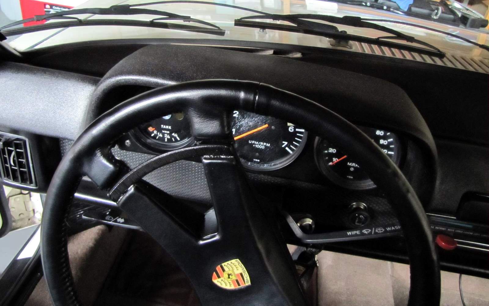

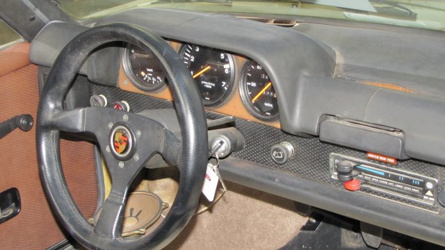

dash capI repaired mine myself.
Here are the before and after pictures.
Click to view attachmentClick to view attachment

Click to view attachmentClick to view attachmentAnd you replaced that god awful brown dash face,too. ty. What did you do with the steering wheel in the first pic?
The brown dash (rust brown to be exact) was stripped and repainted.
The nice Momo steering wheel was sold to a good fellow on this site. I opted for the original.

How is this repair holding up? I read the repair procedure on the other board. How did you prep the vinyl to accept the truck bed spray?
The repair holds on well with one exception. Some of the cracks I repaired in the garage and some I did outside in the sun. Those done outside hold well and those done inside are cracking back a bit.
I think that you need to have the dash hot and fully expanded before you start fixing the cracks.
