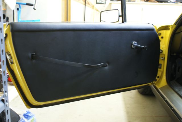

He does! Here is mine installed....

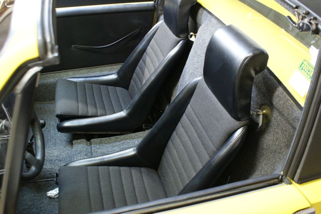

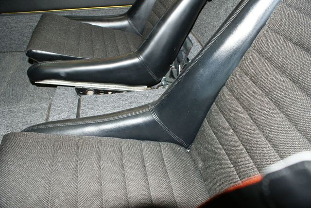

For Jason - The seats. Just had them recovered. None for sale!
jasons
Looks great Mike! Did you build up the bolster a little?
MoveQik
QUOTE(jasons @ Feb 25 2011, 08:14 AM) *
Yeah. I like the look and feel a lot better.

Wow! Looks great! Are those door panels leather or vinyl? Can I ask how much ? How about the fit and quality? Cheers and love the seats too.
Thanks!
They are covered in vinyl. They are Morphs fiberglass panels but I had them covered here locally when I decided to go with the GT style pulls. I'll have to check on price. They did them for me because I do a lot of work with the shop. They did my seats as well.

Michael, What did you use on the rear bulkhead in place of the back pad? Your interior looks great by the way.
MoveQik
QUOTE(maf914 @ Feb 26 2011, 08:12 AM) *
Thanks. I used perlon. Very inexpensive and easy to work with. I put down Dynamat, then the perlon.
