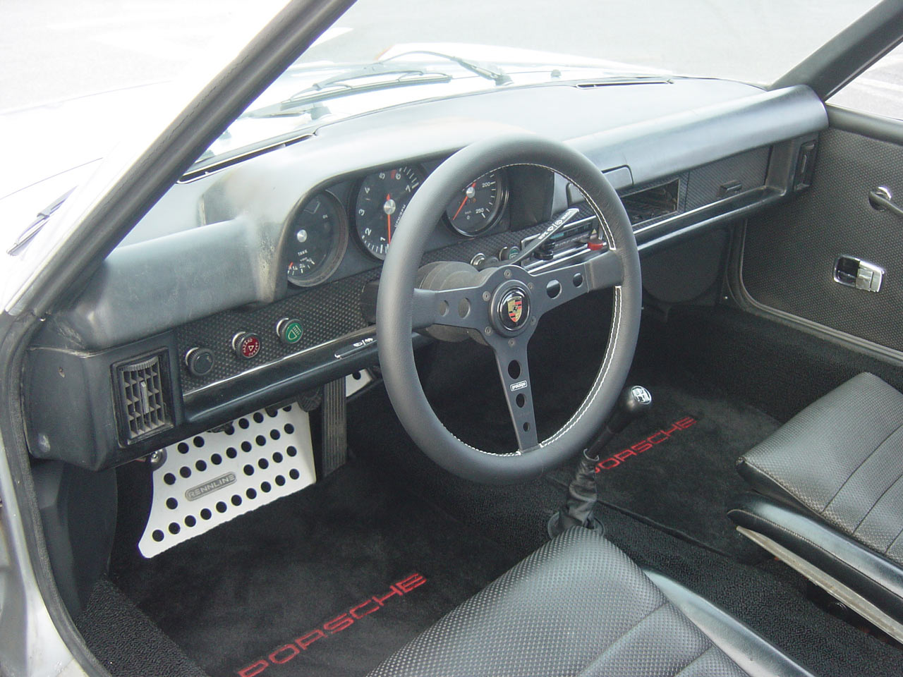

I went with the Morph kit too and for the price its very nice. I installed it myself and it looks excellent. I went with black loop instead of grey cause I like the look and it matches my Lloyds matts nicely too and just really gives the whole interior a new look. Here is a picture. Morph also sewed in a leather shift boot for me as well.

Wow! Looks great! Are those door panels leather or vinyl? Can I ask how much ? How about the fit and quality? Cheers and love the seats too.
