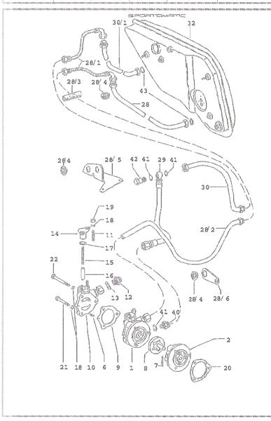

The tank has two additional tapped holes (besides the mounting holes) that I assume to be for sportmatic oil lines (pretty small holes, tho) that I'd like to fill. Anybody know for sure? Are there other issues using these tanks?

Pet showed the sporto and normal six as having the same tank part number.....the sporto tank set up....I would weld up the unused holes...

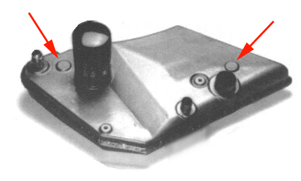

Every one I got just had the two drilled and tapped bosses at the top, at the stock mounting location. My guess is someone FUBAR'd and make extra holes in the wrong spots.

I am looking at a tank that i have here from the current run. The bosses with the red arrows are not tapped or drilled. if the holes are small then i would guess that someone wanted more mounting points. Having just seen pictures of a members sporto tank, the holes would have to be fairly large to be used for oil. beerchug.gif
