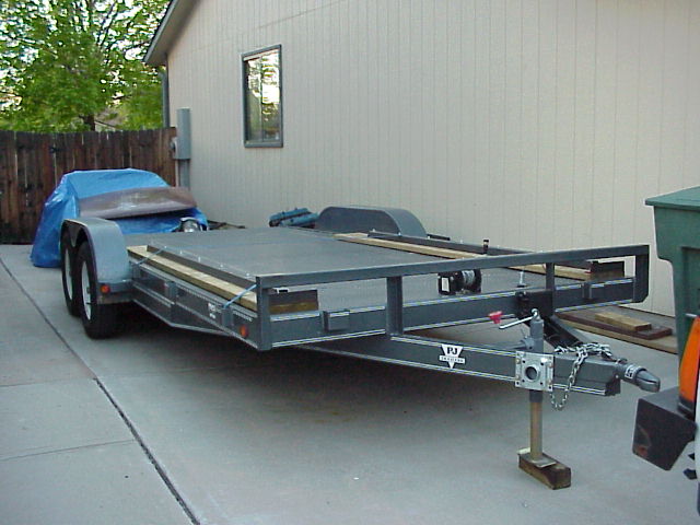

campbellcj
Jun 29 2004, 09:03 PM
Here's mine - 16' 2002 Carson steel bed, tandem, electric brakes. It tows really nicely and is just barely light enough for one person to move around by hand if required.
The only problem is the paint used by the factory is crap. It will need to be repainted in a marine epoxy or something, as it is stored outside.
