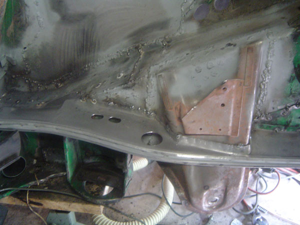

thomasotten
I replaced the whole thing, you don't need a jig. It is alot of work, but now I don't have to worry about it...

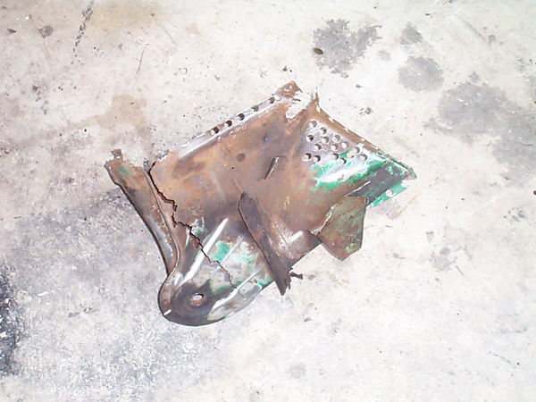

thomasotten
Here it is removed...

It hasn't been driven yet, so we don't know yet how my welds will hold! I was considering doing the scab plate idea, but was talked out of it. The whole ordeal was alot of work, but I am glad I did it, at least now I have confidence in the car's integrity. As far as Andy's car is concerned, putting a scrap plate of metal over it really isn't going to do much for you other than keep water out of the whole, since yours was already fixed with those rods. Look at the photo of how mine cracked. Basically, the metal rusted from the inside, getting thiner and thiner unitl it cracked. The crack started on the forward part, near the longitudinal. That piece was very thin right there.
I am not planning on ever selling my car, it will hopefully stay in the family for many generations. That is why I decided to fix it right.
