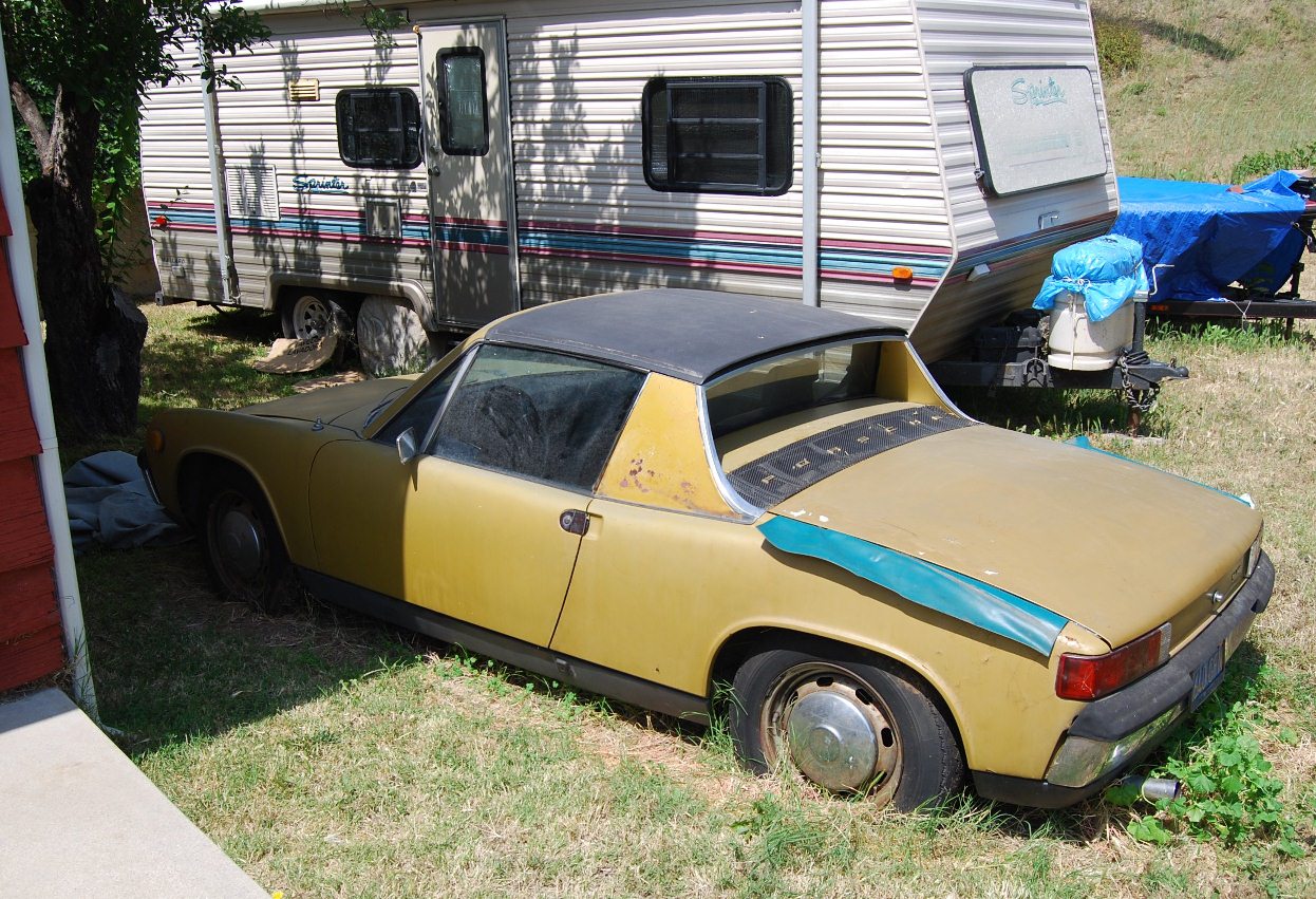

Thanks ahead of time all you crazy teeners. Because everyone likes pictures, here it is just before being rescued. Also see signature for link to gallery.

spent some time looking at your photos - you have a great car there by the looks of it. Well worth the effort to keep her going.
The longs look original - one little hole is nothing. The lift points are intact - thats impressive if original. The hell hole obviously needs some work but it is not as bad as many that have been featured on these pages.
