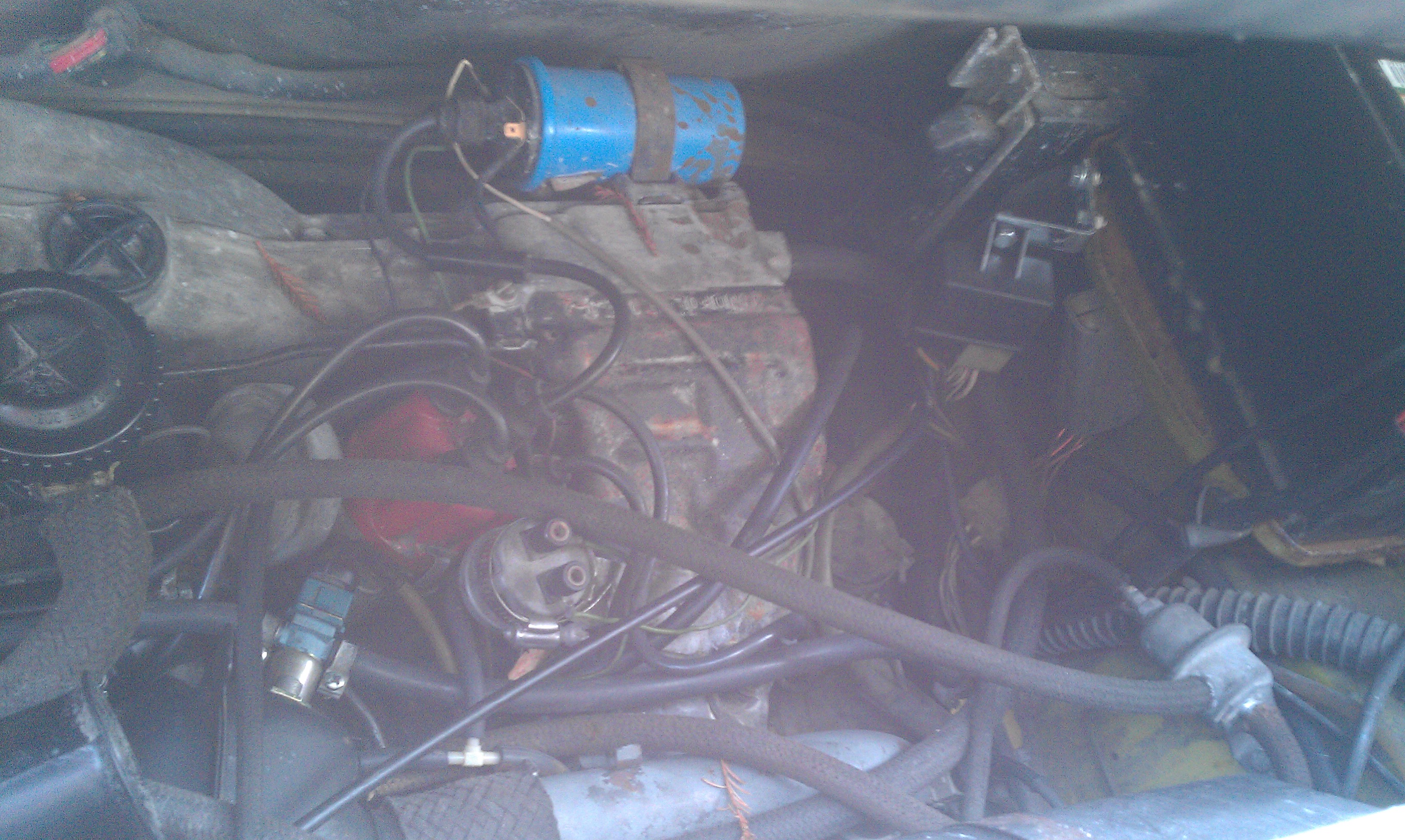

pictures of the car
hbgsteve
Oct 18 2011, 07:21 PM
more pics
bigkensteele
Oct 18 2011, 08:04 PM
Given the color of that speedo needle, I would question the mileage and look at this car very thoroughly before buying. Looks to be about a $1500 car to me.
Elliot Cannon
Oct 18 2011, 11:45 PM
32,572 miles on a 37 year old car is somewhat suspect. I would be concerned that it might be 132,572 miles. Of course the most important thing is RUST. Point out all the rust to the owner, offer him 1500 and see what happens.

I retract my earlier post about offer 3K and drive it. I'm seeing some body issues here. get the thing on a lift and take a good look underneath.
Randy
JRust
Oct 20 2011, 08:13 AM
Yes get some pics of the Hell hole (Battery tray & below)! That is the biggest cancer spot & the most common. There are plenty of others too but that is the most suspect. If that area is solid It's a car worth getting. $3500 is a bit high though even if it runs perfect. The bumpers are cheap fiberglass replica's. Not necesarily a bad thing but they don't look right on that car. The fit on the rear bumper is all wrong. It should be covering the license plate wires. So it should be up about an inch & a half to 2". On the odometer I would be shocked if it wasn't 132,000. That really isn't a good gage as many odometer's have quite working. So it is probably even more than 132,000. They are easy to change too. So unless you come across an original owner car. It is extremely rare to find a low mileage one.
If it runs & drives good I'd offer $2-2500 if the rust isn't bad. If there are holes in the floor or hell hole. Run away

The engine are the least of the worries looking at this car. It appears from the photos that the front apron was hit and it smells through the computer like a bondo sculpture. In the picture it also looks like the front leading edge door gap is off and the fender looks a bit bowed. My 1.8 is stock with working l-jet and I love it as a 4cyl. keep your foot on the gas, don't lift and have fun.

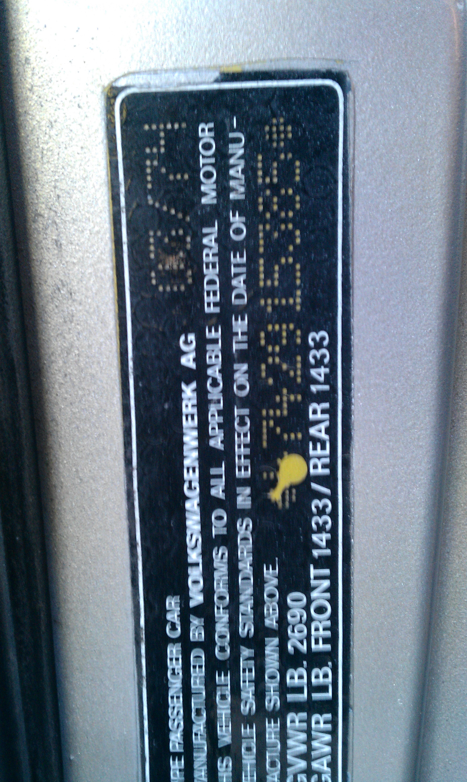

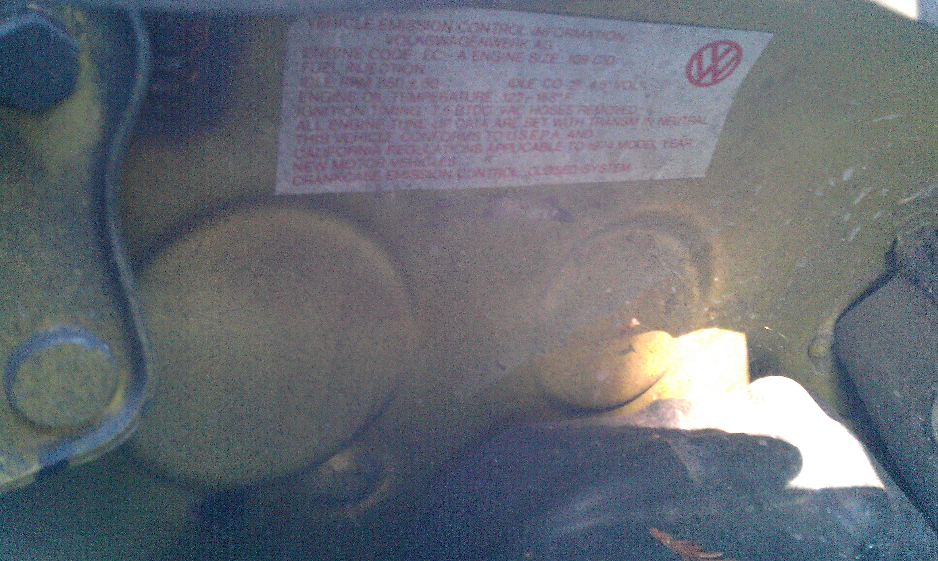

What's the VIN number? I'm curious if it's in the Member's VIN section.
Format: 47429XXXXX EDIT: 4742915385
Locations: (1) embossed plate viewable through windshield, low on driver's side "A" pillar, (2) sticker in driver's side door jamb, just below striker, (3) stamped plate on top of passenger side fender well, in front trunk, near hood spring attachment, (4) aluminum plate on the inside passenger side front trunk, below headlight bucket, (5) valid state vehicle ownership/registration paperwork.

type47fan
Oct 26 2011, 07:24 PM
. . . added to VIN database, with a picture.
Looking through the punched holes in the sticker, it appears that the car was originally yellow (L13K or L13M?). Can you get the numbers (chassis/paint code) from the silver/black square data plate on the driver's side door jamb, just above the bottom door hinge? Thanks!
Note: The chassis number on the data plate will be in a format similar to this: 0949549 (from VIN 4742915355)
jonferns
Oct 26 2011, 08:08 PM
Yes, what is the chassis number? That is only a few vins after mine
