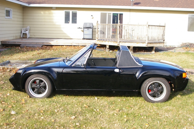

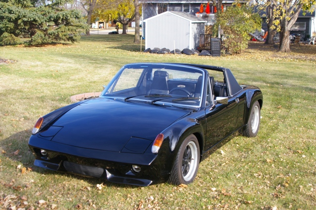

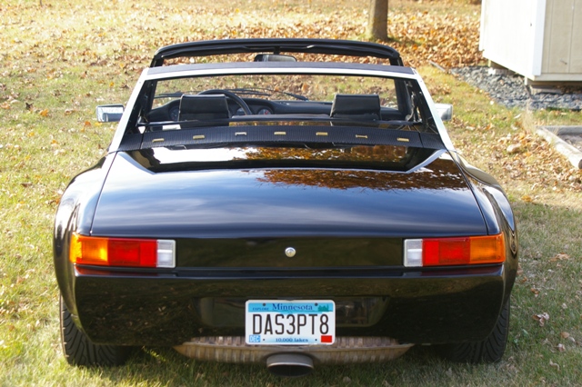

Well, Chappy lit a fie under my A$$ last summer to git'er done. So after 20 years since I started, here it is piratenanner.gif

Very nice!! I like the boxster muffler.
pt_700

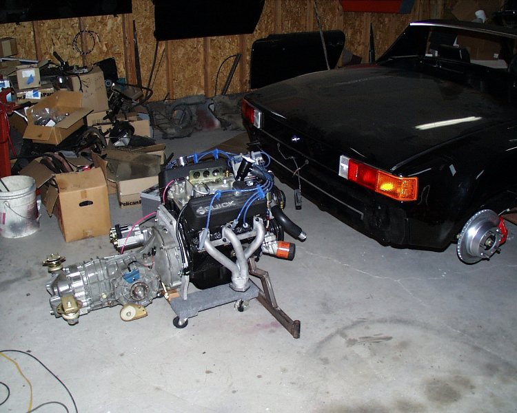

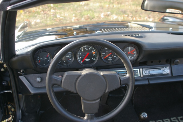

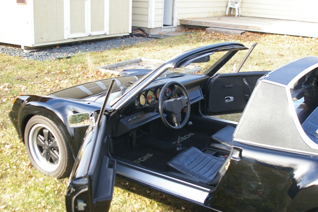

more about the interior, please! is that a getty dash?
engine from a buick grand national (turbo v6)?

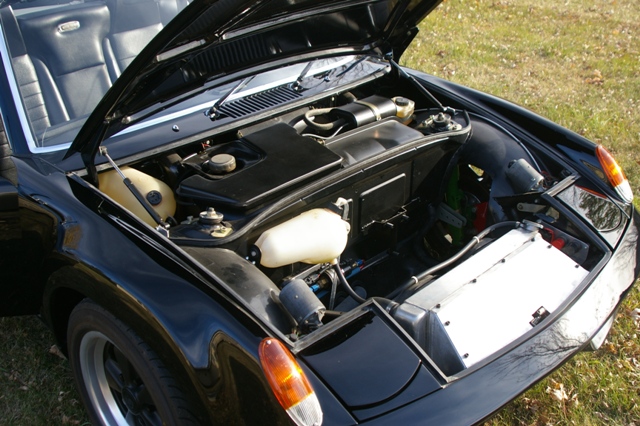

i like the radiator install. looks like you've left room for a spare?
you're kind of teasing us but, it's oh so sweet!

Getty? No, it's a full dash from a 78 911SC. The engine started life as a NA 3.8L. Yes a space saver spare is fitted to the front.

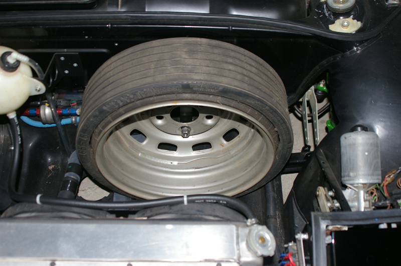

QUOTE(Phoenix-MN @ Nov 4 2011, 08:02 PM) *
Would love to see some more detailed pictures of your space saving spare bracket! I'm going to do the same thing for my V8 car to try to ballast some weight forward in the car and retain rear trunk space.
I see you have the tire mounted more towards the drivers side, any reason for that other than clearing your coolant resevoir? Does it affect airflow much, if at all? Did you have to remove the gas tank or did you just tack a bracket to that front wall? Any bracing?

I mounted it to the side to make for more clearance around the cooling lines , fuel pump and filter. Along with the bracket I made a cradle to support the weight of the spare tire so it did not only hang by the bracket. The car was completely dis-assembled when I put in the bracket so the was no worries about a gas tank. So far I've had no problems with cooling.

It's a 3.8L Buick RWD V6. .030 over with 9.5:1 pistons, Lunatti BM II cam, Harland Sharp roller rockers, Cloyes Double roller timing chain. Manley performance SS valves, Some head porting, Sanderson headers, Holley intake and a Holley HP fuel injection system. I have no real numbers on hp but it should be around 275hp which is a good balance for a car of this size.

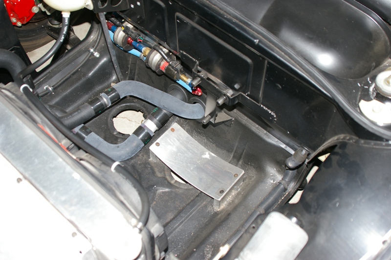

QUOTE(Phoenix-MN @ Nov 5 2011, 06:46 AM) *
Great build!
Are you using heat-shrink on the coolant hoses in the pic above? I have seen that stuff mentioned but have never used it. How is your experience with it?
Geoff
Yes, it's a heat shrink band made by Gates. Absolutely no leaks and it self tightens with every heat cycle. Only drawback is that it's not servicable, you have to use a new one if you take it apart. They're only a couple of bucks and make for a much cleaner installation.
