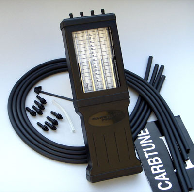

The digital syncrometer sounds awesome, but I can't find one anywhere. I see Digital Anemometers, not sure if that's the ticket though. I've always wanted this thing as I've got some European Dellorto drla 40's with the vacuum ports.
IPB Image
http://www.carbtune.com/

Wow, thanks guys for all the input, I like the Carb-o-tune with 4 inputs I'll pass on the info to the owner see if he'll spring for one or a Snail.
