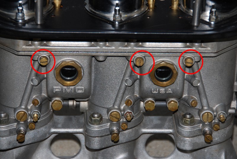

Try blowing out the idle jets. See below, these are the idle jets. Unscrew them out, and make sure there is nothing in the end at the hole on the point. There are 3 on each side. Not sure if yours have a small o-ring, but don't lose them!!
Click to view attachmentIf that doesn't help, maybe it's just the adjustment screw on the linkage that's off. My experience is that engines with carbs never seem to work the same after a time off....no clue why.

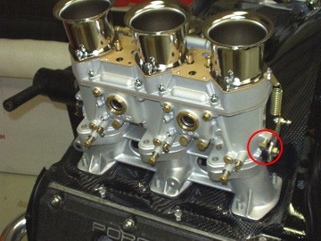

This isn't a good picutre, but on the front of the carbs where the throttle cross bar is there is a stop adjustment screw that stops where the throttle returns to on idle. Try adjusting both sides a little to see if it will up the idle enough to stay running. You may have to readjust back after a while...the engine may correct itself after some time.

I will check the idle jets. and let you know what I find (thanks for the pictures).
