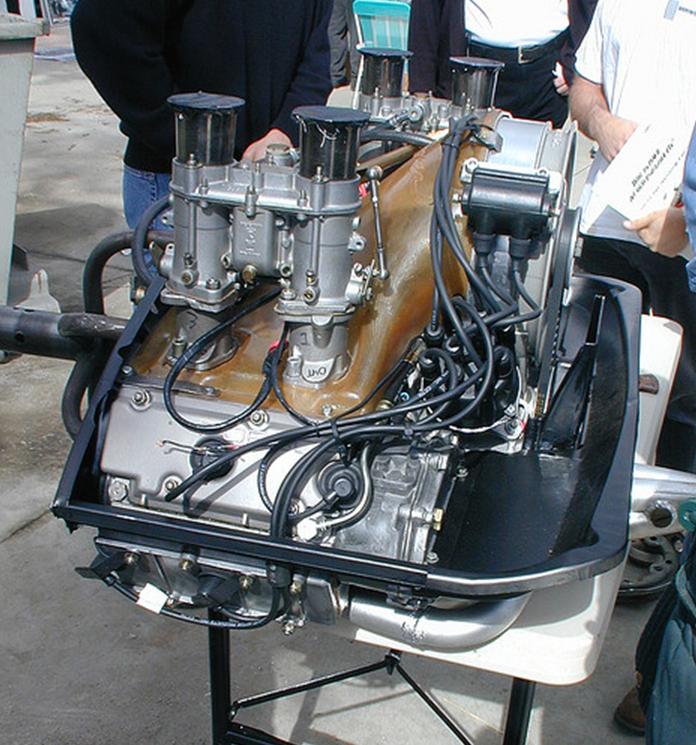

J P Stein
Mar 31 2012, 10:03 AM
I'll assume you know something about engines and show you the big difference.
Had to steal a pic of the T-4 off the forum.

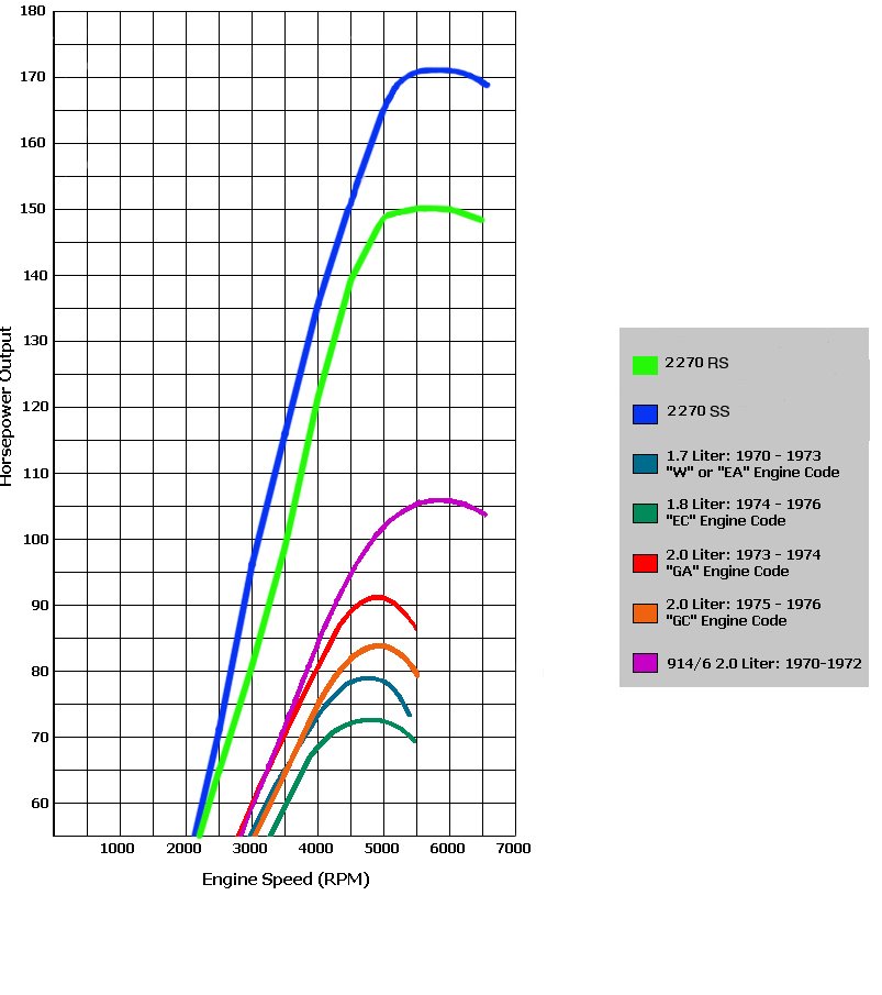

Apr 1 2012, 07:41 PM
Let's throw this challenge up to the big 4 aficionados
Here's a chassis dyno chart from the 2.7L 6 in my old car. Now in all the years I've been on this forum I've never seen a T-4 chassis dyno chart in a 914....lots of pretty designs on paper from hero t-4 builders on their own dyno tho but never through the wheels from an independent source. The first one is the 10.5:1 and the other is 9.7:1. Different dynos.
Whatcha got?

4 is lighter, 6 lasts longer
If all you want is <200hp, and you want the most nimble AXer, seems like a 4 is the way to go.
If you want bigger power that isn't a grenade, and/or you want a track car, and/or you want a crazy street car with a sound that is music to your ears...Then you have to go six if you want to stay Porsche air cooled. (I like it wet... LS1 for less $ and even more hp
For panache, 3.2 or 3.6.

You can purchase one of Jake Raby's high horsepower engines that exhibit longevity, but you're going to be into it $11K probably.
Closer to 12-13K in reality these days.. I just updated all the pricing, dyno graphs and etc for my 3 standardized 914 engines a few weeks ago. You can see all of these here
Aircooled Technology 914 Engine OfferingsHere is a good comparison that one of my engine purchasers came up with who was trying to understand exactly what the differences were in stock TIV power and my two engines two most popular 914 engines was and he threw in stock /6 power as well. He ended up purchasing and we'll be testing his engine in two weeks.

QUOTE(dlestep @ Apr 3 2012, 09:56 AM)
If I had my way I'd do this !!!!!
Click to view attachmentNow you're talking, that'd be the best engine I would say...but the $$ is just too much
