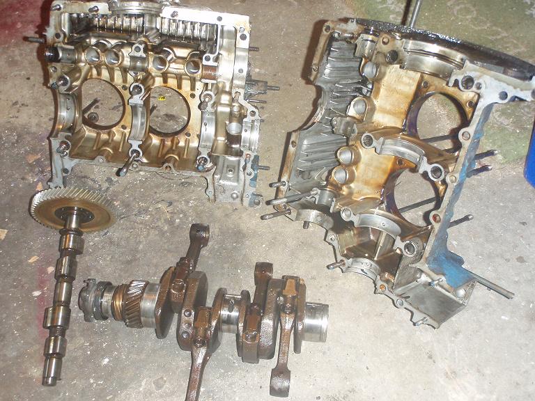

I'll assume you know something about engines and show you the big difference.
Had to steal a pic of the T-4 off the forum.
