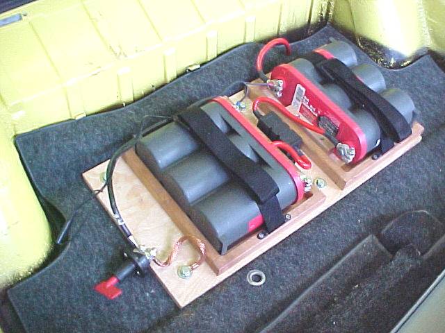

Korijo
I plan on bite'n this style, 2 6V
IPB Image
IPB Image
