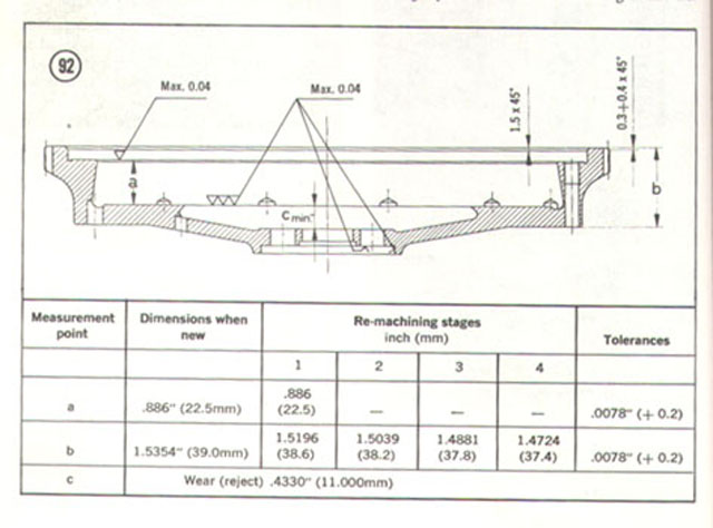

SLITS
Siince the /6 and /4 are the same clutch, the following diagram should give you the limits even though it is a /6 - 901 Flywheel. Apparently, it has worked for others over the years.
IPB Image

JFJ914
QUOTE(SLITS @ Jun 26 2012, 11:12 AM) *
IPB Image
The "C" dimension wear limit of 11mm does not work for a 4 cyl flywheel . I just measured my brand new (OE German) 4cyl flywheel and came up with a"C" dimension of 9mm uncut. This is 2mm shallower than a -6 flywheels' wear limit of 11mm. When you cut the 4 flywheel that 9mm dimension gets even shallower. I have been told that you can cut the wear surface even with the top of the 3 vent holes on the inside of the wear surface. Don't forget to maintain that "A"dimension differential of 22.5 mm.
rjames
I tried long and hard to find this info but never did. But it is something less than 9mm as that's the measure when new. I ended up biting the bullet and buying a new flywheel to play it safe. Nice to know that the new one will most likely outlast the life of the car.
If you use yours, make sure that the top of the bolts don't sit above the surface. You don't want them making contact with the clutch disk. I think that's the main concern since you could adjust the clutch for a change of 1mm.
wingnut86
That's the diagram I was provided and have used it twice. You "can" take it thinner, and if the bolts aren't flush you can grind them down or replace with suitable grade of allen head or similar.
Warning: if you shave the heads, be prepared to thin the sidewalls of a socket for the next removal or grind down an appropriate angled open end wrench. Keep in mind that torqeing going in is different and you need a helluva lot more PB Blaster coming back out.
