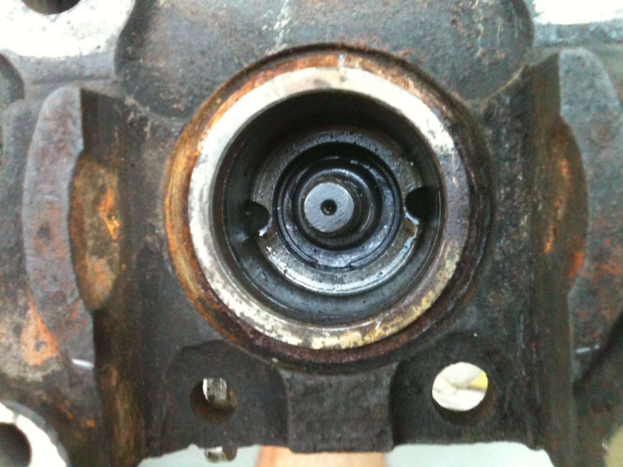

I took Valy's advice from my first thread and tore into these calipers.
I now completely agree that rebuilding the calipers is vital, and I'm going to do a complete job of it... but:
i have used every tool i have, and made one. i STILL can't get this clip out:
PMB pic
here's mine:
unlike the images i've seen on pmb and others, i don't have the pilot holes, just the edge is showing.
anyone have a method to remove this puppy?
Nicky
I used really pointy picks to work it out. Mine were the same, no holes, and it was a pain. Stabbed into it a little and moved it while working another pick behind it. I think the ends are cut at an angle to get behind them as well. Hold out one end behind the cut, and slide a pick around the ring behind it to push it out of the slot.
lotus_65
yep, that sounds like it. i'll keep digging, and maybe make a new sturdier tool! thanks

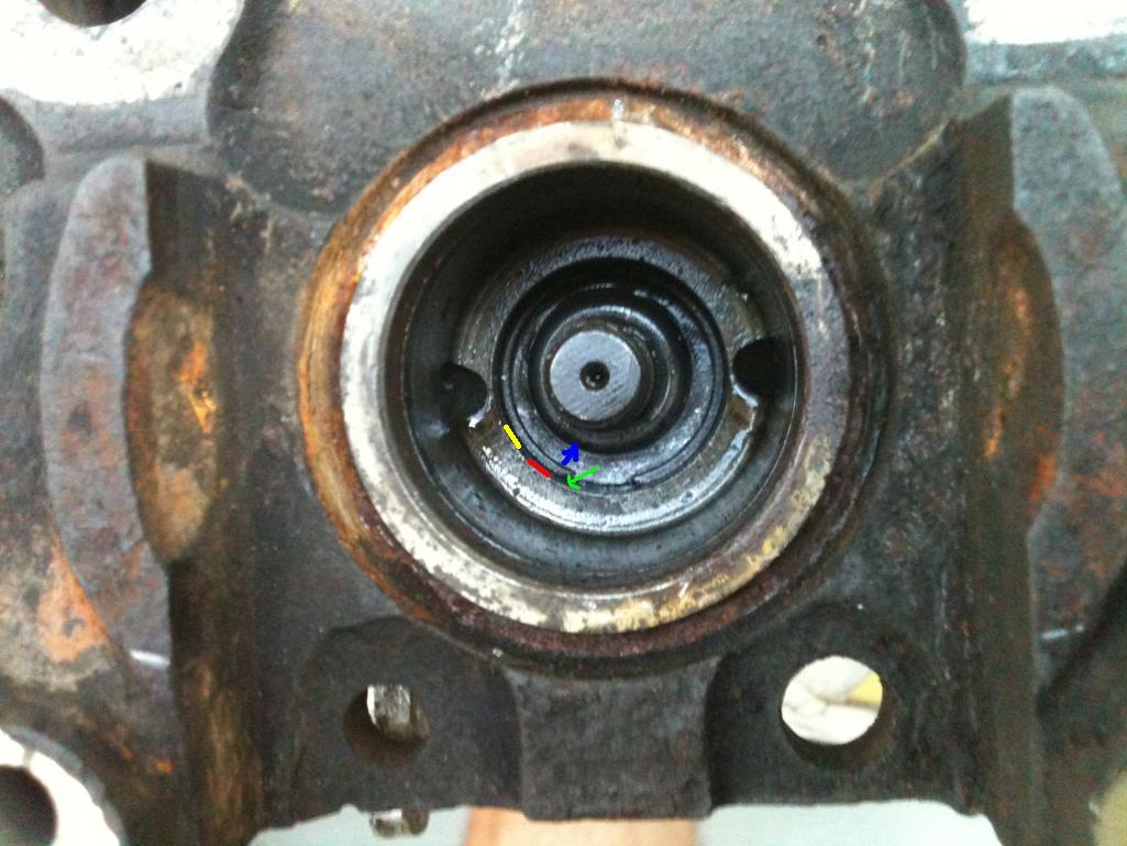

I had a hard time getting mine back together using a socket to compress the spring and hat to get the clip back in. I had to replace two damaged caliper pistons, so I ended up taking the threaded part out of a bad piston, and threaded it on to hold the hat and spring down while I put the clip in. Less in your way to get the clip on, then just unthread once the clips back in. Worked awesome.
Jeff
Eric_Shea
Those came on 75 and 76 cars.
Two tools needed:
1. Dental pick with an angled end
2. Very small screw driver
First - Have the very small screwdriver in place and ready for action. That place is just behind the clip head and against the bore wall.
Second - Use the angled pick under that 45 degree angle in the clip head. It helps here to have a very sharp pick. Pull "inward" (toward the center of the caliper) on the clip head and then stick the small screwdriver behind the clip as it comes out of the journal. This will be very close to the clip head to get it to work.
Third - Shimy or slide the screwdriver down the clip a bit to get more of it out of the journal. Keep firm downward pressure on it so the clip doesn't snap back.
Fourth - Again, keep FIRM pressure on the screwdriver so the clip cannot go back into the journal. Use the angled pick to get under the head of the clip. At this point I Bend and twist the crap out of it so there's no chance of ever using them again. I have plenty or good ones and I hate those things.
Eric_Shea
Here's some fancy colors for you:
Red = Where you position your screwdriver.
Green = Put the point of the clip in here.
Blue = Pry in that direction.
Yellow = Shimmy the screwdriver down at least that far and then go to town on the clip.
