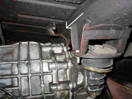

How do your grounds look? Especially where your negative battery cable attaches to the body and the ground strap at the transmission to body?
Shoddy grounds = poor cranking.

Rusty
I don't have a picture handy. The factory ground strap was a braided strap that went from a nut on the rear transmission cover to a stud on the body.
If you get under the car and start looking there, you should see it. You probably had to disconnect it to drop the engine/transmission combo. If you didn't disconnect it, it likely broke under the weight of dropping the engine/xmsn.
When you check both the battery ground cable and the xmsn ground strap, make sure both ends are clean and the surfaces they are connected to are clean and shiny. Some electrical grease would be good preventative maintenance.
Rusty
Found a pic, posted by Jeffs9146 last year.
IPB Image

QUOTE(dfelz @ Jan 13 2013, 10:54 PM) *
When the clutch was in the revs climbed really high, sounded like something was wrong internally, but when i released the clutch it idled fine, then i killed the engine to jump around with joy!! piratenanner.gif
Sounds like your clutch and accelerator cables are tangled up in your tunnel. But if your planning to drop your motor again, I wouldn't worry about it too much at this point.
