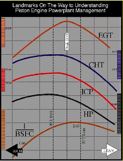

72hardtop
The following chart shows CHT, EGT etc...and relation to stoic 14.7Click to view attachment
