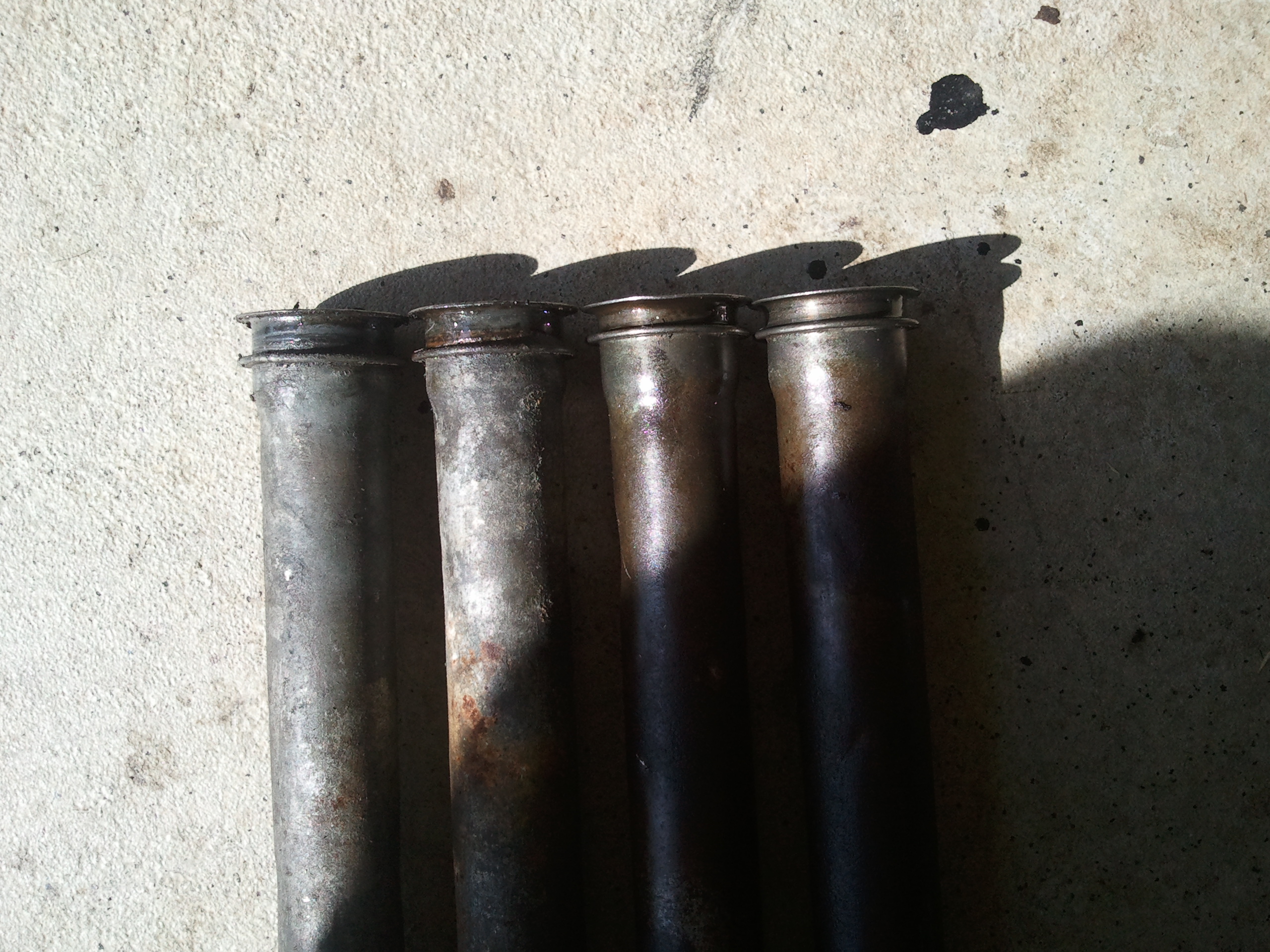

QUESTION #1: Look at the picture below. Notice the tubes on the right have a shorter distance where the seals go than do the tubes on the left. Which tubes should I use or does it even make a difference? The reason I ask is because 4-5 of the tubes were leaking at that end. Not sure if the seals were bad (were brand new when I installed them a few months ago.) or if the smaller area played a part by not letting the seal move and do its job confused24.gif

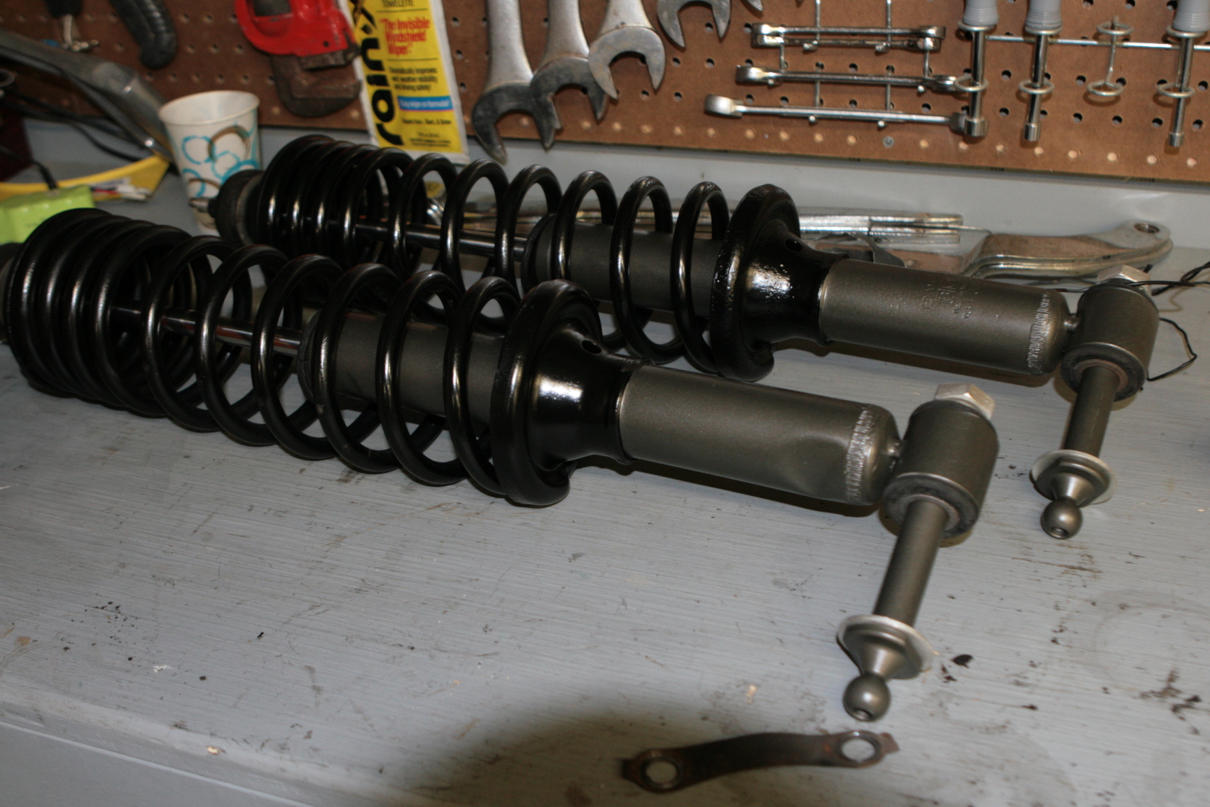

QUESTION #2: I am installing a set of 140# Weltmeister springs and one end of them has a tighter coil. Does this end go up or down? Found a couple pics online but of course one had it up and one had it down dry.gif

TheCabinetmaker
Steve, I don't think the pushed tubes should be an issue. More than likely the seals were of the non viton material. Be sure to lube them and install the tubes with a twisting motion. They cut easily.
poorsche914
Thanks, Curt. I was thinking it was probably the seals rather than the tubes. Will replace with correct viton type.

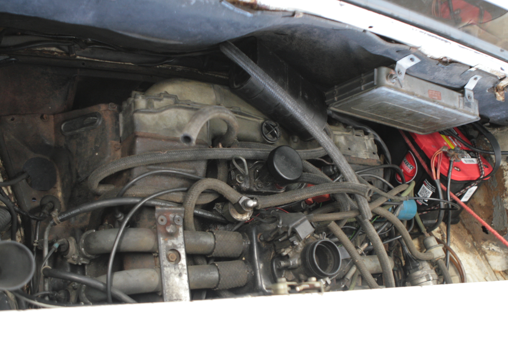

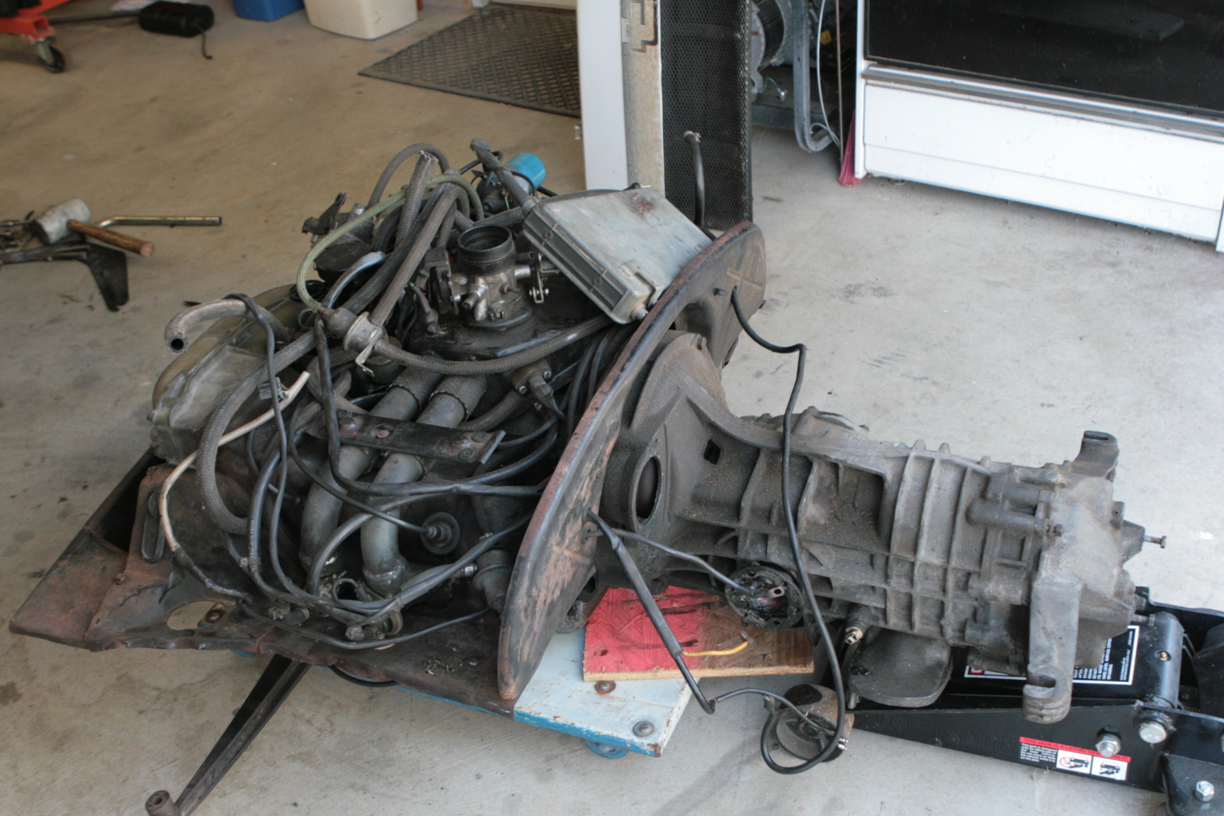

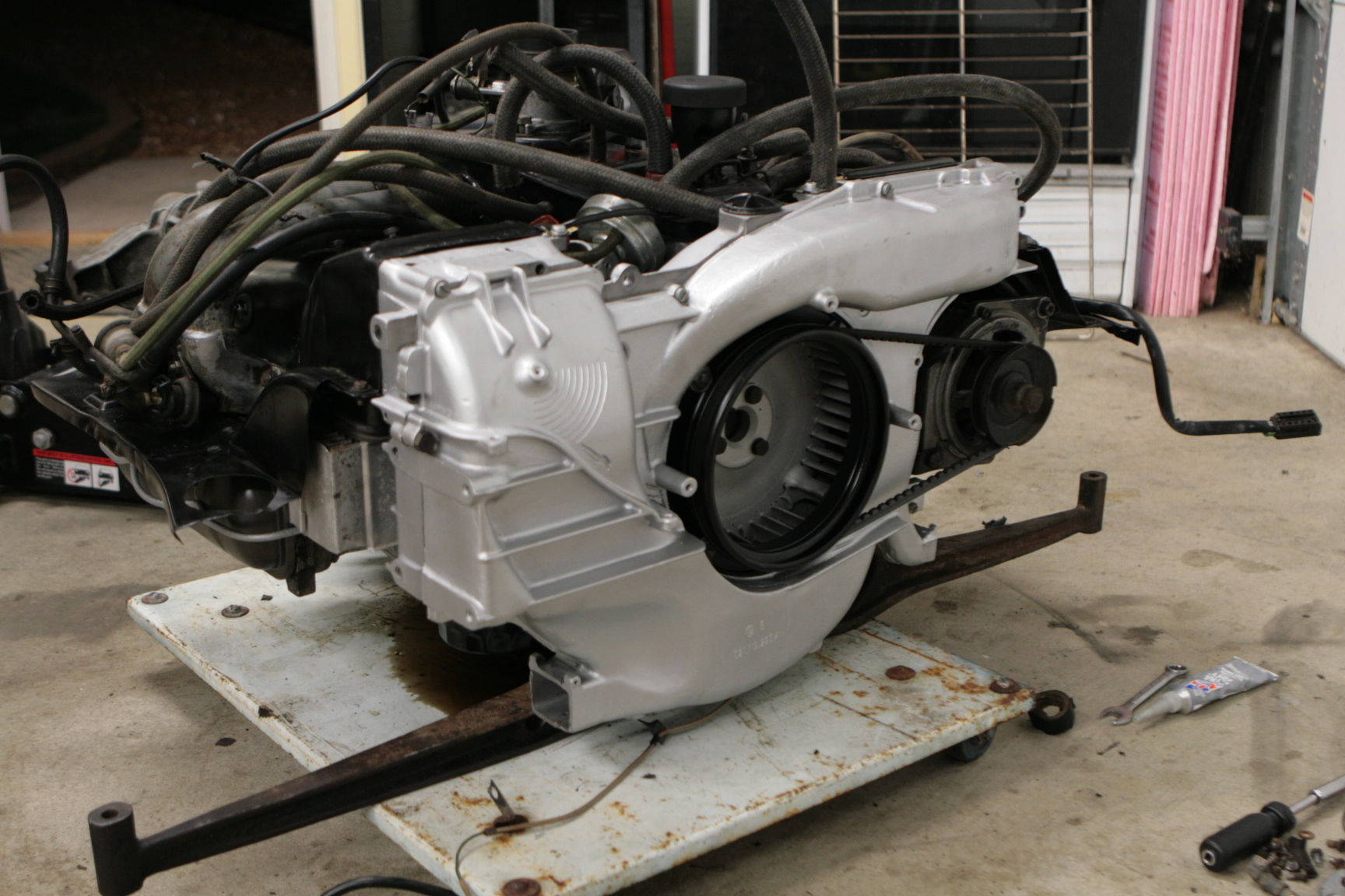

Engine out!
Minus tin

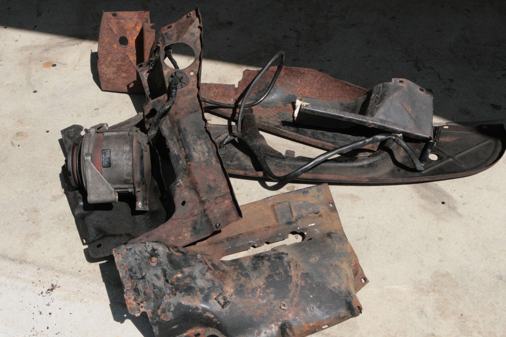

Pile o' Tin

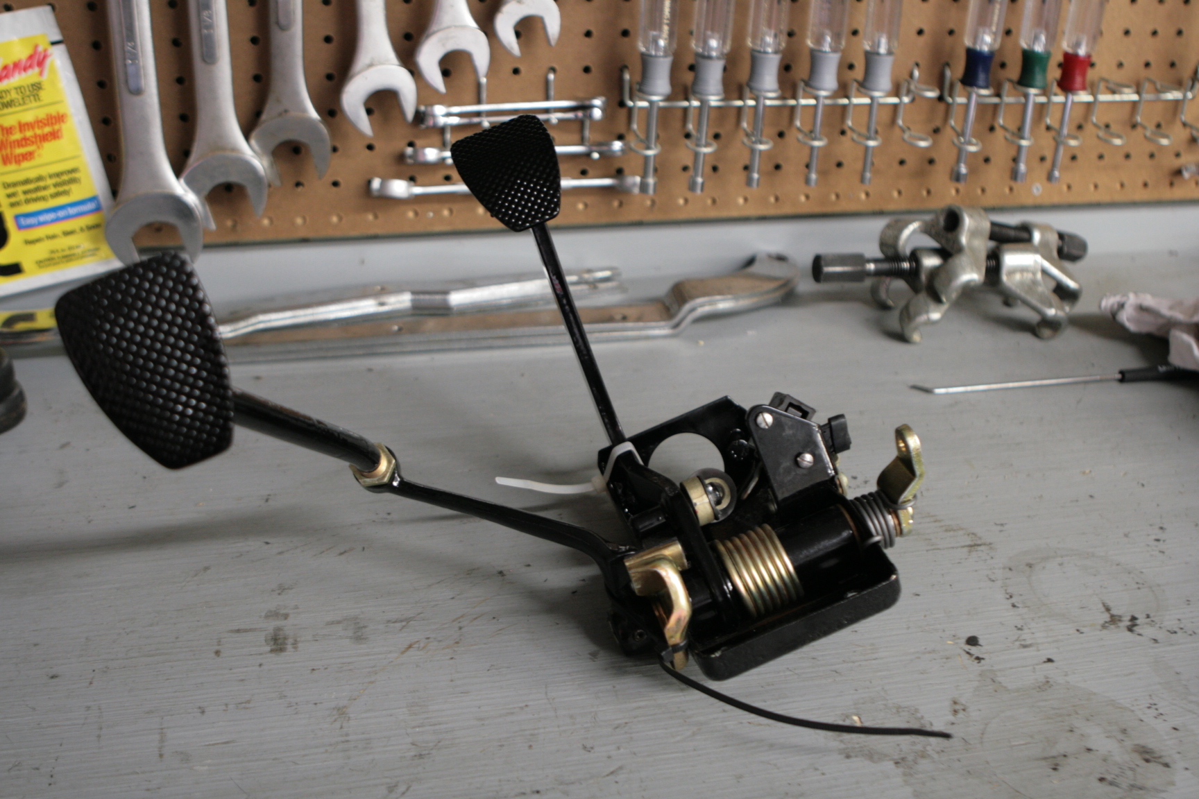

Pedal cluster from bdstone

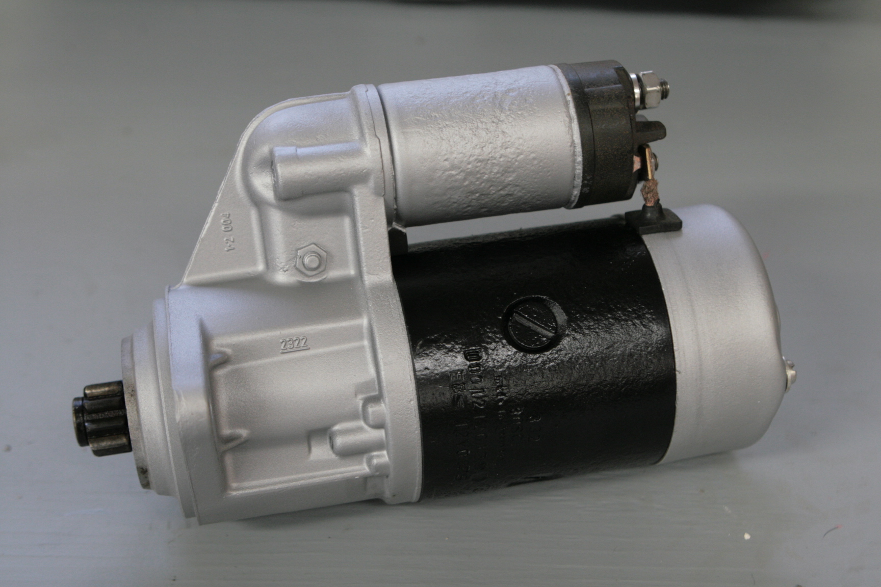

Starter

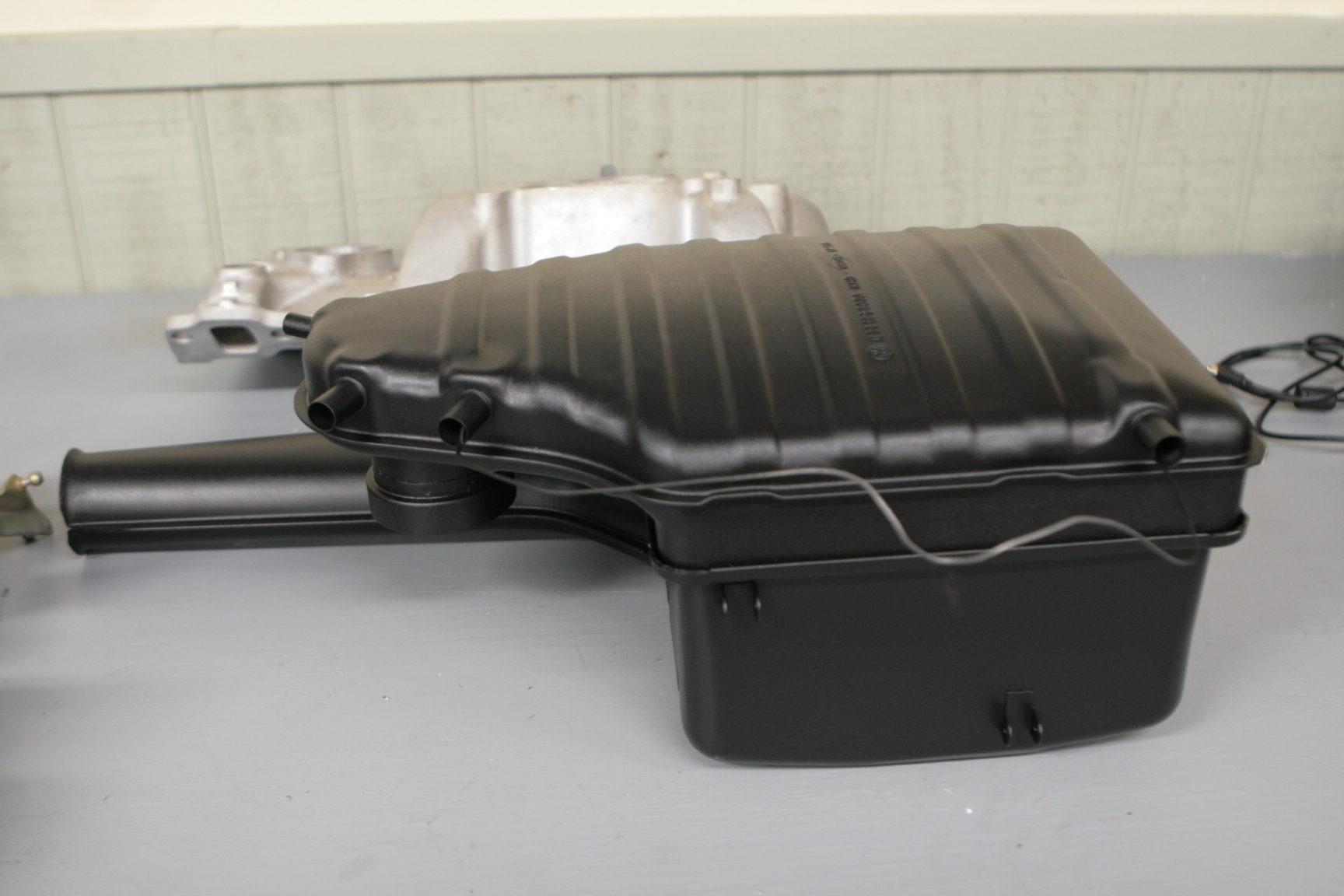

Air box

Looking good! As far as the springs go, It shouldn't matter, since the looser part of the coil will compress first regardless of orientation, maybe tight part towards the top so it looks more stock? Looking forward to seeing more progress!
-Ross
poorsche914
Thanks, Ross. We ended up putting the tighter coils at the top.

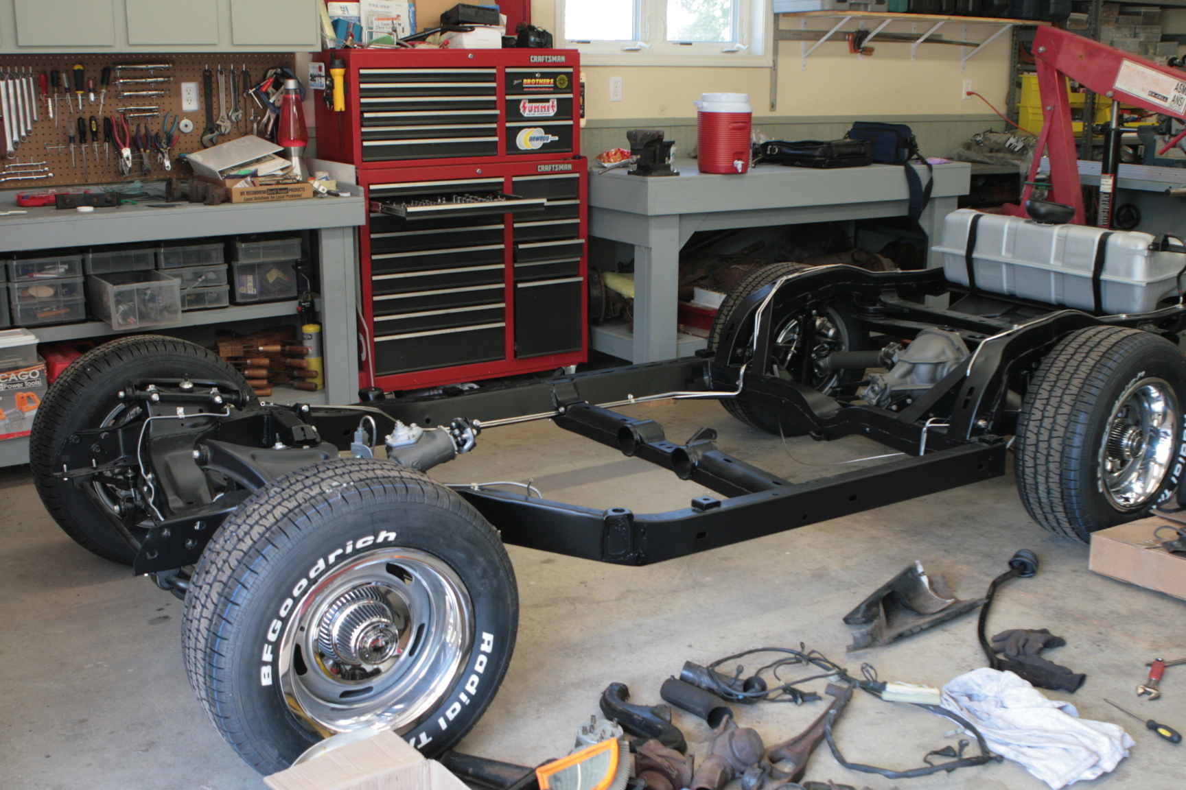

rnellums
Independent rear suspension?
87m491
QUOTE(poorsche914 @ Aug 24 2012, 09:24 AM) *
Sure looks Corvette to me...
poorsche914
QUOTE(87m491 @ Aug 24 2012, 02:41 PM) *
You are correct... 1973 Corvette chassis.

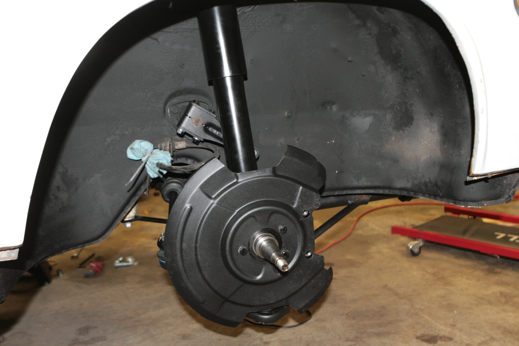

Day 2: rear shocks and springs reconditioned and ready to be installed. Front suspension apart and blasted. Will paint or powder coat all the parts early tomorrow and install later in the day.

Rear shocks with 140# springs
Front suspension with new bushings and 21mm torsion bars.

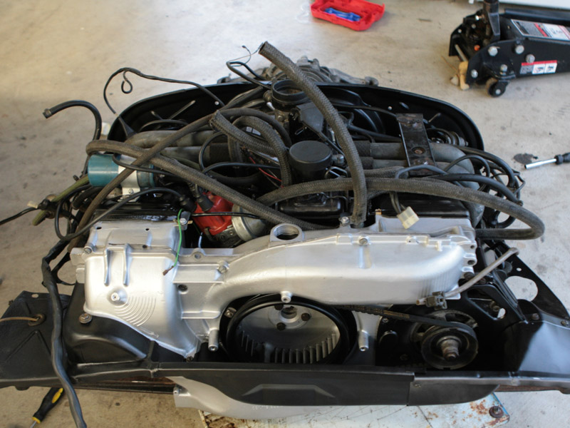

Engine cleaned up and just about ready to install

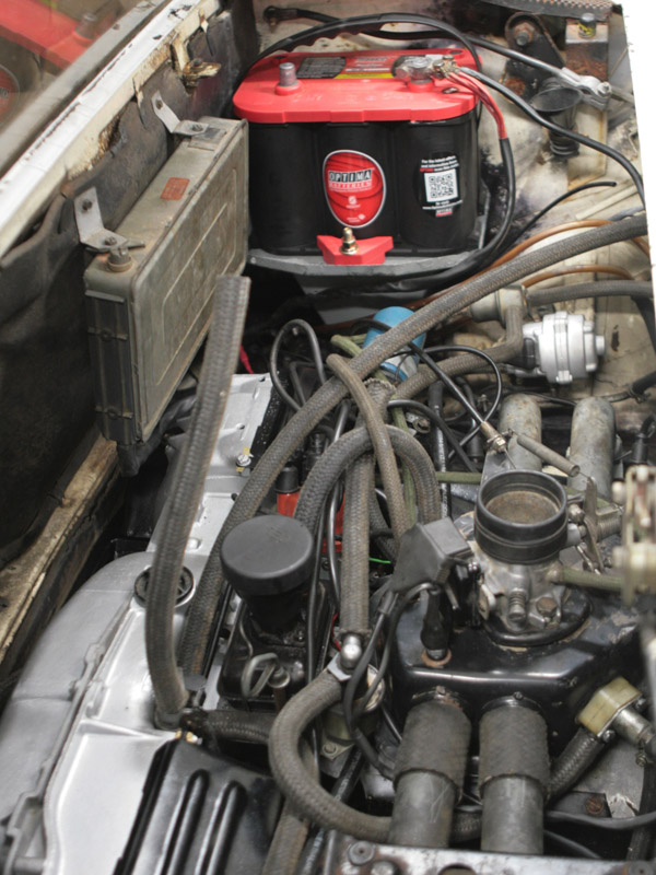

Cleaned up engine
Engine bay - now with battery properly held down to battery tray

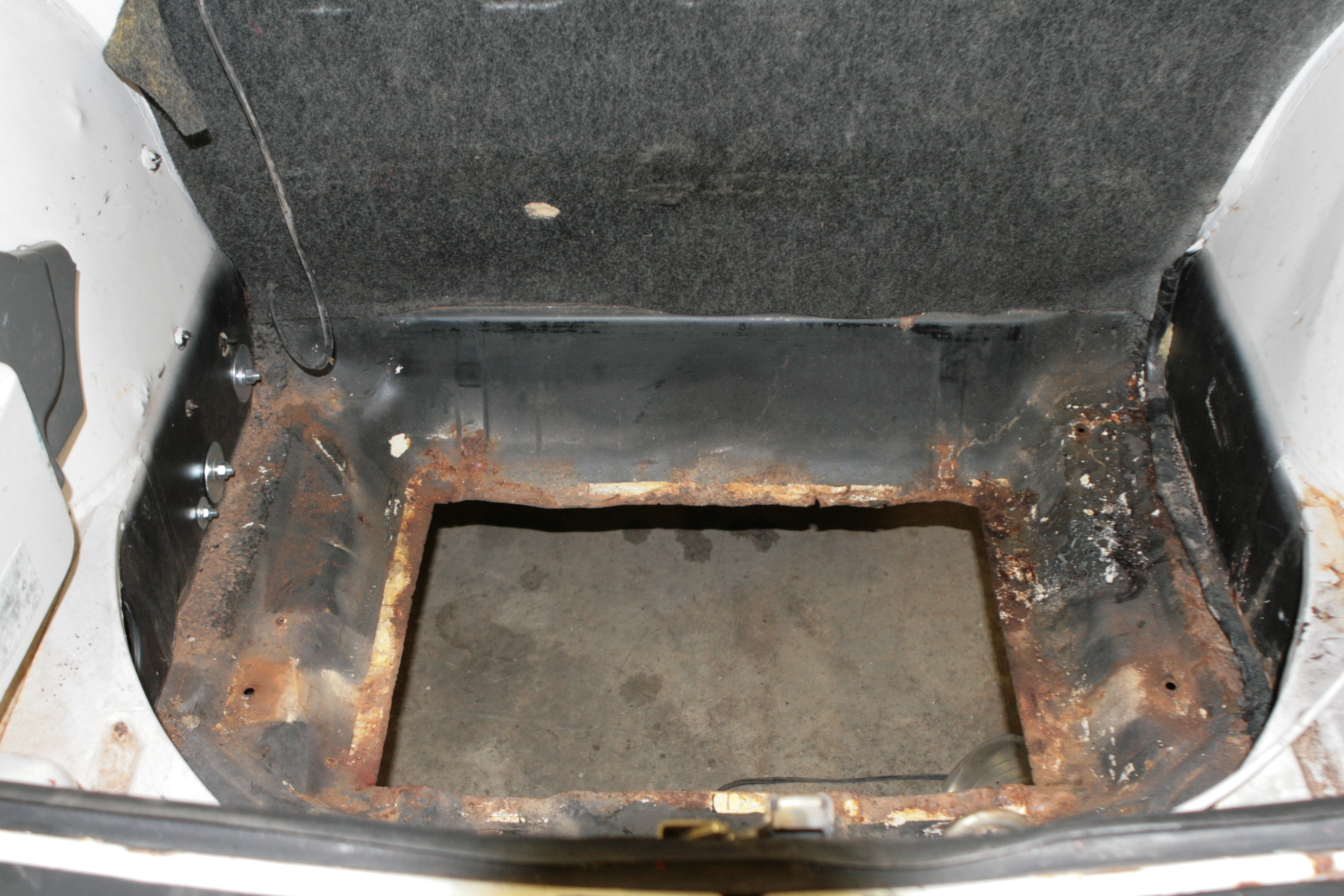

Day 4: remaining engine tin blasted, painted and installed, engine back in, front brakes installed (at which time we realized the right caliper had a frozen cylinder), pedal area got some rust repair including removing rusted/broken mounting studs for pedal box and accel. pedal, seat mount hinge and height adjustment "comb" mount repaired, rear shocks installed. Worked til well after midnight. 914 back on the ground but front height needs adjusted and engine not yet tuned.
