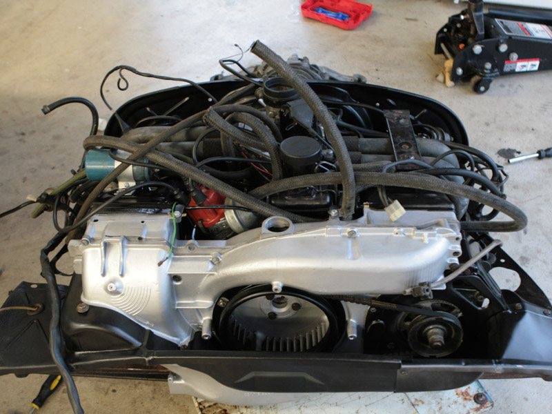

Since purchasing my LE in the spring of 2010, I have slowly restored/replaced/upgraded items as time and money allowed. Yesterday, I drove 600+ miles to central Illinois to visit my cousin for a few days of marathon wrenching and reconditioning. I arrived around 5:30 local time and after going over "the plan", started cleaning and blasting some miscellaneous parts.

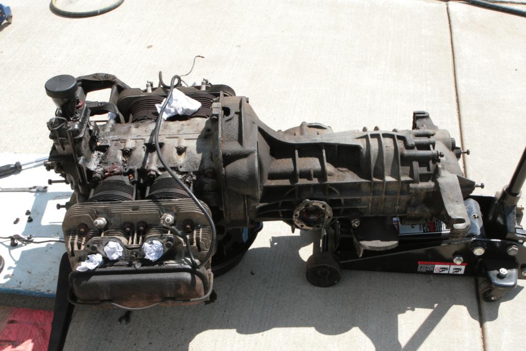

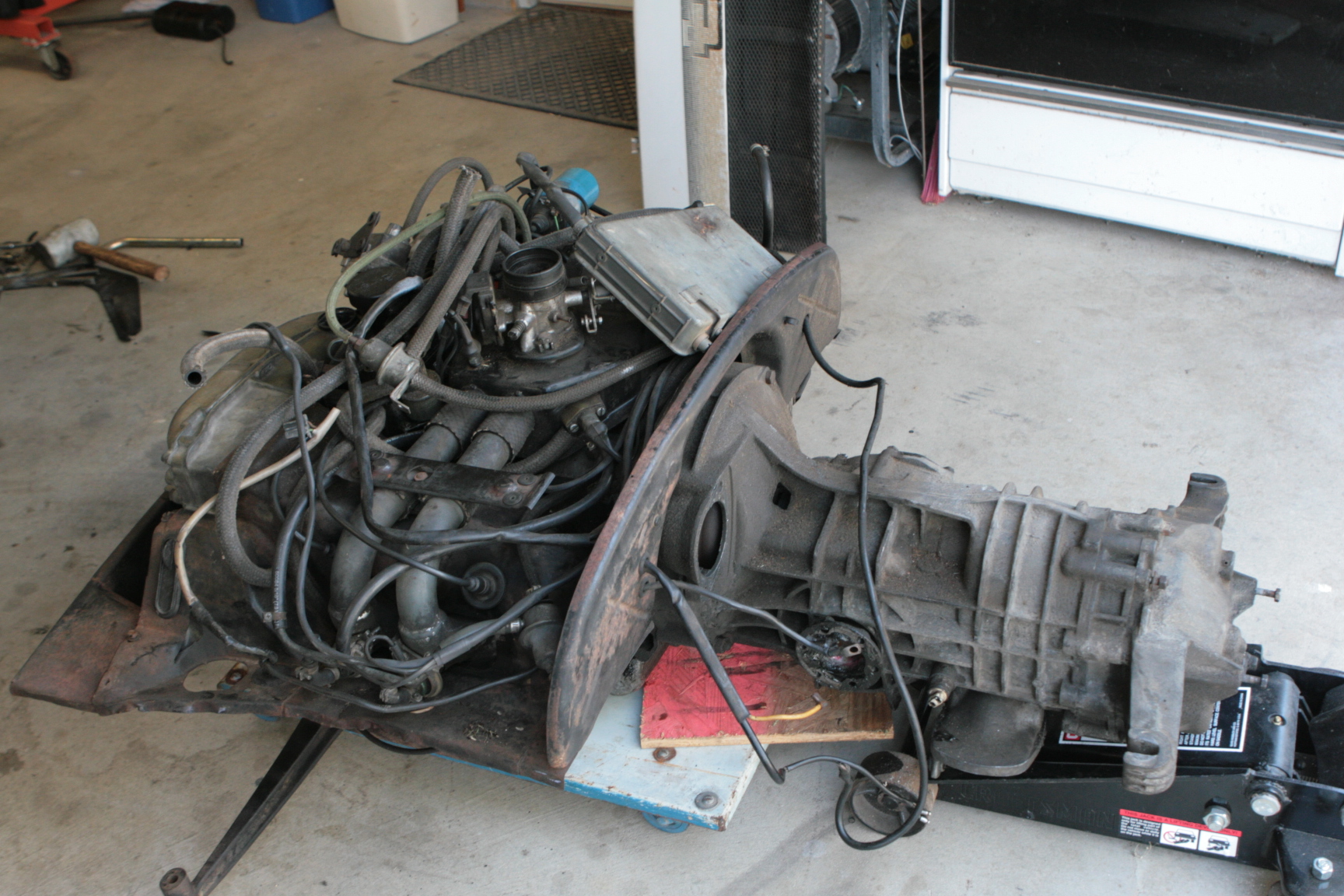

Today my cousin has redone the starter, rear shocks, and springs. We also dropped the drivetrain and I stripped the FI system and engine tin. Had major leaks from the push rod tube seals so have cleaned the engine of oil & dirt. Will be dropping the front suspension for reconditioning along with turbo tie rods and 21mm torsion bars. Also planned is some rust cleanup in the cockpit area along with a bdstone reconditioned pedal cluster (thanks, Bruce. Package arrived today!) and a battery tray installed and some engine bay cleanup.

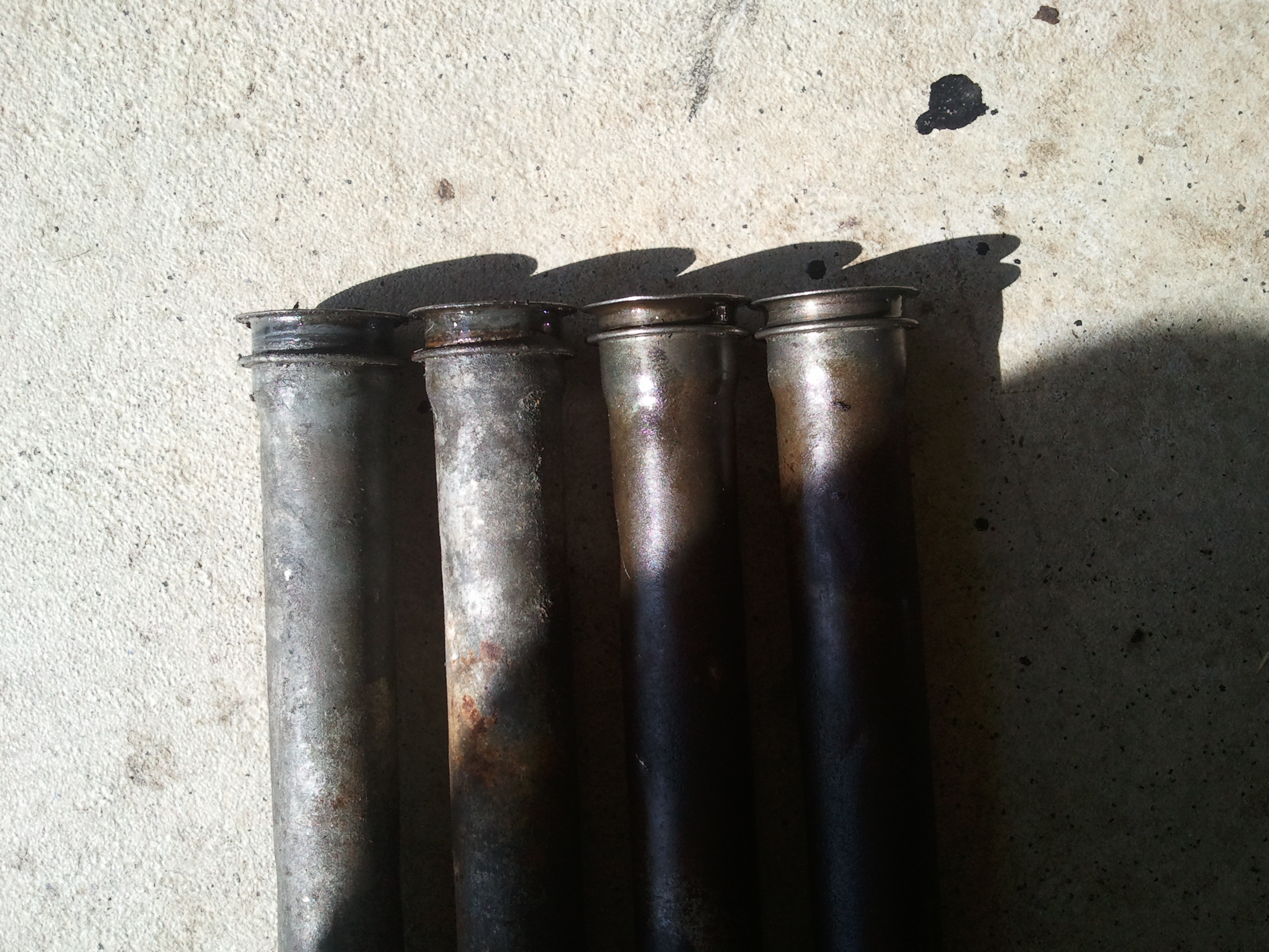

QUESTION #1: Look at the picture below. Notice the tubes on the right have a shorter distance where the seals go than do the tubes on the left. Which tubes should I use or does it even make a difference? The reason I ask is because 4-5 of the tubes were leaking at that end. Not sure if the seals were bad (were brand new when I installed them a few months ago.) or if the smaller area played a part by not letting the seal move and do its job (IMG:style_emoticons/default/confused24.gif)

Steve, I don't think the pushed tubes should be an issue. More than likely the seals were of the non viton material. Be sure to lube them and install the tubes with a twisting motion. They cut easily.

Thanks, Curt. I was thinking it was probably the seals rather than the tubes. Will replace with correct viton type.

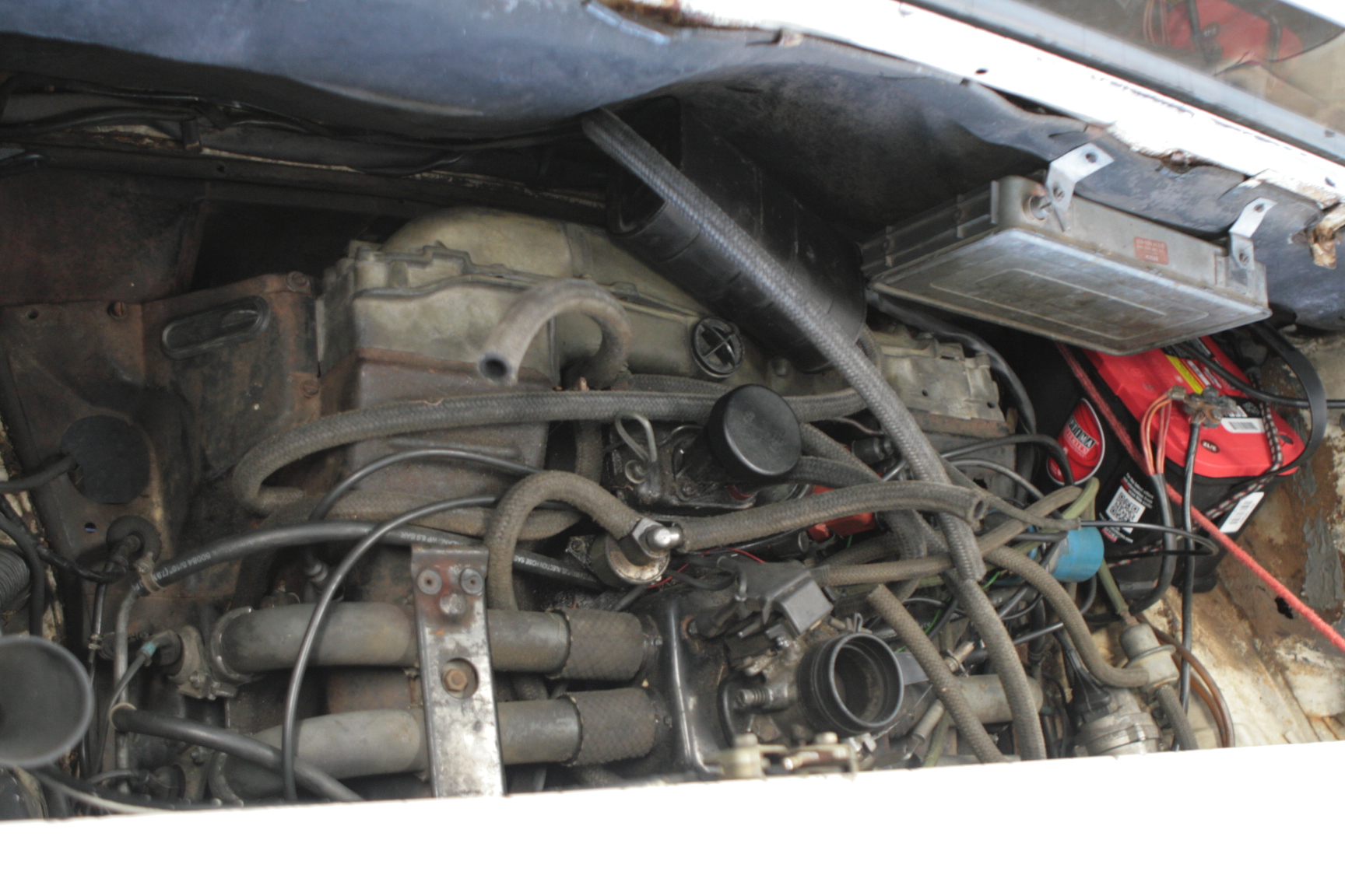

Engine bay (IMG:style_emoticons/default/barf.gif)

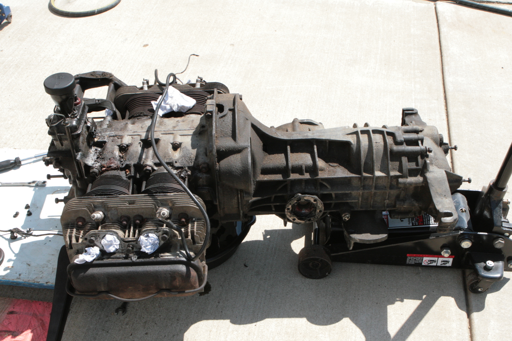

Engine out!

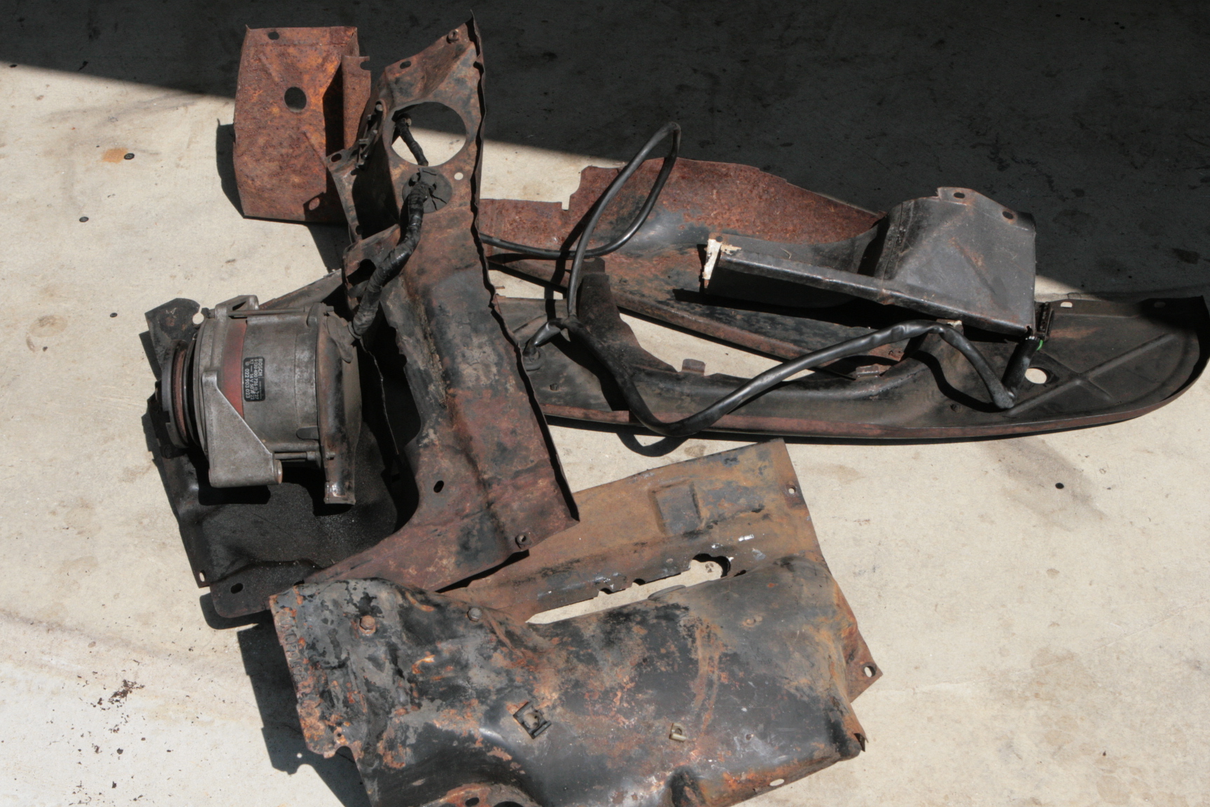

Minus tin
Pile o' Tin

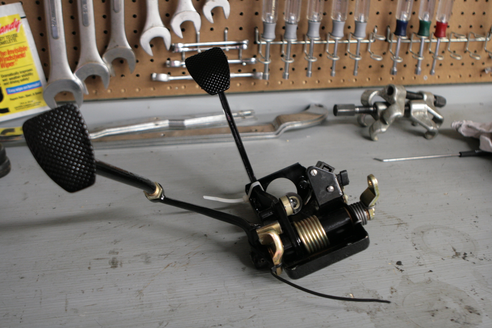

Pedal cluster from bdstone

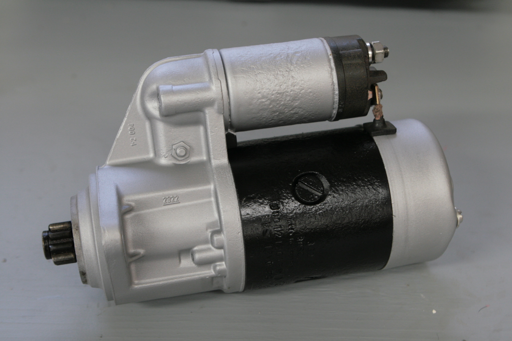

Starter

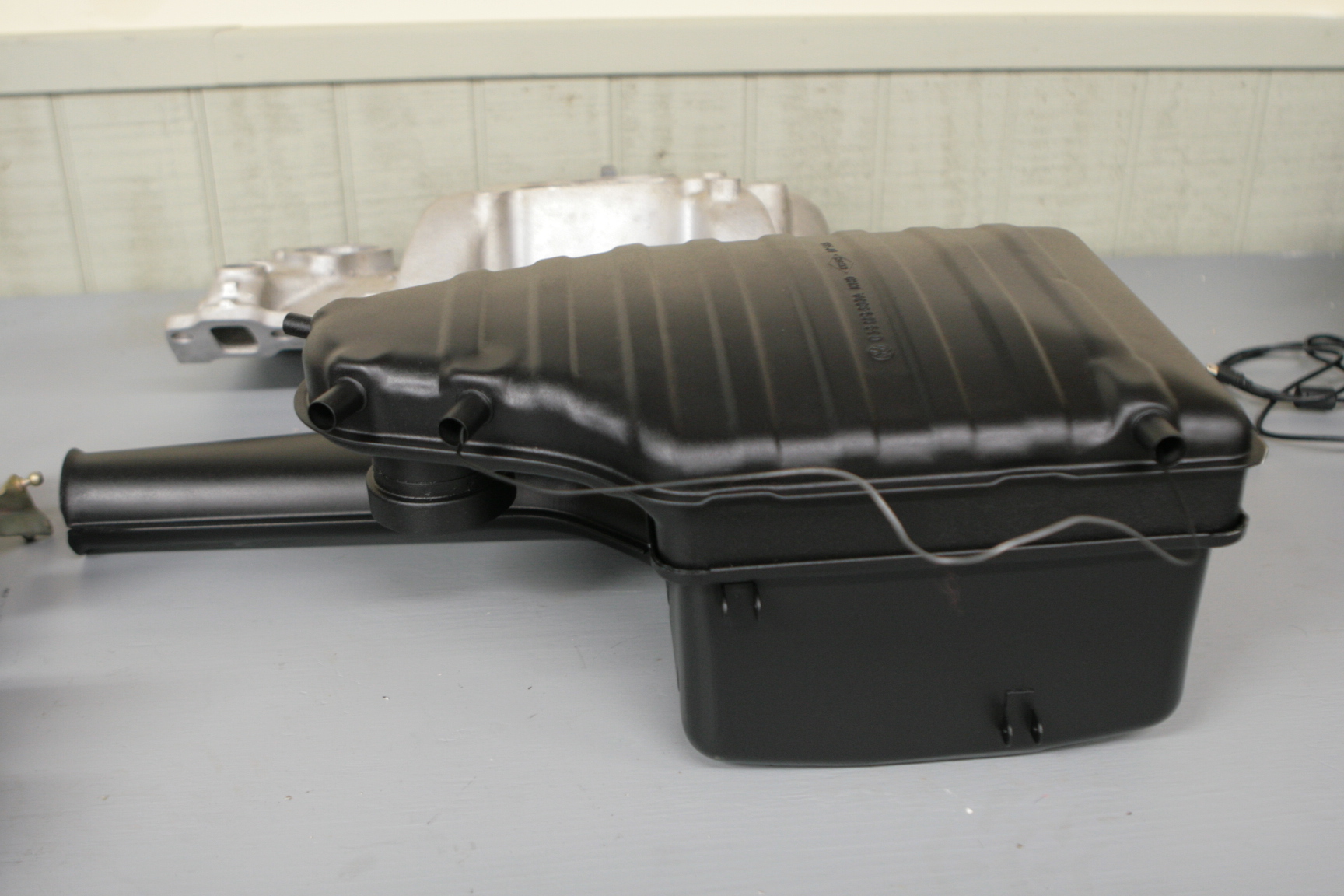

Air box

Visited Brad Mayeur and got a few needed items as well as some advice on how to move forward with disassembling the front suspension. My cousin is working on the front suspension while I install the cleaned up push rod tubes and then clean the engine to get it ready for the freshly painted tin. Things are moving along pretty much as planned. (IMG:style_emoticons/default/smile.gif)

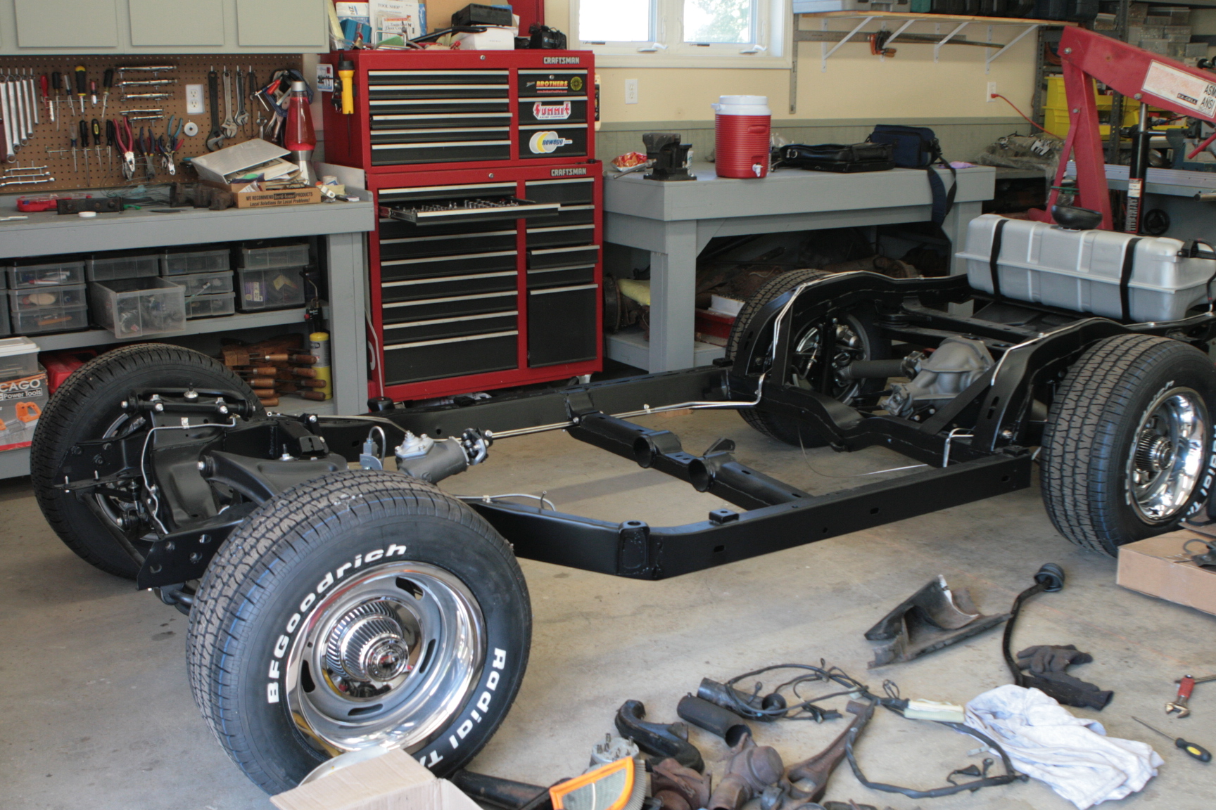

Here is a shot of one of his projects. Guess the vehicle (IMG:style_emoticons/default/idea.gif)

QUOTE(poorsche914 @ Aug 24 2012, 09:24 AM) *
Sure looks Corvette to me...
poorsche914
post Aug 24 2012, 02:11 PM
9fourteen
Posts: 3,163
Joined: 28-May 09
From: Smoky Mountains
Member No.: 10,419
QUOTE(87m491 @ Aug 24 2012, 02:41 PM) *
You are correct... 1973 Corvette chassis.

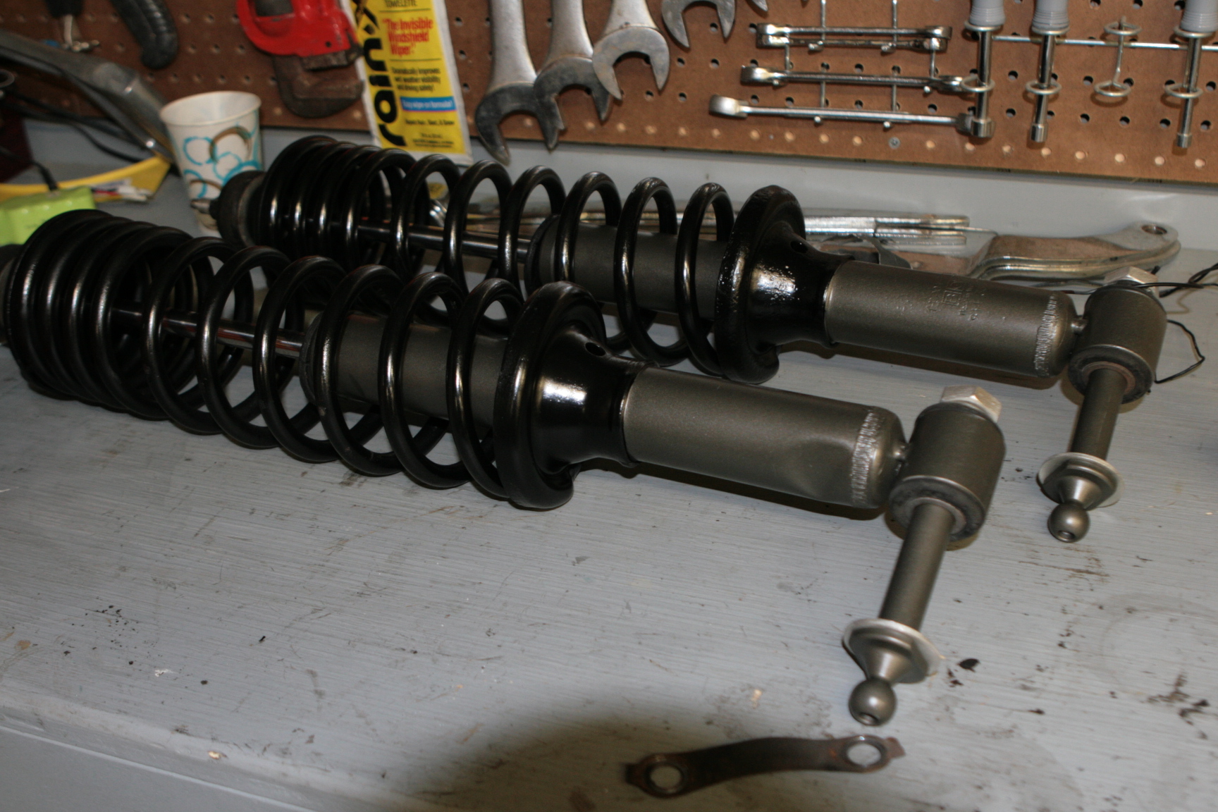

Day 2: rear shocks and springs reconditioned and ready to be installed. Front suspension apart and blasted. Will paint or powder coat all the parts early tomorrow and install later in the day.

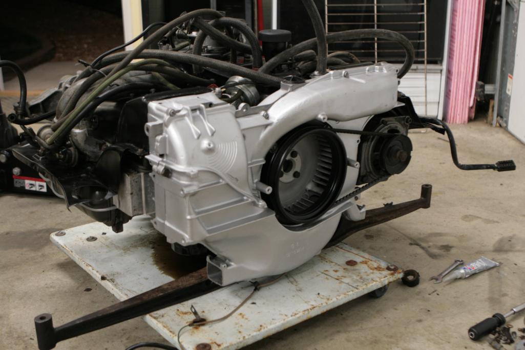

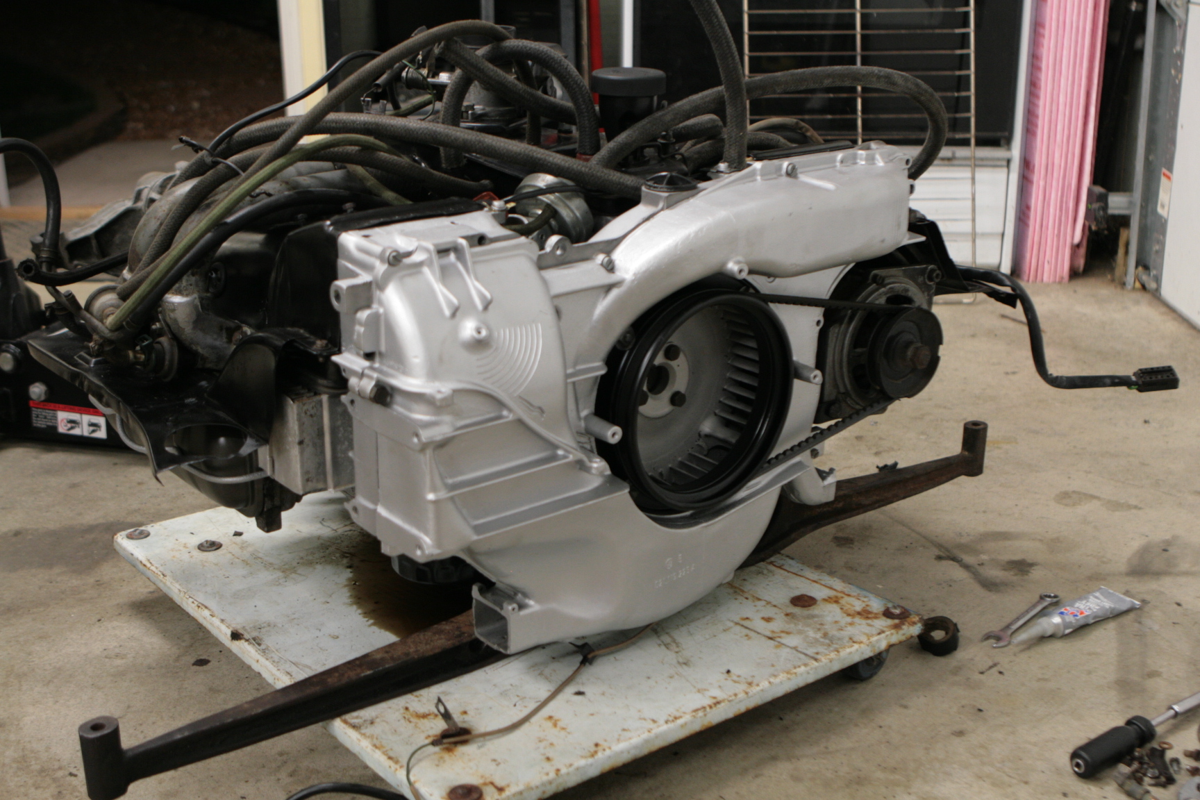

Fan shroud cleaned and painted and back on the engine. Will finish blasting engine tin tomorrow and then paint and install.

DAY 3:
Rear shocks with 140# springs

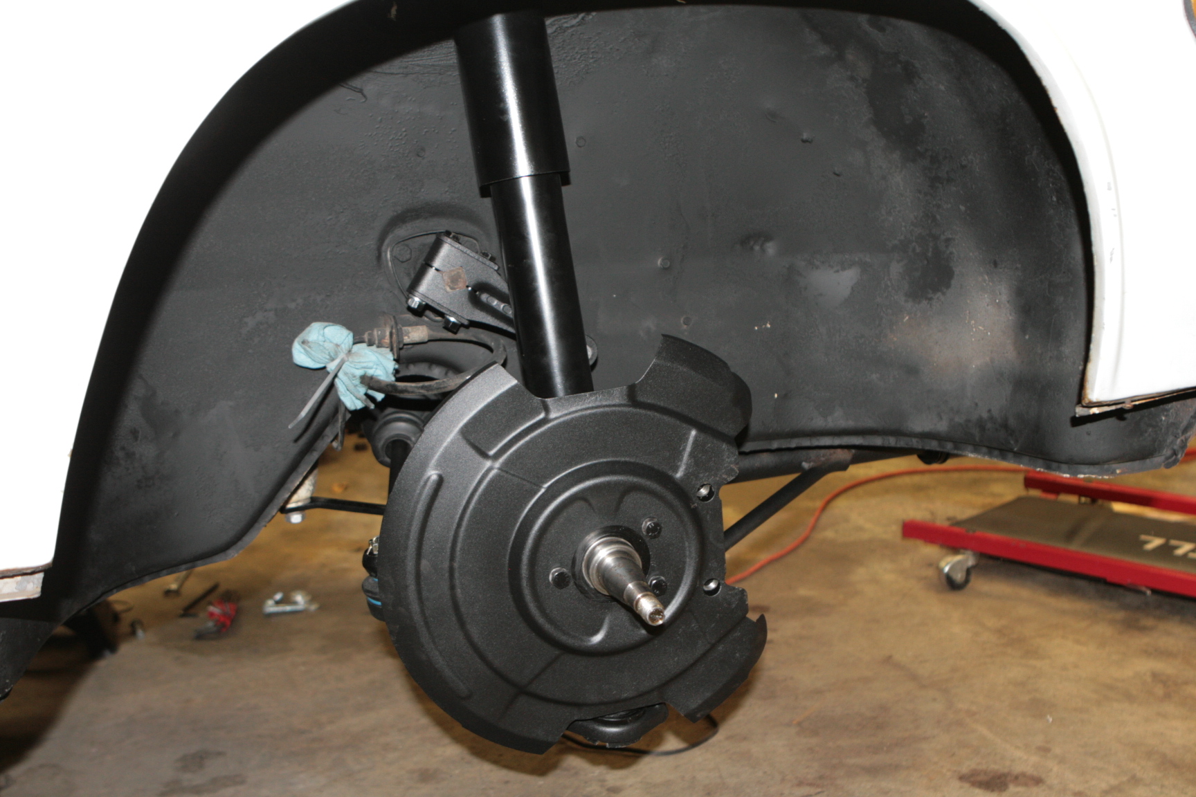

Front suspension with new bushings and 21mm torsion bars.
Engine cleaned up and just about ready to install

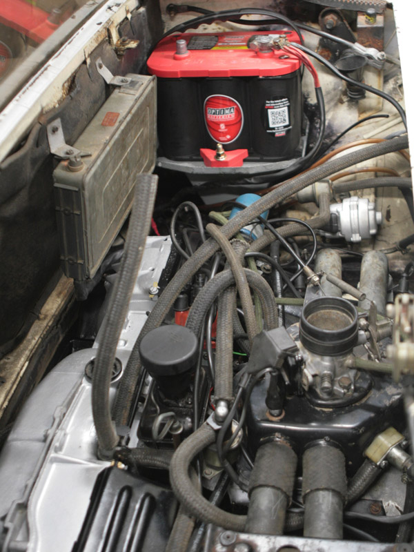

Cleaned up engine
Engine bay - now with battery properly held down to battery tray
