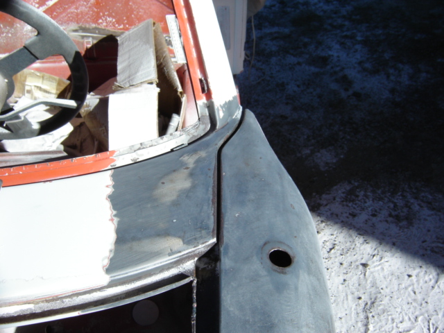

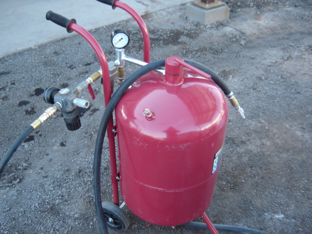

OK,so I went to HF and R2 came home with me! Then went to the eastwood site and looked at their soda swap kit. Then went and got the parts and built the changover kti.( cheep ass!) 100 Lbs. later this is what I have. Took about 2 hours+-.
IPB Image
IPB Image
IPB Image
IPB Image

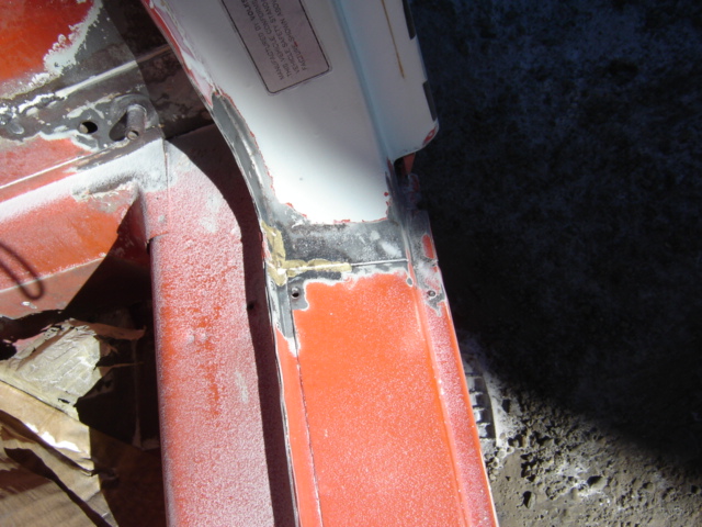

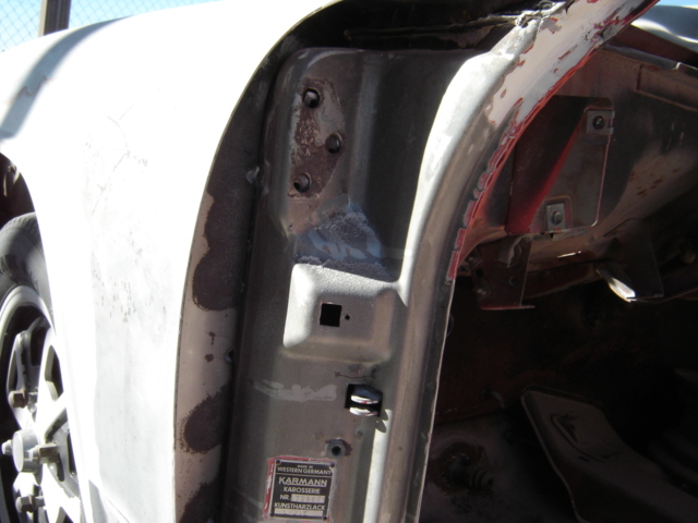

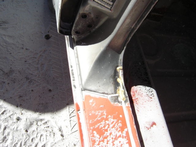

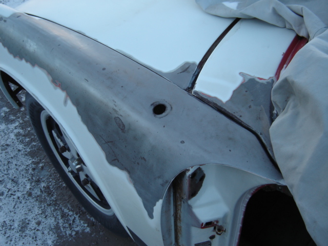

Not sure if this is good or bad? No rust under the paint?
IPB Image
IPB Image

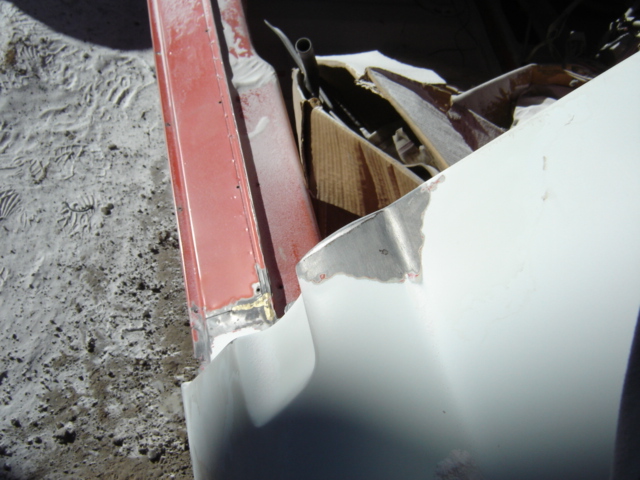

The soda is very easy to work with! Lots of mess but that is ok. Need to try and reclame some of the soda.With this tool I will be able to go at my pase. I didn't strip all the fender because I am installing the GT flairs. Who makes them at a fair price?

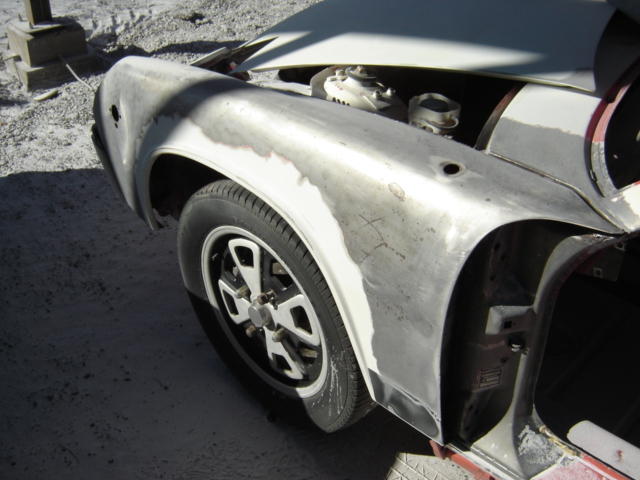

Something funny. The front coner that was repaired/replaced was the same color as the car!
cary
Looks nice. Good work ....................
