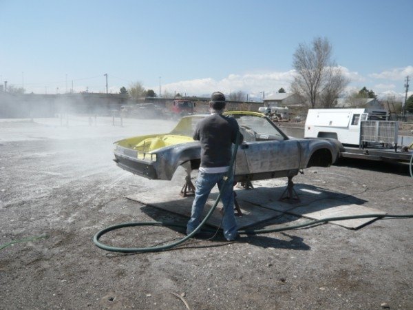

HI Guys I have some questions I have been trying to figure out and have done some search but really didn't get what I was looking for. Car is a 1971 1.7L
1) Is it possible to sand (bead) blast the car without having to pull the whole wiring harness? My thought is I could remove all the wiring retainers and loom and tape all the wiring up and the main fuse box,relays, and main mass of wiring just put in a small tupperwear box to protect it. Anyone ever try this, I just think it could save weeks to months for me.

my opinion is - do it once and do it right. you'll need a rotissire.
1- strip car completely.
http://www.914world.com/bbs2/index.php?sho...c=59552&hl=http://www.914world.com/bbs2/index.php?sho...p;hl=soda+blast2- blast, etch prime, fix rust, etch prime repaired spots, bondo, paint - something like that? if going with radiator, make all cuts before etch priming.

1- yes it can be done. You'll need to wrap the entire harness in heavy tinfoil. It's a pain to work aroud, but can be done.
