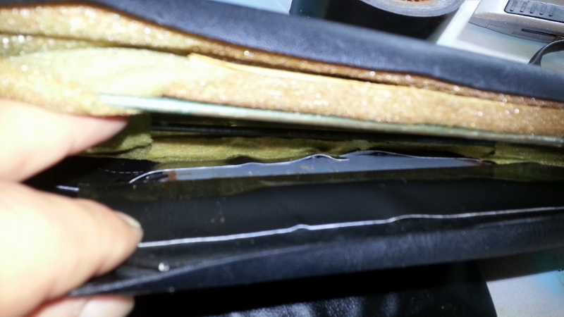

To open the visors, the least visible incision would be the seam along the top of the visor. So with a utility knife (with a fresh razor blade), I cut the seam open along the length of the top of the visor.

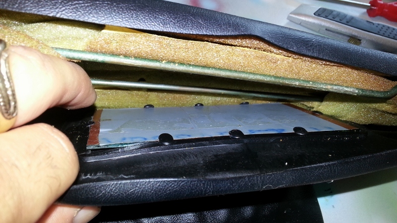

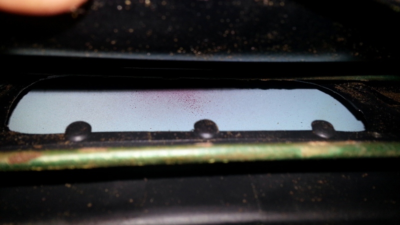

After opening the visor, you can see the mirror secured in the mirror housing with 8 surrounding plastic tabs holding the mirror in place. To remove mirror, CAREFULLY bend visor and tabs so tabs lift up over the mirror. It's always better to hold the mirror from the edges, as if you hold it from the middle it is more likely to break.

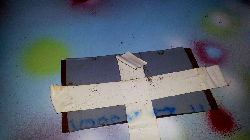

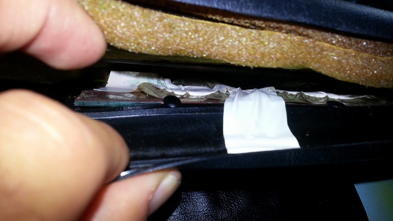

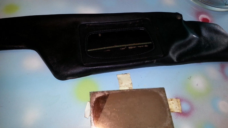

Below is the removed mirror. Tape on the back of it was used to help secure the mirror in place along with the plastic tabs. Remove the tape as bits of foam are likely to get stuck to it and make it unusable again.
Visor with removed mirror.

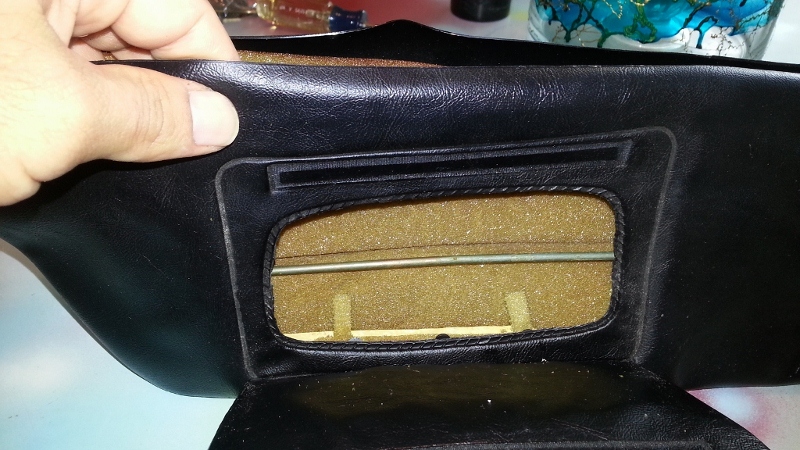

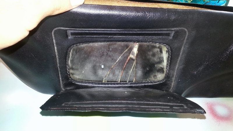

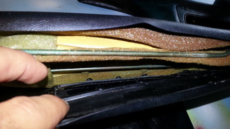

Now after making same incision on the good visor, opening to reveal broken mirror and good foam inside.

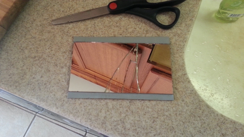

Broken mirror on good visor.
Bending visor back away from mirror edges to remove mirror from securing tabs.
Good visor with good foam, mirror removed.

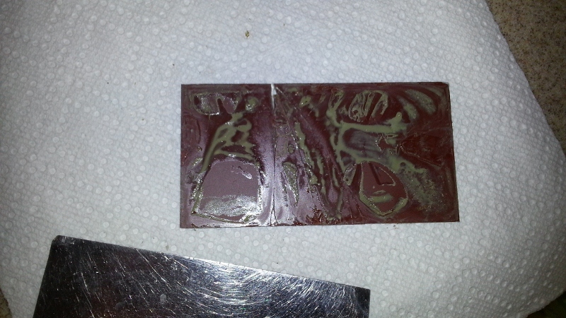

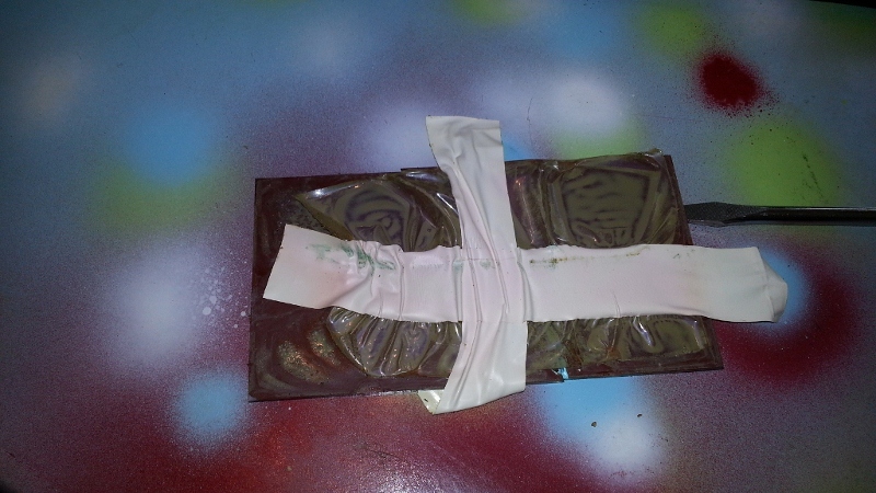

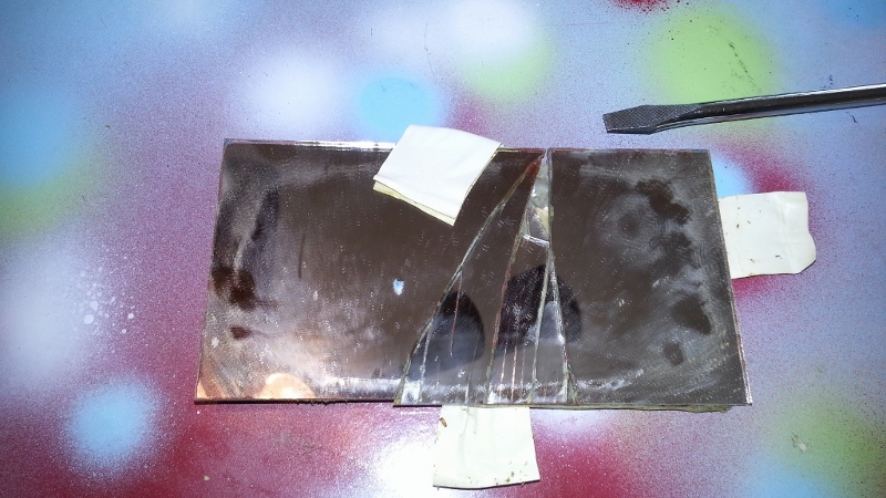

Broken mirror front and back. Back of mirror with material that hold glass together if it should break was all warped. I removed this tape-like material so I could piece the mirror back together and re-secure with new tape.

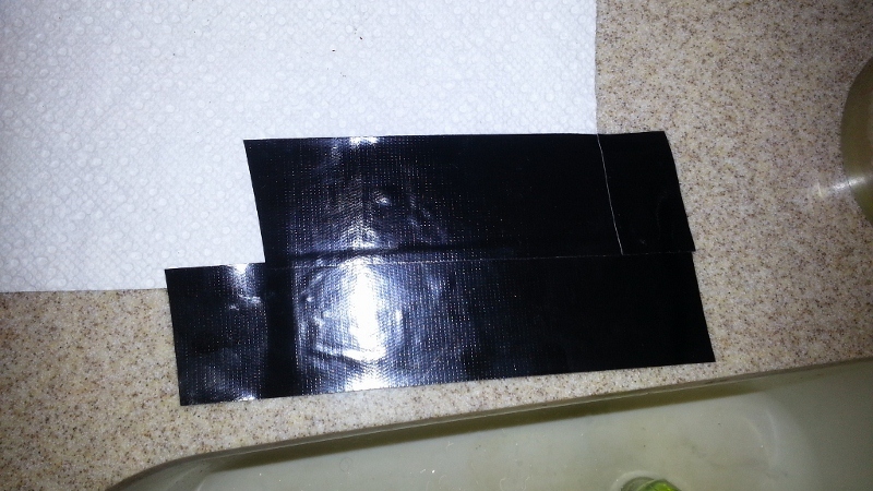

Using Gorilla tape to tape back of mirror to inside of visor as other tape did. Tape secured to mirror well, but just okay to visor. I imagine with a bit of heat, it will stick better to the plastic. The most important thing is to get the mirror stuck into it's fitted housing and secure tabs around edges.

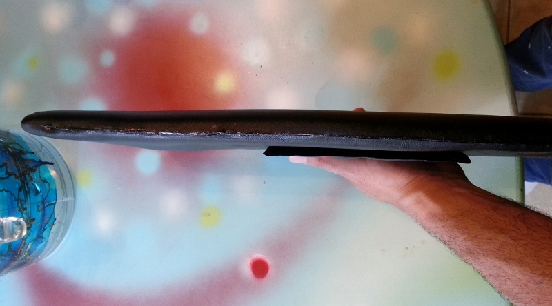

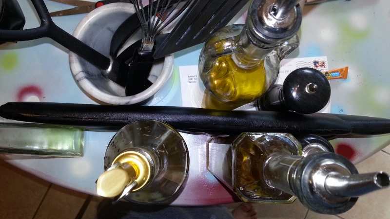

Fortunately, my visor isn't warped. So by propping up bottles around the sides of the visor, carefully adjusting so the seams don't overlap but still go far enough to touch, I used Gorilla glue to glue seam back together. Note that this is very time consuming to get it done right. I glues a few inches at a time and only propped up with bottles along visor as I went along. Otherwise, if you prop up entire visor at once, some areas will overlap and some won't come together. So do a few inches at a time and make adjustments with bottles as you move down the visor. I dabbed the inside of the seam and held together for a bit until i could leave it alone with just the bottles holding it in place. Then I glues a small line on top of the seam, using a piece of paper towel to gently wipe any excess.

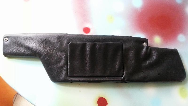

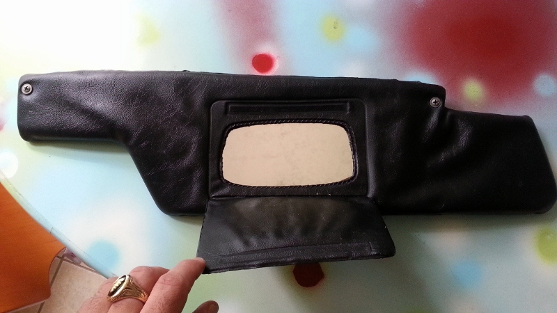

You can see a small bit of the glue on top of the seam after it dries, but that's why I opened it up on the visor's top seam. It is virtually unseen once installed on the car. Gorilla glue doesn't leave so much white hazy residue that Super glue does, so it stayed pretty clear. There were only a couple sopts that looked a bit lighter than black, so I just touched them up with a black Sharpy.
After much patience and waiting to dry, the final product.
Now to fix the spare visor. I am going to patch up the broken mirror because I do not intend to use this visor. Maybe sell it or keep it as a temporary spare. If I were to use it, I would probably get a new mirror made. But I will remedy it so it is usable and safe. First, place glass upside down on a flat surface. Piece the broken glass together, small pieces and all, until mirror fits as is was unbroken. Fix together so each edge is tight and flush with it's opposing edge. With a straight edge, push opposing ends together to make perfectly flush and straight edges.
With Gorilla tape (or clear packaging tape will do), gently (as to not move glass) place tape onto back of glass. Press firmly to hold glass together.
Turn mirror over. Cut excess tape from edges. I left a little overlapping on the two sides that have broken glass just to reinforce (maybe 1/4 inch). Remember not to leave too much as you don't want it visible once installed. Wrap overlapping edges over to front of glass and press firmly.
As same procedure explained above, install in reverse. Secure tabs around glass (tape held glass very well. Did not even move or flex when installing) and reseal visor incision. Finished secondary visor.

So the one good one has good foam, isn't saggy, good mirror and flap. Just need to get some velcro for the flap now.
