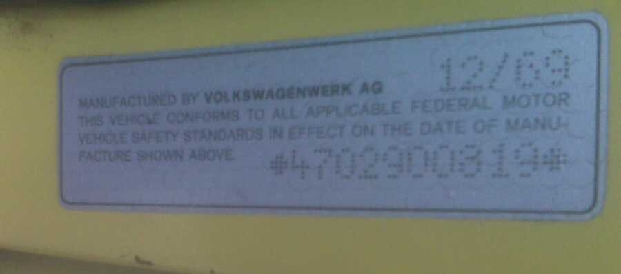

Garold picked up this December 1969 build 914, very cool early stuff!
914Sixer
#319 would be a really early car. Interested in seeing the Karman plate to figure the build date.
GaroldShaffer
QUOTE(914Sixer @ Mar 15 2013, 06:59 PM) *
I will get you Karman plate info in the morning and it's 819 no 319.

Karman Number 4749544
paint code L11E

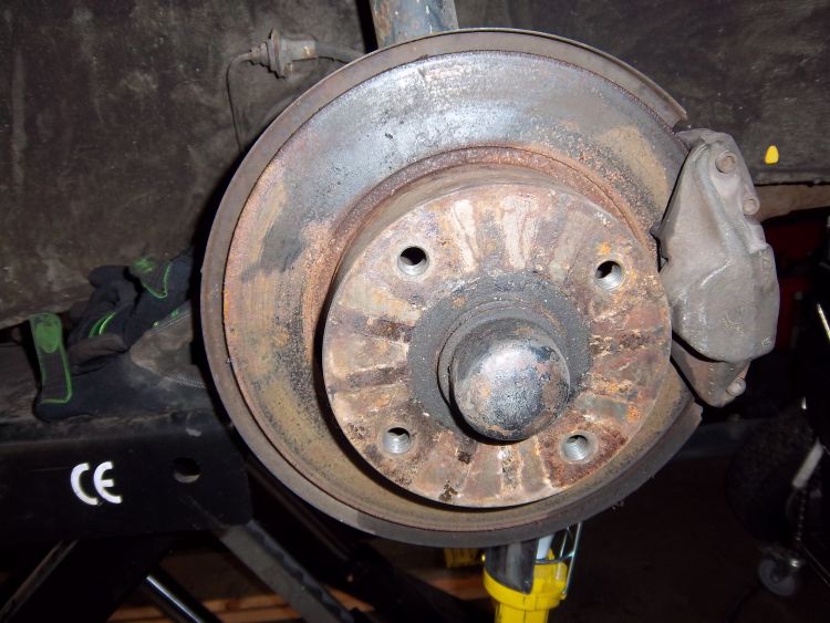

Notice the front brake dust shield is different than later models. It covers the entire brake rotor.

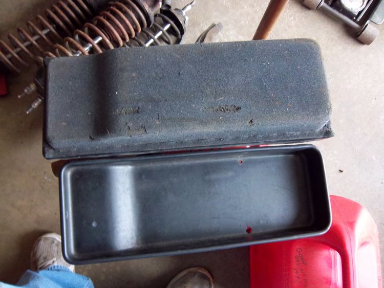

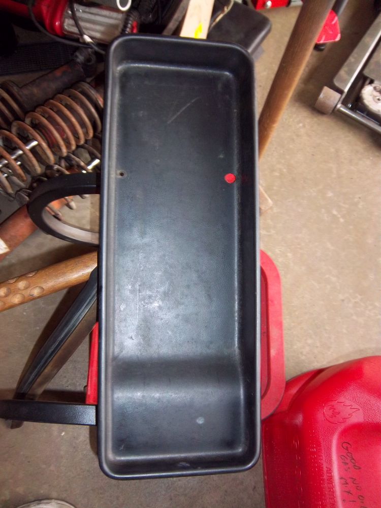

The center tray is different than later. It doesn't have the divider in it. Also notice the contour of the lid.

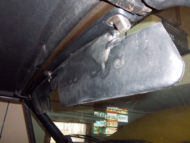

Passenger side visor doesn't have a mirror.

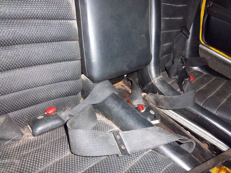

It has the rare(?) third seat belt option.

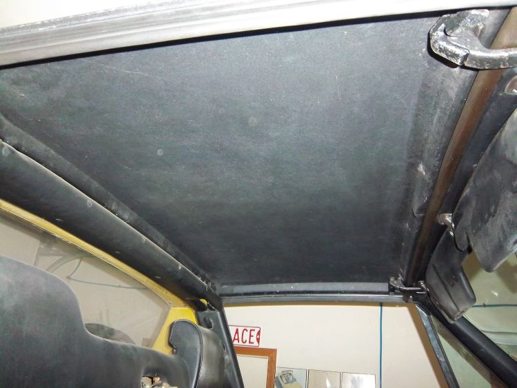

Also early cars didn't have liner on the targa top.

It did get a respray but just on the topside. I have not seen a center tray cushion like it before???
I hope someone will want this 1969 car and restore it.

The Karman number is 4749544 Paint code L11E

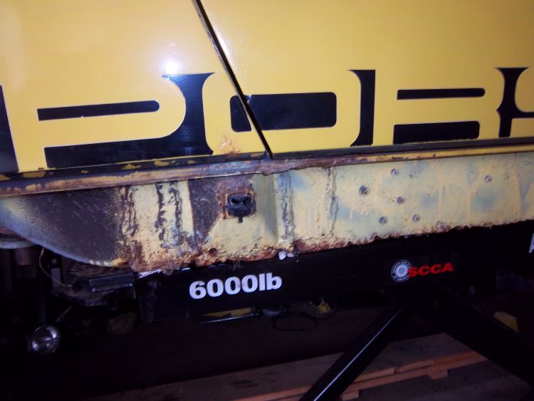

a few more pics of the "issues"

Interesting. This is the first early tray I've seen in an early /4. And the bottom of the cushion, which looks stock, is yet another variation of that item.
Excluding after market and the console cushion, how many different stock variations and combinations are there to fit the trays? I can think of 3 different bottoms now and at least two different vinyl grain tops.
Any 914 built in 1969 should be saved. It's as early as they get without being a prototype.

Don,
I have also seen the 3 variations on the center cushion, it would be great to see more examples of 1969 cars. I have 4702900076 which was a factory car but it was turned into a 914/6 GT in 1971 by Ralph Meaney so there was no stock interior parts left in the car. I also own 9140430012 which has the tray without a divider but it did not have the center cushion when I bought it about 20 years ago.

If I read the chassis # correctly, the chassis was manufactured on the 47th week of 1969.....which works out to be the last week of November 1969. Early car, YES!
gms
QUOTE(1970 Neun vierzehn @ Mar 17 2013, 01:08 PM) *
QUOTE(Garold Shaffer @ Mar 16 2013, 08:53 AM) *
November 20?

I seriously need on of the early center trays for my early #131 914-6 !
Were the early 4's and 6's built at the same time ? I have heard stories that some of the early sixes came a month later? idea.gif
gms
QUOTE(pete000 @ Mar 22 2013, 03:35 PM) *
From the information that I have collected the tray pictured above would have been in 914/6s built up until February 1970 or around # 250

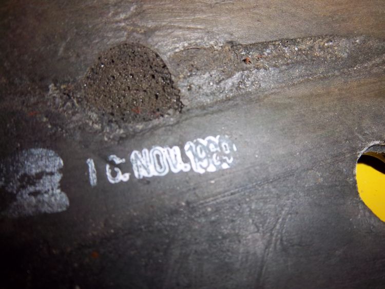

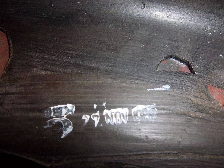

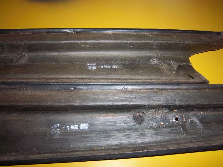

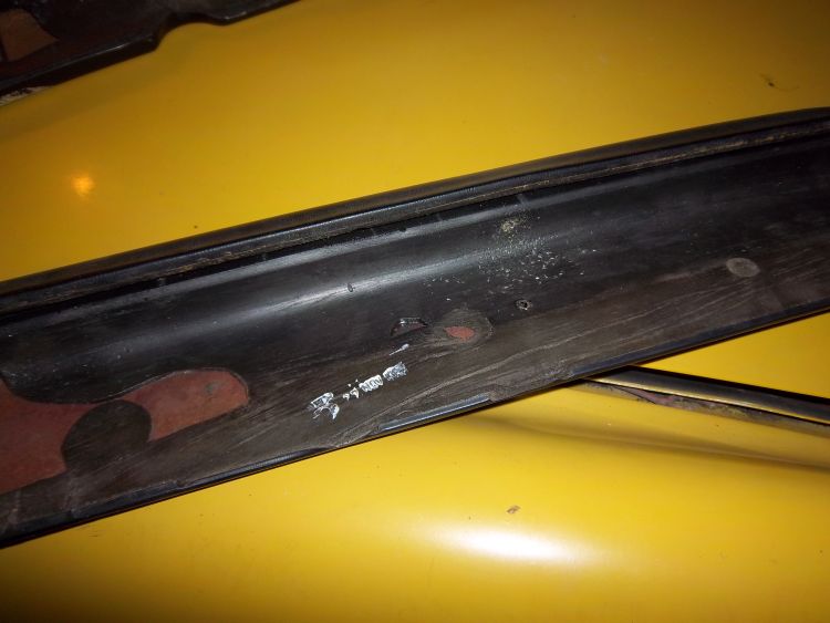

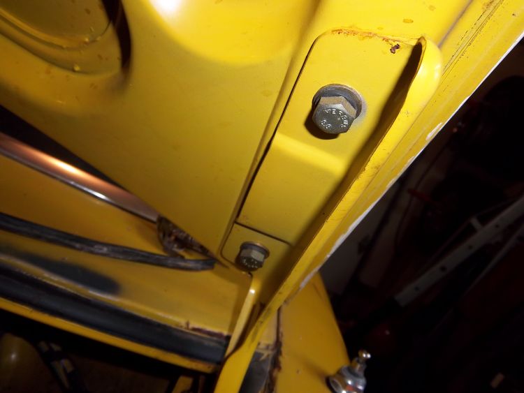

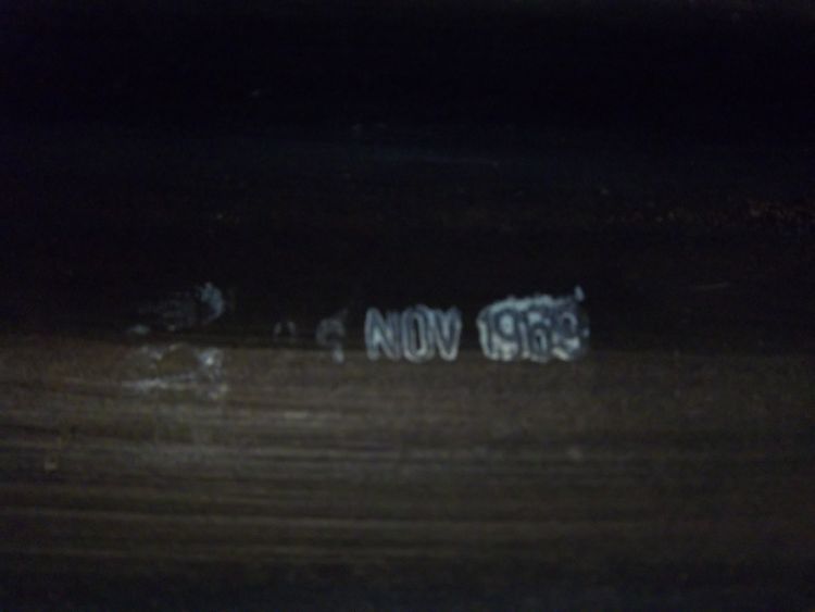

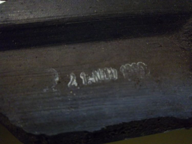

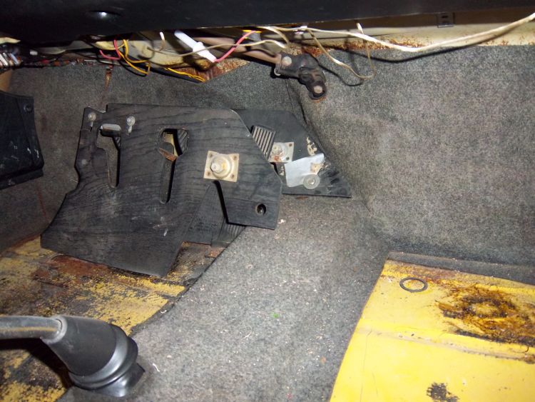

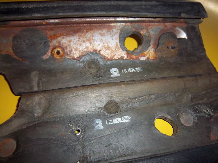

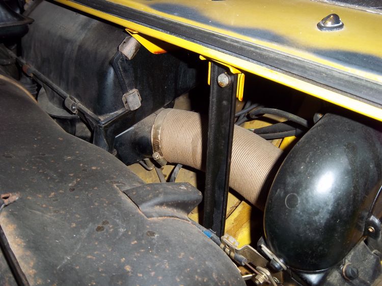

So Thursday Glenn drove down and we started to part this 914 and look at all the one off / early 69/70 parts and photo doc it.
Some of things we knew already like the targa bar top latch is chrome not black, the center tray doesn't have a divider and cushion bottom molded to match. It has the 3rd seatbelt option and also the inside chrome door latch is narrower than later cars.
A few things we found was:

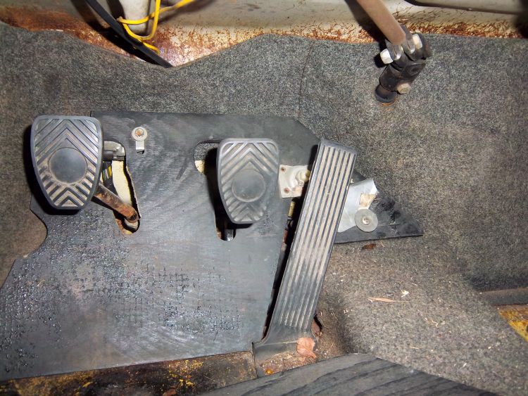

1) the pedal board is longer on the right side.
2) All the bolt heads for the trunk lids and under the cowl re not painted body color.
3) The two bars that bolt from under the cowl to the firewall are black, not body color

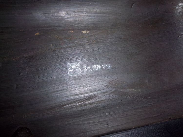

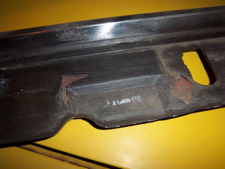

4) The interior parts are date stamped on the back side. A Pillars, B Pillars, Dash (upper & lower). I didn't find anything on the door panels, seats or backpad.

So mysix has that pedal board and pass visor, The floors do not have the locating lugs for the carpet, nor does the carpet have the holes.
0390 door tag 2/70
Does that chassis have carpet locating lugs ??
GaroldShaffer
QUOTE(sixnotfour @ Mar 24 2013, 02:55 PM) *
0390 door tag 2/70
No it does not.
