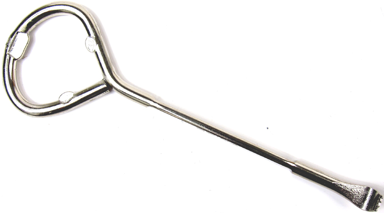

A paint can opener has enough curvature of the blade to fit under the lip, I prefer it to a screw driver.

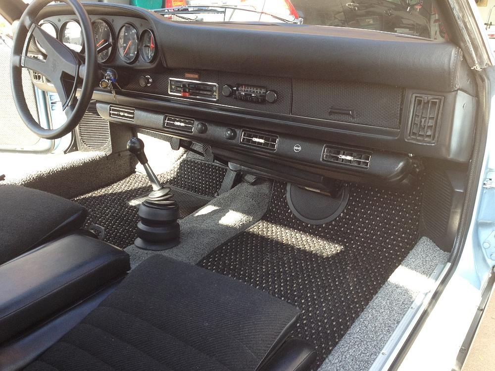

Here's the dash I'm trying to have the modified gauge blend into. The clock is on the far right.
