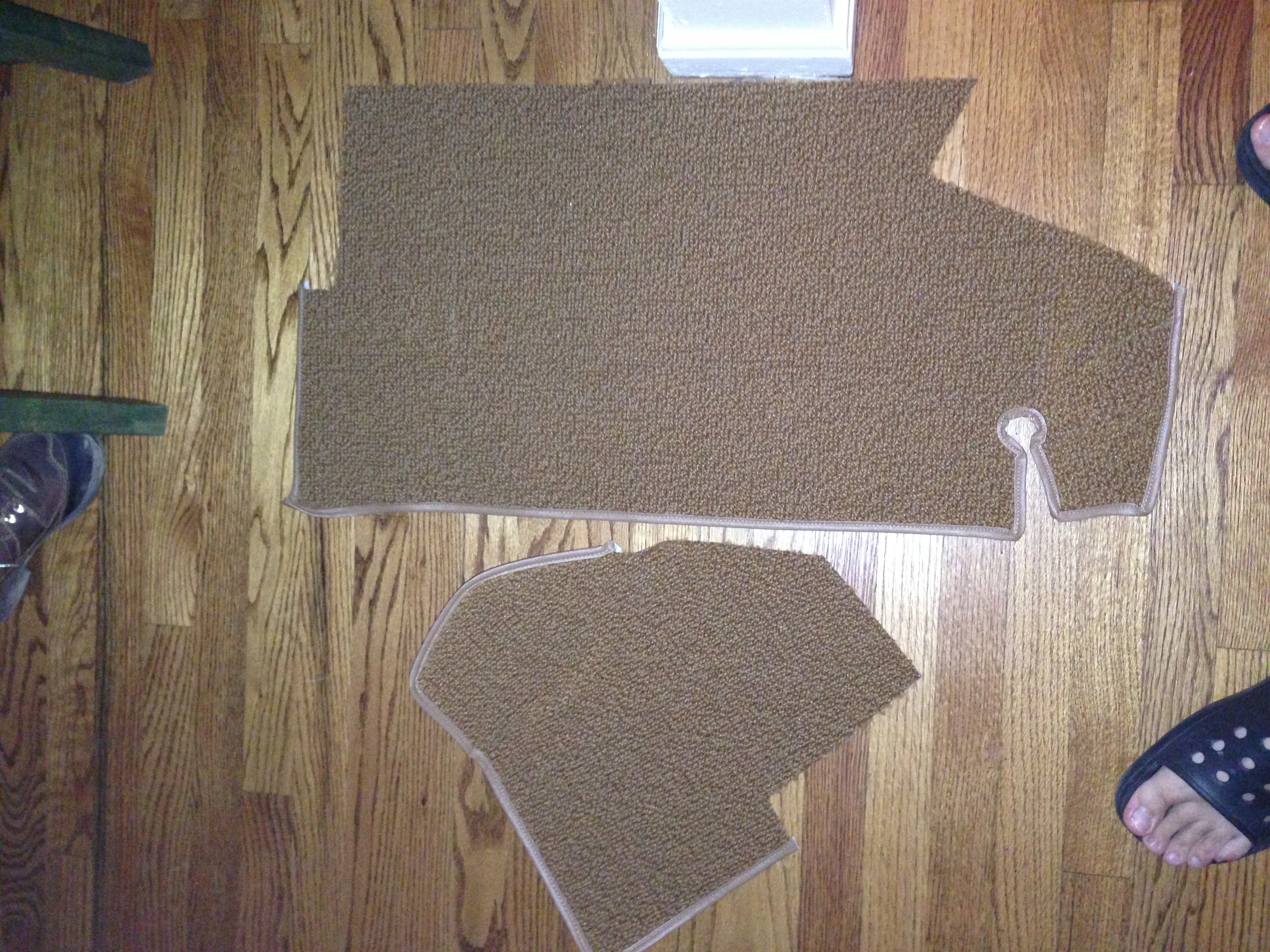

I just got my new carpet but it has been so long I can remember how it all goes back together. There are obvious parts like the longs, driver & passenger foot well that are obvious
Thanks
David
Harpo
The large one with the hole is most the center tunnel with the shifter
However the other three I have no idea
David
Harpo
Both of these have have have some additional sewing on them possibly to fit in corners
Dave_Darling
Lower-right looks like it goes over the shifter.
Upper-right looks like it goes on the driver's firewall above the pedals. If that's the case, the upper-left would go on the passenger-side firewall.
Not sure about the small piece in lower-left.
The other possibility for the two upper pieces would be behind the seats on the floorpan.

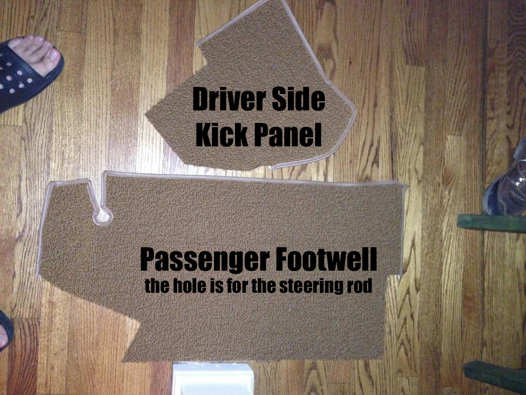

EDIT: You added the next pic while I was posting.
The one in your second pic with the cutout looks like it goes on the driver's long, with the handbrake handle pivot going through the hole. Dunno about the other one.

I think that "?" piece goes up by the pedal cluster.
Harpo
Thanks everyone
GaroldShaffer
QUOTE(tod914 @ Aug 9 2013, 11:56 PM) *
