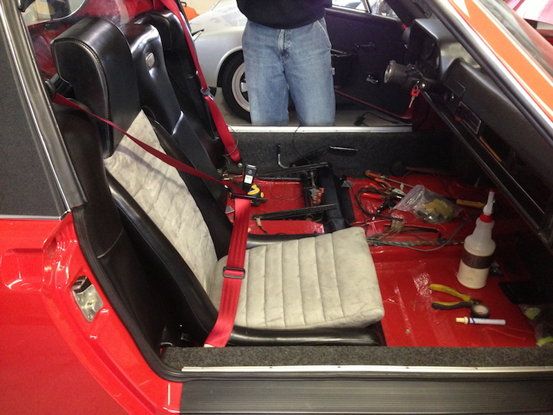

Had seatbeltplanet rebuild my belts in red to match the car- did a great job and they work like new. Look OEM except for colour... Using original female end.Click to view attachment
