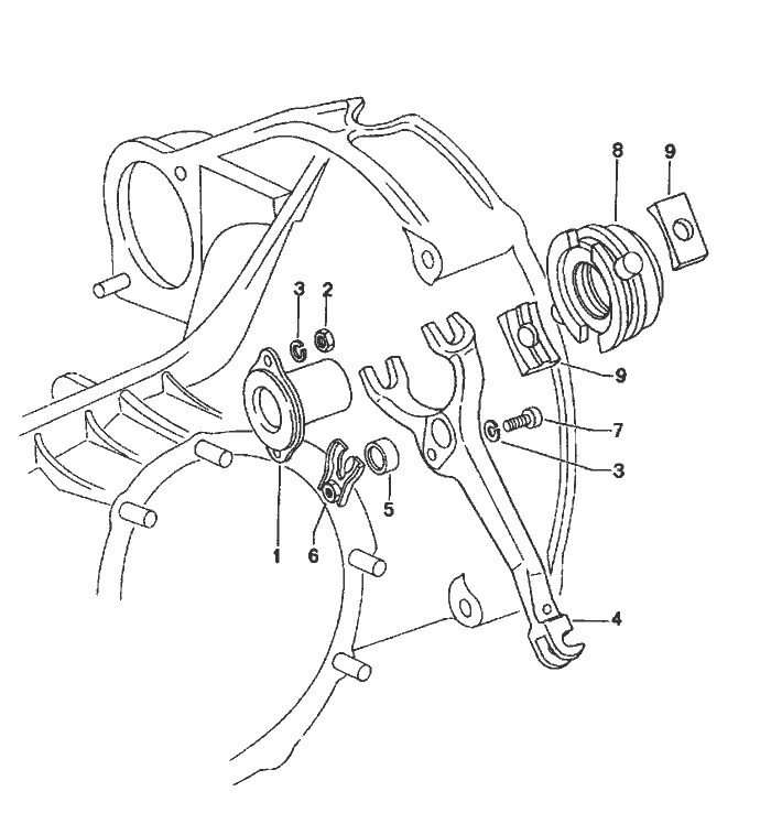

Did you replace the throw out bearing?
If it is part of the gear stack, then it was either ok or replaced. Mike (Dr. Evil) did the rebuild. We just installed it back in the car.
I am thinking pinion depth is off a bit. Would that make sense to anyone? Would that cause a whirring sound when the car is rolling? Then goes quiet when. I push in the clutch?
I just hate that because it requires dropping the tranny again and draining expensive swepco oil and pulling the stack out. Just a lot of work after all of this already done.
