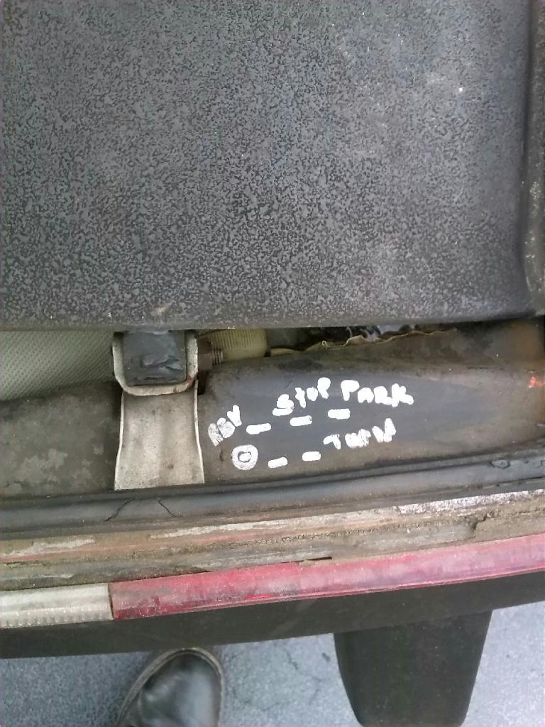

ripper911
Some previous owner marked my taillight housings.
IPB Image
It's a 74
Hope it helps.
