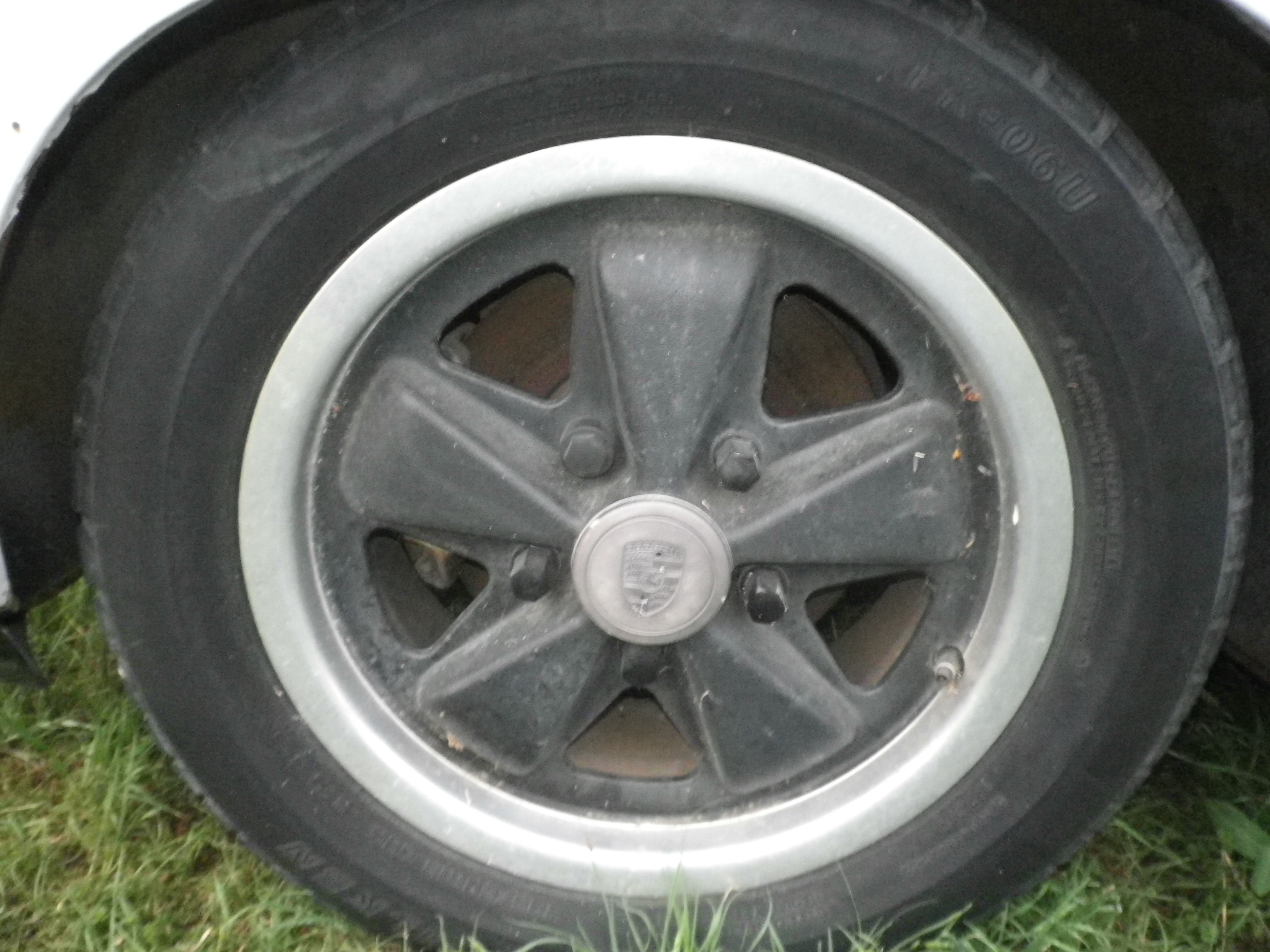

I just found this 1972 parts car and trying to figure out what these wheels are and how to remove them to put on a 71.
I would like to find a key to fit these as opposed to just grinding them away if they are a Porsche lugs.
Also, does anyone know what these wheels are???
The tires are 195 15
Thanks in advance.
George
71 1.7
Austin, TexasClick to view attachment Click to view attachment

I don't see the heart.
Deep6
QUOTE(Dustin @ Apr 4 2014, 08:43 PM) *
Your right, no heart.

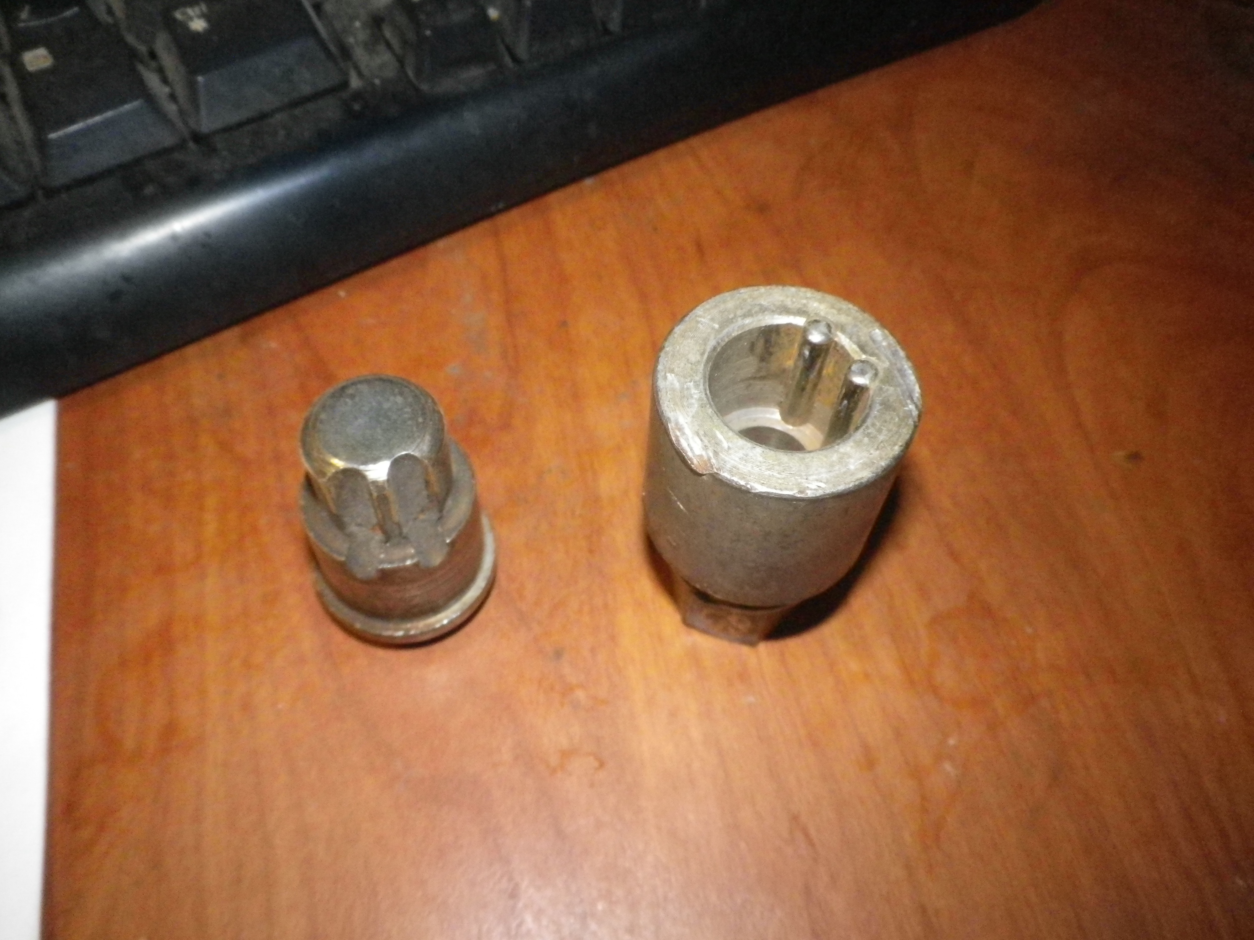

I guess I won't know until I can remove them. I have an early 911 key, but it doesn't fit. Click to view attachment

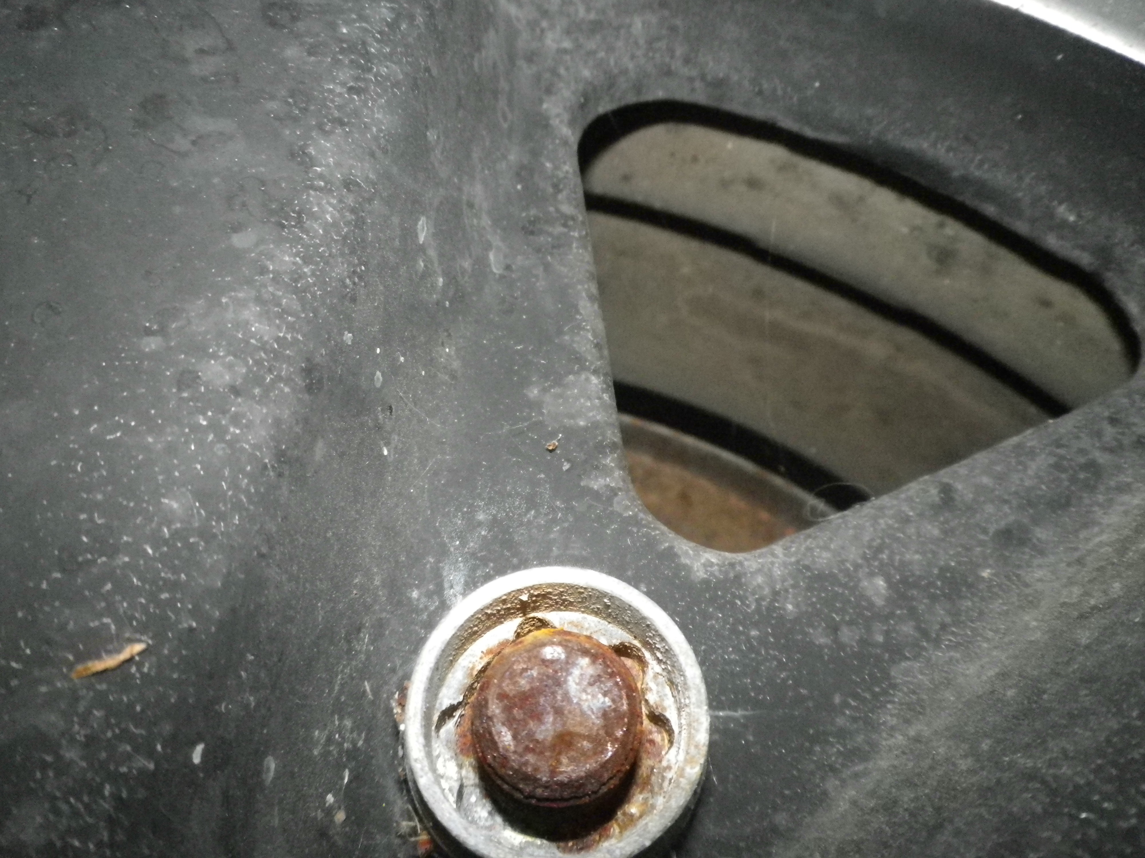

Take a chisel and a BFH and smack em lefty loosey till they come off. Wear your safety glasses.
smarens
is it a lug on a stud? I can't be sure from the picture, if so you can take a die grinder with cut-off wheel and carefully put a cut in it length wise to remove most of the pressure and chisel idea is excellent, might be easier, I had to do that once on cheap stripped out wheel lock
carr914
Craftsman makes a Tool to take Wheel Locks off. Before you Fuch up a Whell call around to a few Tire Stores to see if they have a Tool to take them off. When you get them off, throw those Fuchers in the Trash.
Not all Early Fuchs have Hearts!
ClayPerrine
QUOTE(carr914 @ Apr 5 2014, 05:23 PM) *
And they are on it inside if they do have them, so you won't see them until the wheel is off the car.
ConeDodger
Looks like a Mcgard sp? wheel lock.
If it's a real early Fuchs wheel and I would guess it is if it only has a 195 tire on it, the car is came off of and it seems many of the parts, are made almost literally of gold.

I did check the other wheels and found one where the previous owner attempted to remove one of the locks on a wheel. I ended up using a 3/4 inch Milwaukee whole saw from Home Depot. 45 min. later, I drilled far enough to loosen the bolt.
The other three I want to find the proper key or I'm thinking of taking the car to a local machine shop to have them removed??
Turns out the wheels are 15x6 aew, oh well but they are in nice shape.

it did turned out to be "lug on a stud"
bandjoey
I couldn't find a tool to fit mine. Bought a HF impact socket. BFH to install it. Lots of penetrating oil. Breaker bar. Finally turned it off. Drive it in. Turn.
campbellcj
That looks like a type of lock that was on my 70 911 when I bought it many many years ago. I had to have them cut-off by a tire shop, and they did it with no damage to th wheels or studs. The name of the lock may come back to me but very hazy right now - I'm thinking "McGuard"?. The only other option floated was to make an impression/mold and cast a new key from it, but that seemed like a giant PITA.

Chris, I believe you are correct, "McGuard" from looking on E-bay, Advance Auto Parts and Auto Zone. In the description it claims "•The computer generated key designs allow for an infinite number of key patterns". So finding a matching key is a waste of time.
The problem with the one I removed the stud was loose and spinning because it came unpressed, hopefully the rest won't be so difficult.
Thanks all for the suggestions, the cut off with a delicate bfh path will work.

dan_the _body_guy
the easiest way ive found to remove wheel locks is to weld a nut with slightly larger threads in top of the lock then just use a socket and breaker bar to spin them off..a quick work of caution: cover the wheel with something before welding so you dont get slag melted to it welder.gif

I just use a nice, sharp air chisel......

Daily shot of P.B blaster and a sharp chisel was all it needed to persuade the other 3 off.
