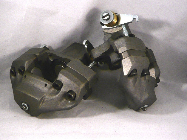

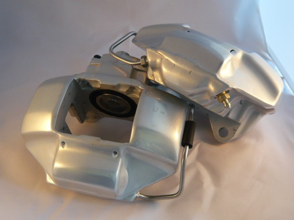

I currently have stock rear calipers, and the fronts I upgraded to 911 Struts and M calipers so I could run vented rotors. The front upgrades weren't a big cost if you shop around the classifieds and watch for fair prices. I also run a 19mm Master Cylinder, and Pagid Orange pads. That combo works great.
Here is my new setup from PMB. Not the least cost option.... But overtime I'm going for the 914- 6 GT setup and saved up for awhile to make this happen. They go on later this summer. Still need to get the rear vented rotors and then my shopping list is complete.
Front S Calipers
Rear Alloy 914-6 GT with emergency brakes
