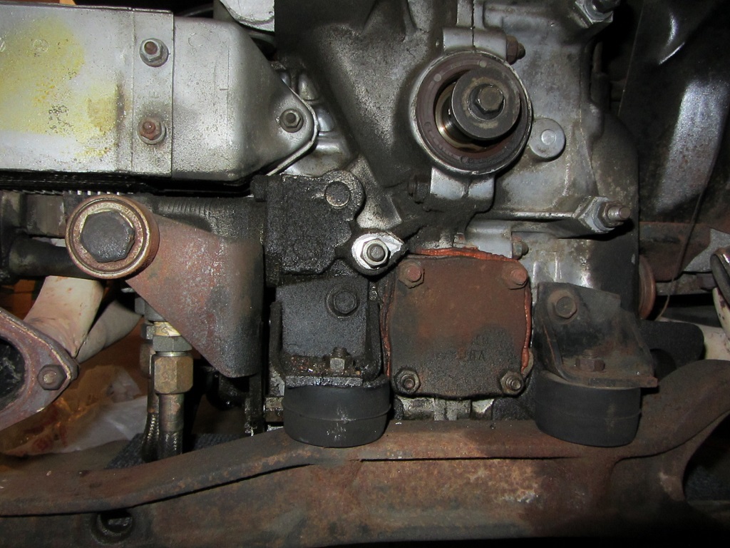

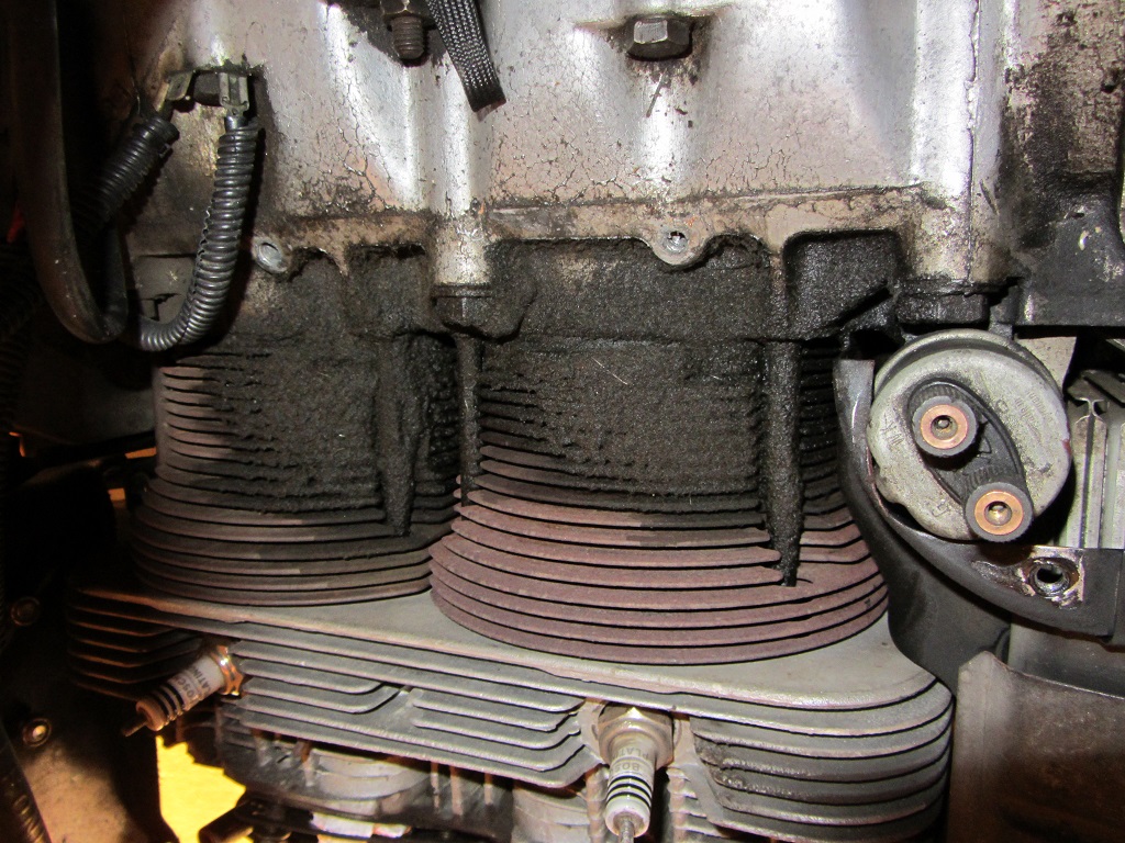

Bought my '75 1.8 dual carb 914 a few months ago and have been loving it. First time poster but long time reader here. She ran fine until the impeller hub spun free of the crank and began to overheat. Based on oil temp gauge, it didn't get into the red zone. Anyhow, I've dropped the engine to repair the impeller hub and am now faced with what else to repair while it's out. Bottom of engine and trans were wet from oil leaks. Not a highly uncommon problem I'm sure. headbang.gif
What has me most concerned is the leaks at the cylinder/case interface of all four cylinders. I was hoping the oil was being blown back from oil pressure sender but no luck as all four cylinders are same and sender connection is dry. Never got around to performing compression test but engine pulled strongly.
The second major issue of concern is that the Melling oil pump might be leaking. I can't tell for sure but would hate to repair after putting engine back.
My questions regarding cylinder leaks:
Should I/can I bother to re-torque the head bolts? I'm hoping that the leaks were exacerbated by the crank vent being partially blocked. How concerned should I be? I'm not ready for a rebuild.
My questions regarding oil pump:
What should I try to do? Replace gaskets? Replace pump altogether? I get intimidated by oil pump posts regarding getting the right clearances, difficulty in pulling pump out, etc.

if you're not ready for a rebuild, clean it up, adjust valves, put it back, drive it, let it leak .... all it will hurt is the ground where you park it
stugray
And I am not convinced that oil buildup is really a leak around the cylinder bases.
What does the oil cooler look like?
Dont worry about it, clean it well. Might as well replace that front oil seal while its right there.

What about re-torque of head bolts?
What about oil pump?
It is possible that oil on cylinders came down from oil fill/breather with PO but the tins above cylinders have what appears to be oil blown up from cylinder base too.

Maybe oil filter flange gasket.
Remember that this engine is pulling air in from the engine bay and blowing it downward across the cylinders.
So I suspect that the oil you see is crankcase venting "smoke" that is blown down through the cylinders and leaves that "sludge" on top of the cylinders.
Notice how it is concentrated on the "leading edge" of the restriction as the air is forced to turn the corner and go down through the colling fins?
I suspect that you have some on the oil cooler too.
