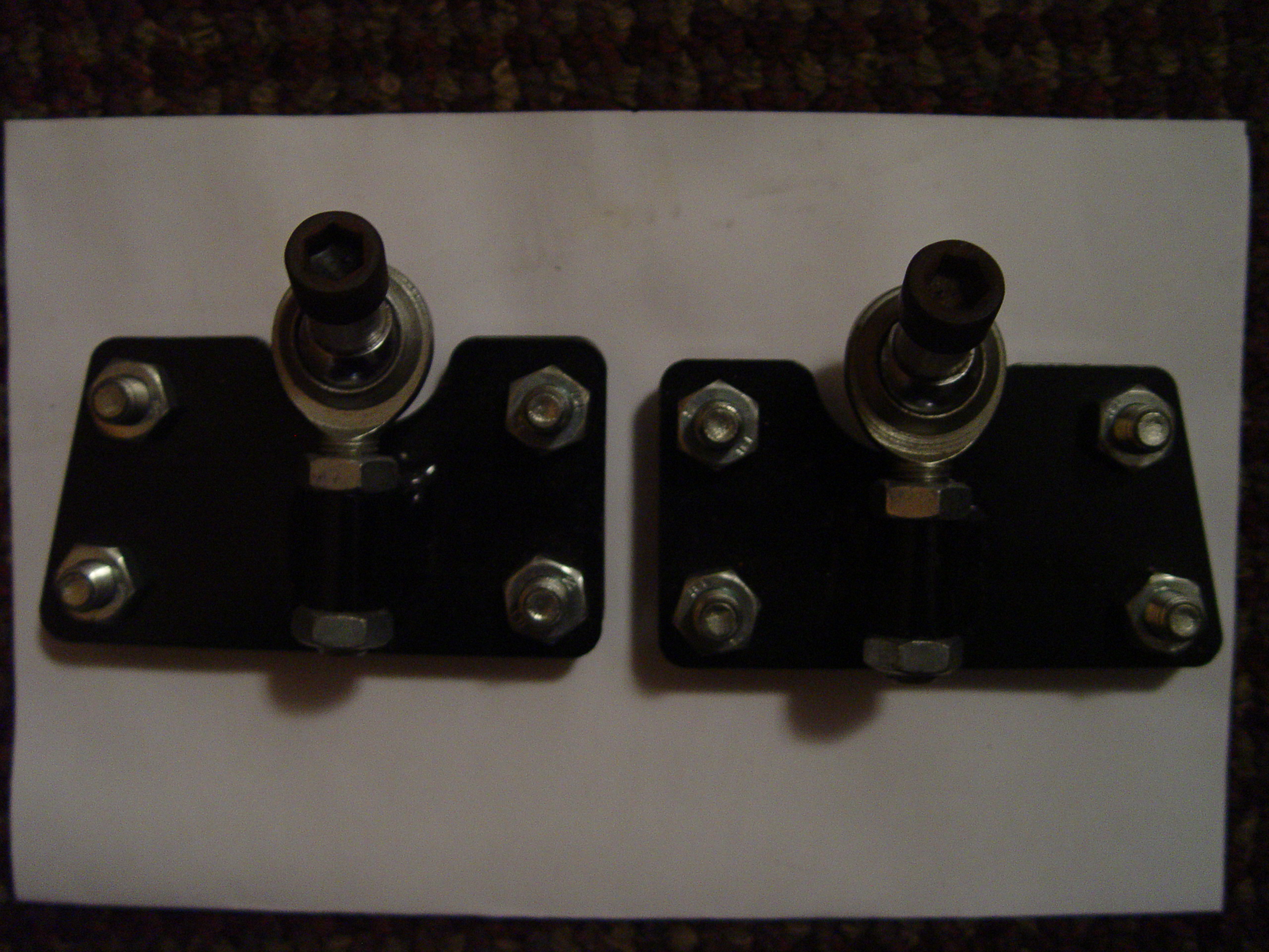

I know there is a left and right side, but which way ? The instructions include a hand drawn picture that doesn't clearly show the orientation..........Does anyone have a picture of either side installed on your car........Thanks in advance.

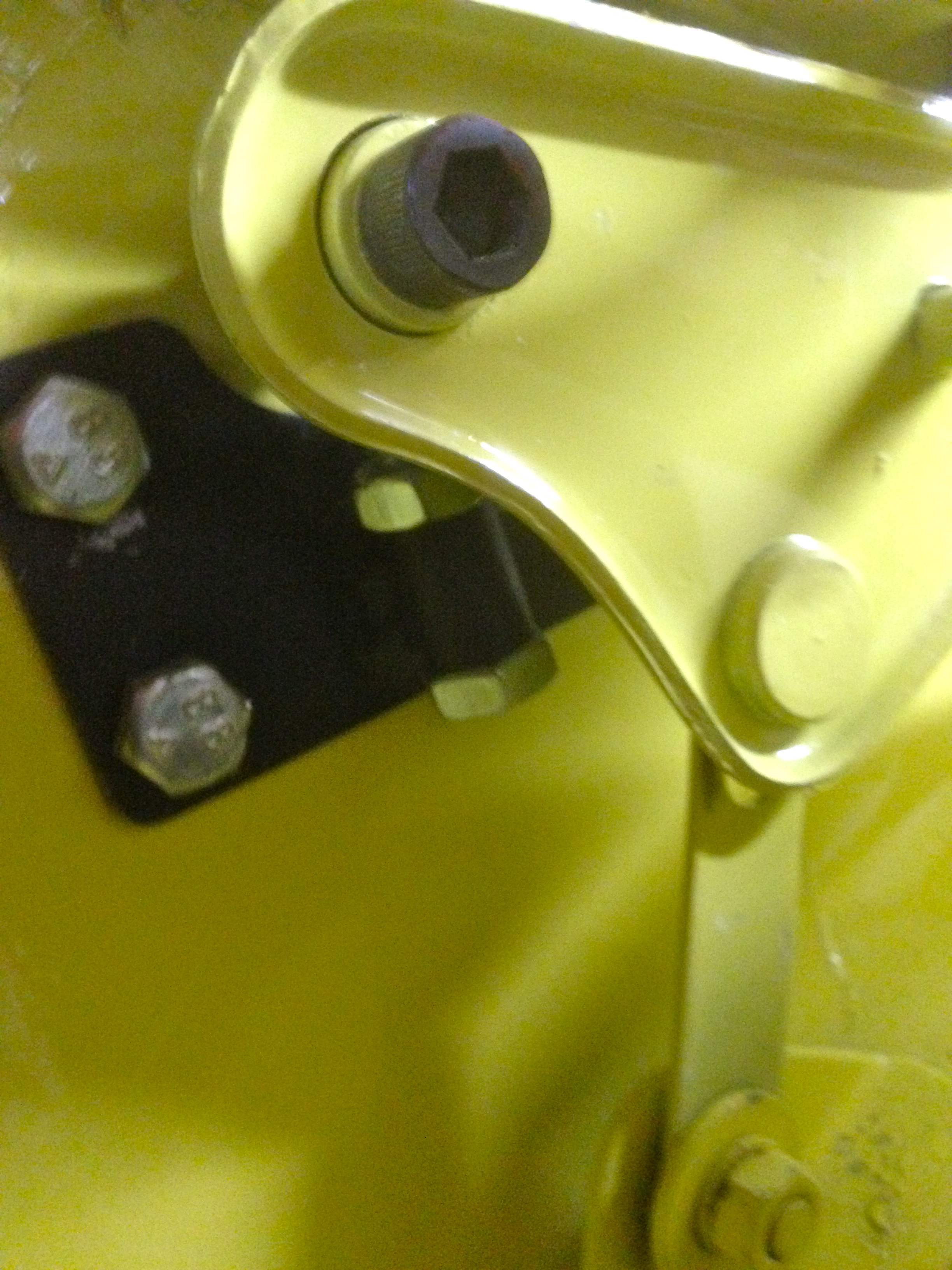

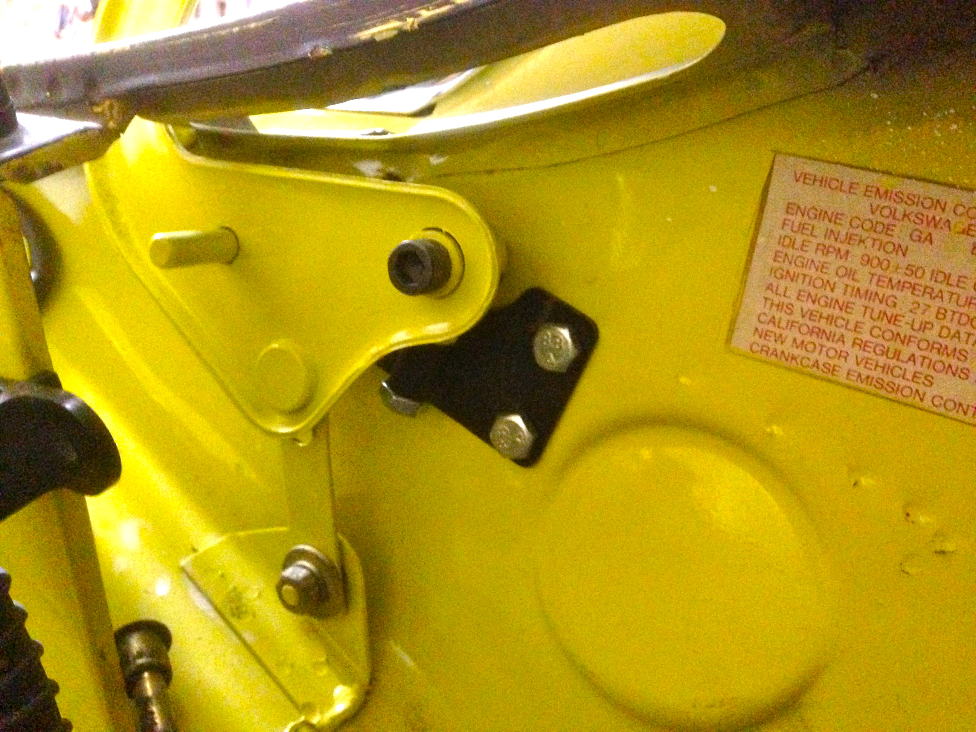

Click to view attachment driver side, cutout is up, adjustment bolt at bottom

sorry for poor pictures
passenger side,Click to view attachment

wes........I really appreciate the pics, but I am still not sure about which side goes where. If you look at the picture of the pair I have you will notice that one end is angled and the other end is straight. I am assuming they were cut this way for a reason and need to know which way they go.

It's been a while since I've installed a set but I seem to recall that if you separate the mount from the backing plate they are marked on the back with a Sharpie. When installing you need to position them so the bolts don't go thru the double walled area under the sail panel.

I'm confused about a drawing, I've never drawn it and my instructions include a picture of the left side, oriented to show the alignment.
In the picture you can see the vertical support bracket, the hinge, and the stamping for the 914/6 oil filler. The angled side of the bracket is to the rear. The picture is taken with the trunk lid closed and shows 3 of the four holes can be accessed for drilling. Once these three are installed, the trunk can be raised, moving the hinge away so the last hole can be drilled.
Since the pivot is installed with the deck lid closed and aligned, it really does not matter how it is oriented as long as you can access the holes for installation. The picture gives the general idea.
