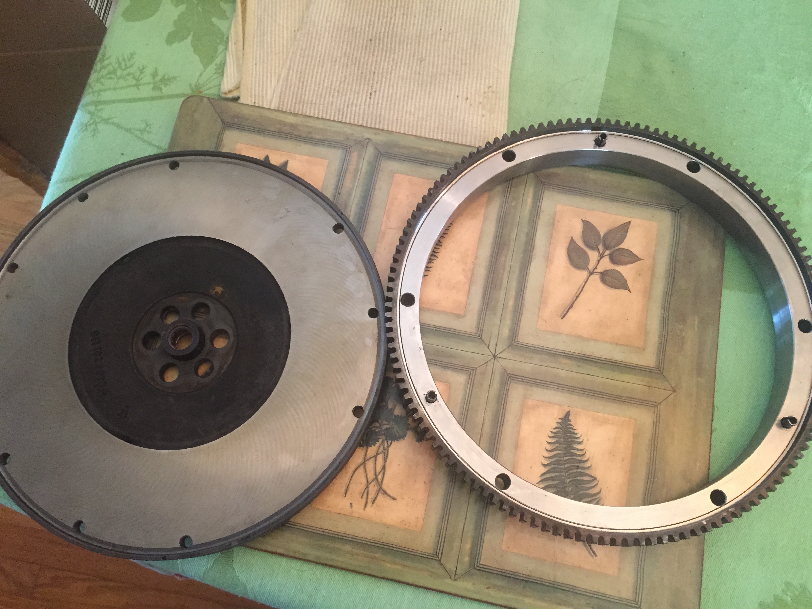

I recently purchased all the goodies for my 2.7 to mate to my 901 box. the ring gear adapter, clutch, and PP. Im having issues though trying to get my flywheel and ring gear mated the the measurements seems to be a tad off on the adapter and I cant put them together. Should I just do a hot cold thing to try and get the metal expanded to where itll fit together or what?

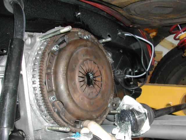

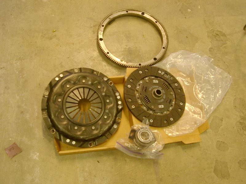

PS: Here's my setup, lightened 993 flywheel, ringear adapter and KEP Stage 3 clutch and pressure plate:

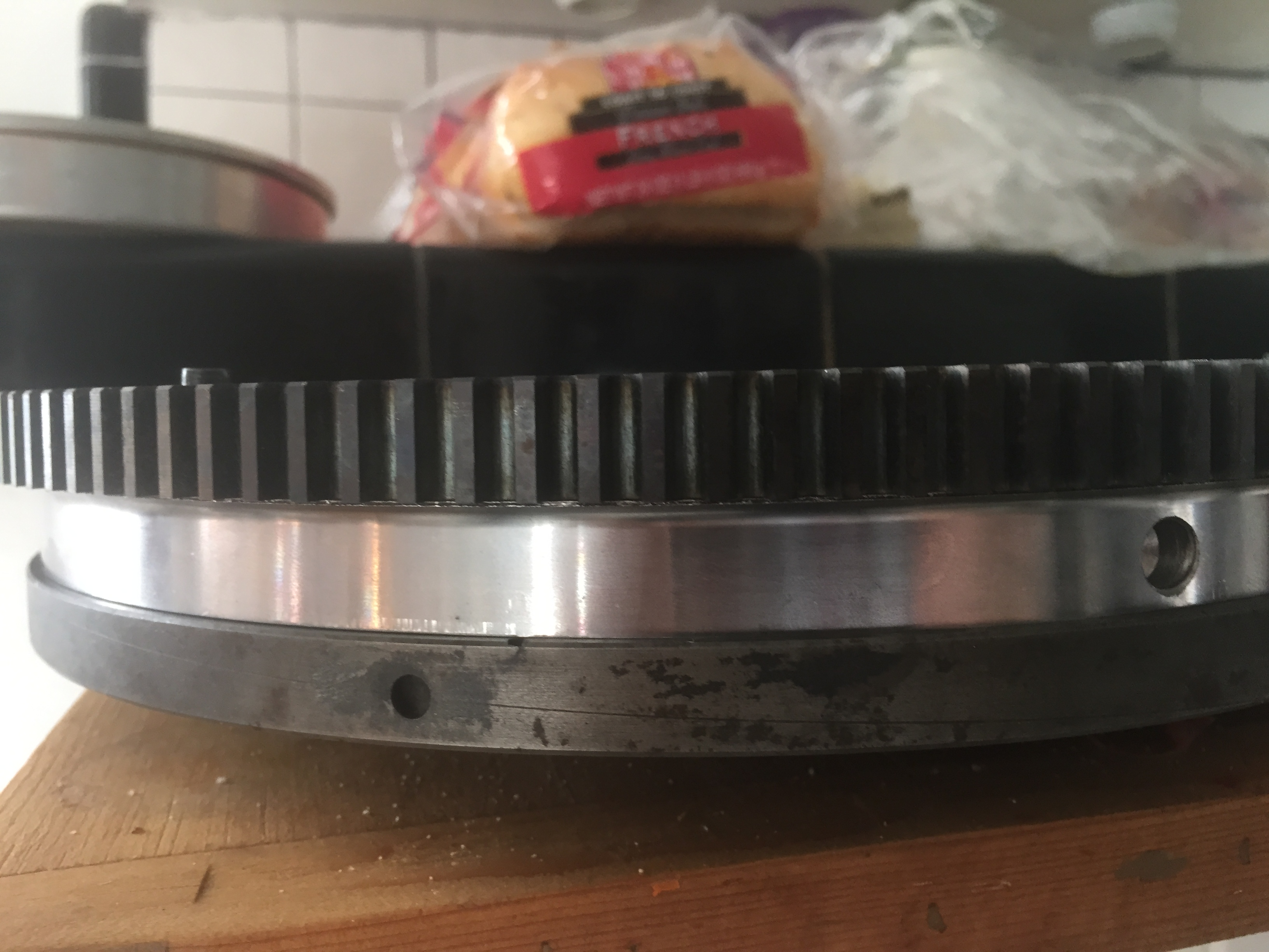

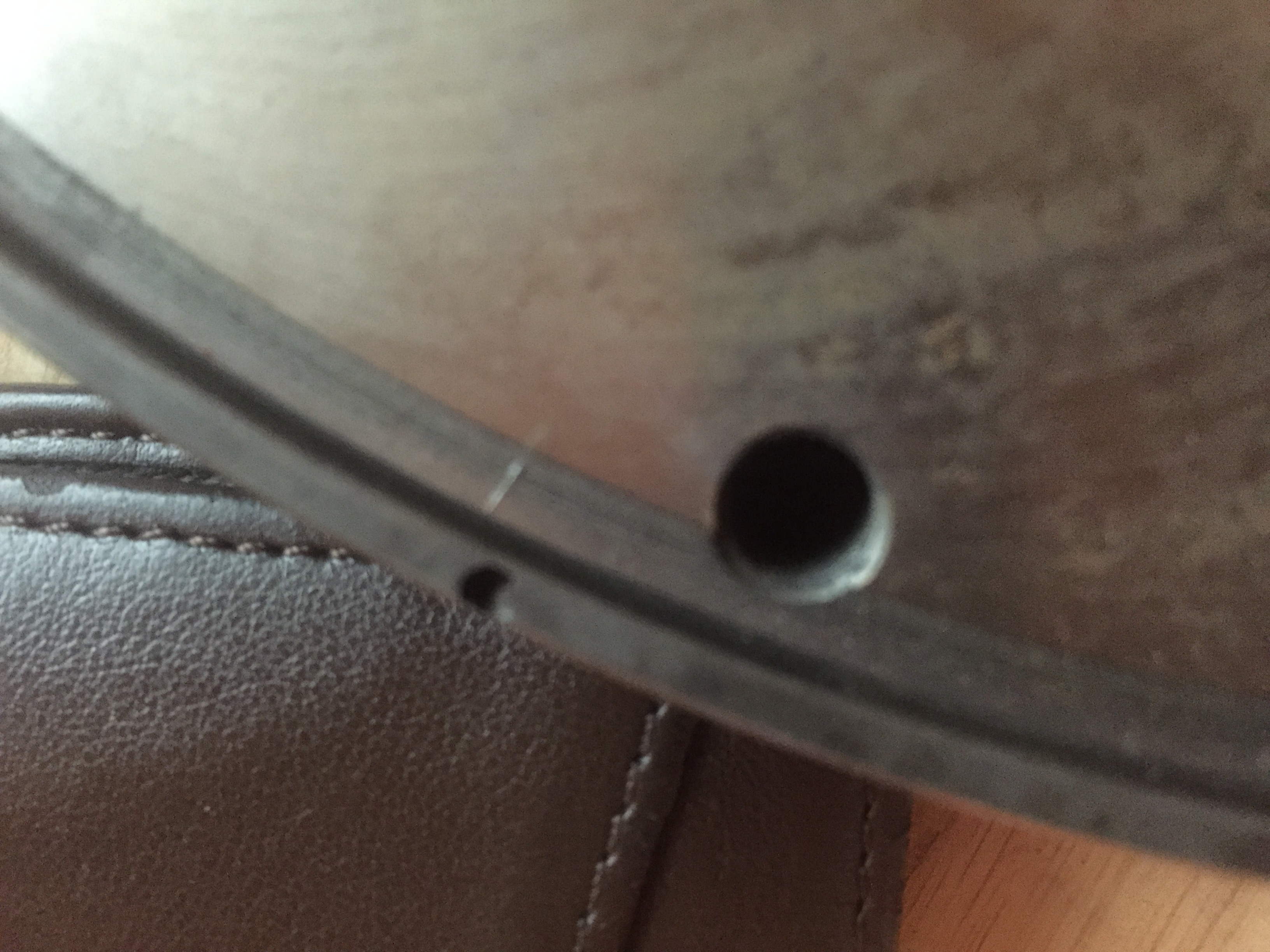

Click to view attachment Click to view attachmentClick to view attachment

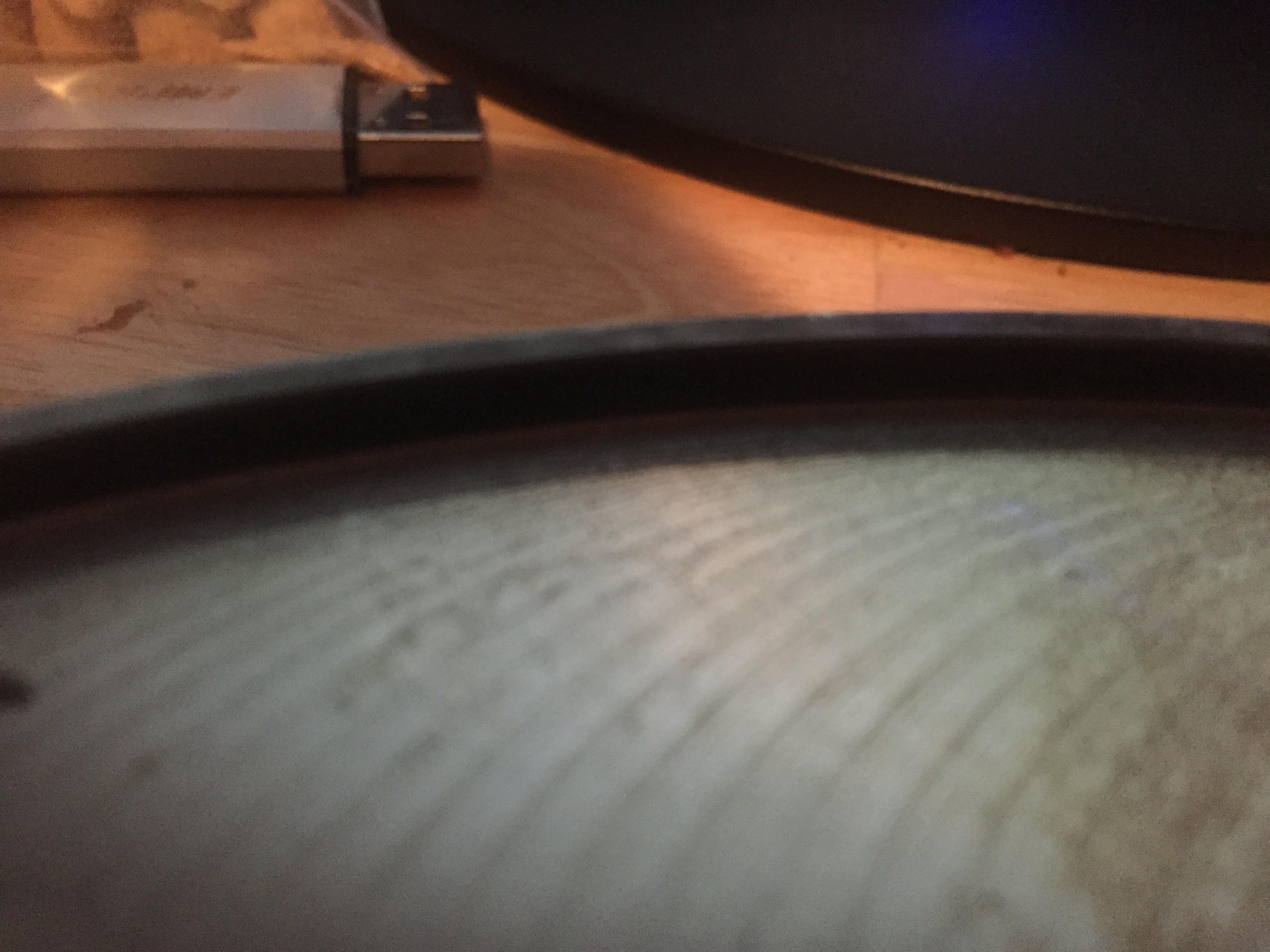

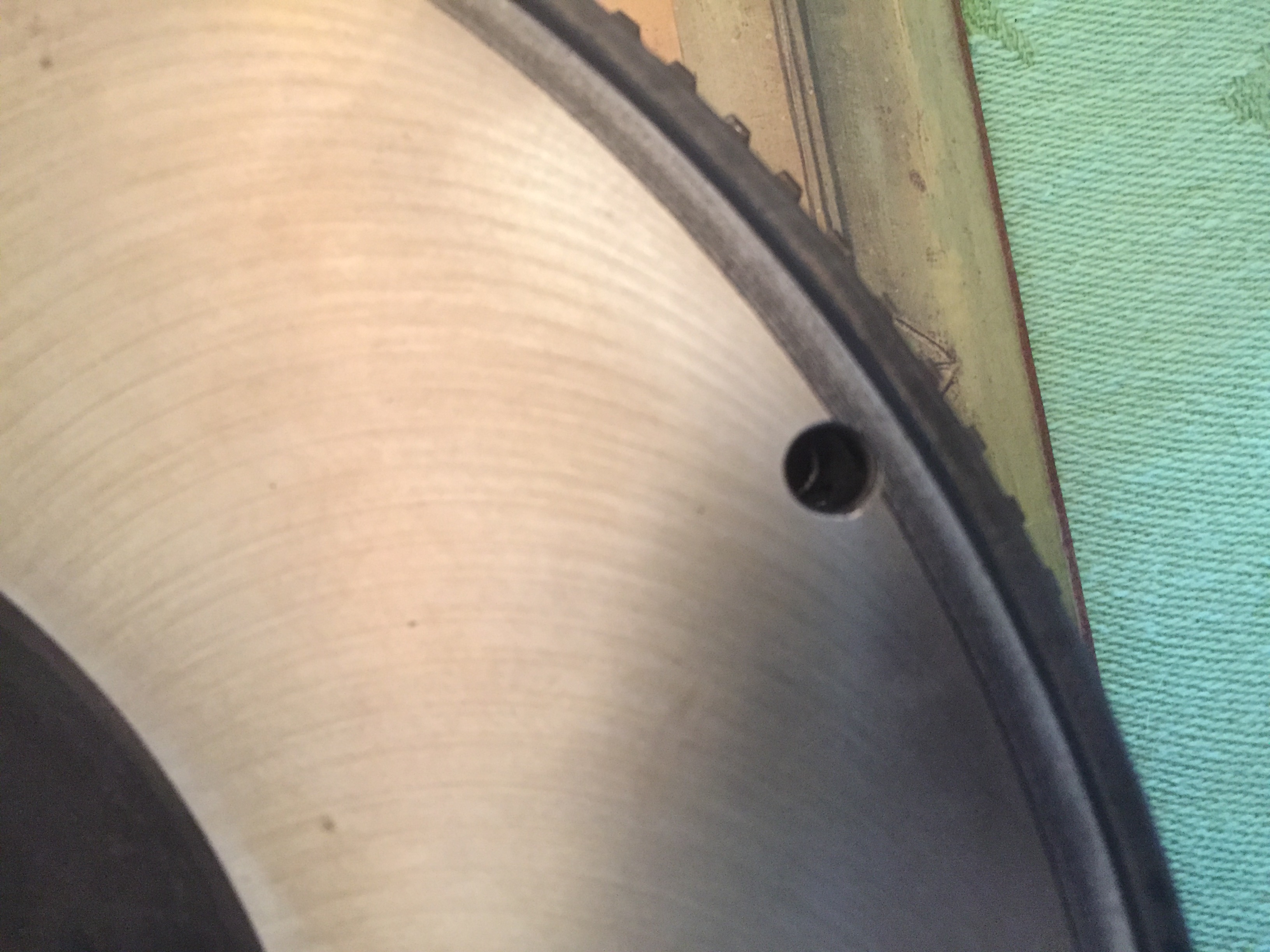

the 1st one is in the hole where the other 2 are off just a tad...
I'm confused. Is that ringgear cut down at all? This looks like a complete flywheel.

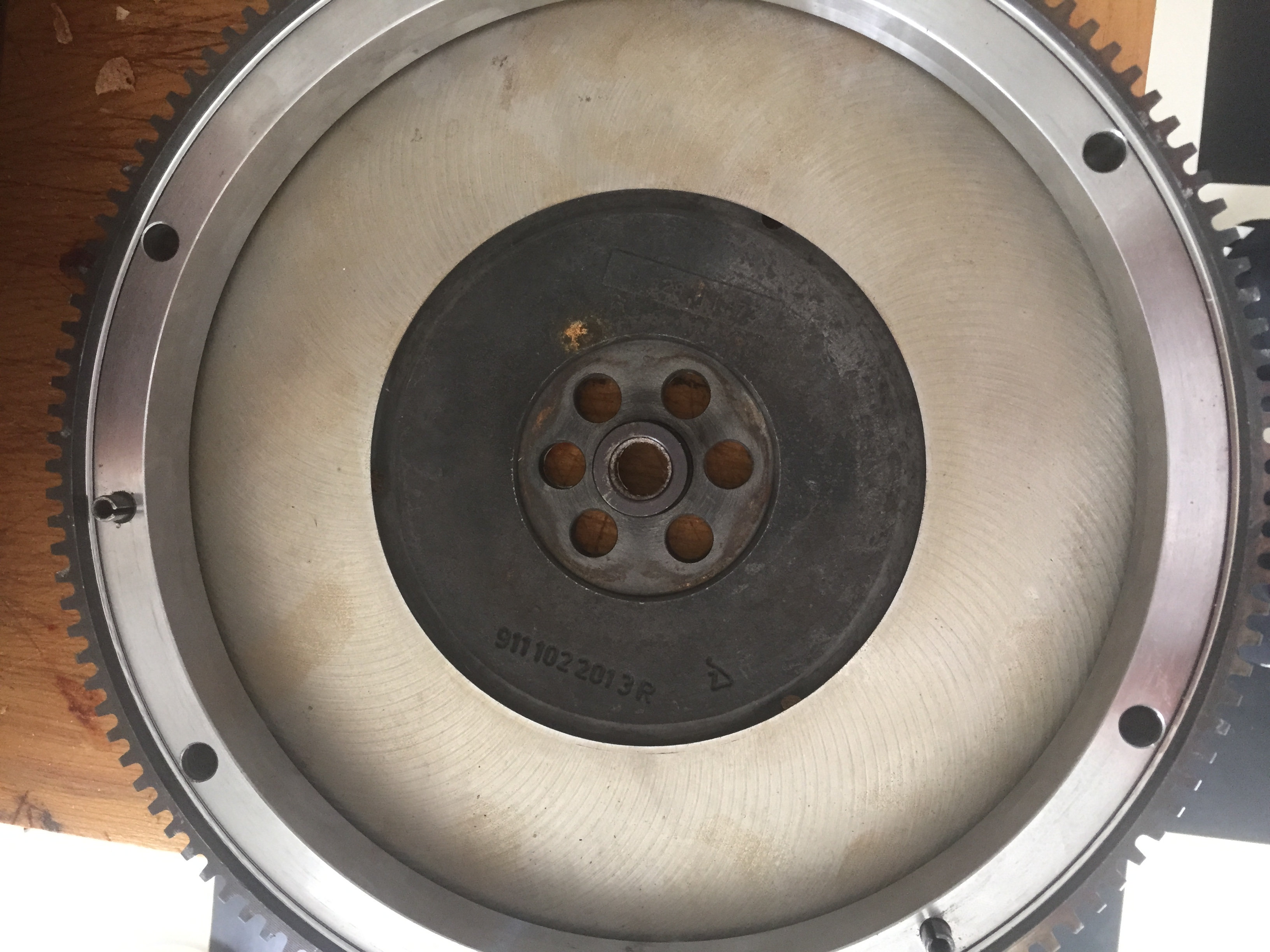

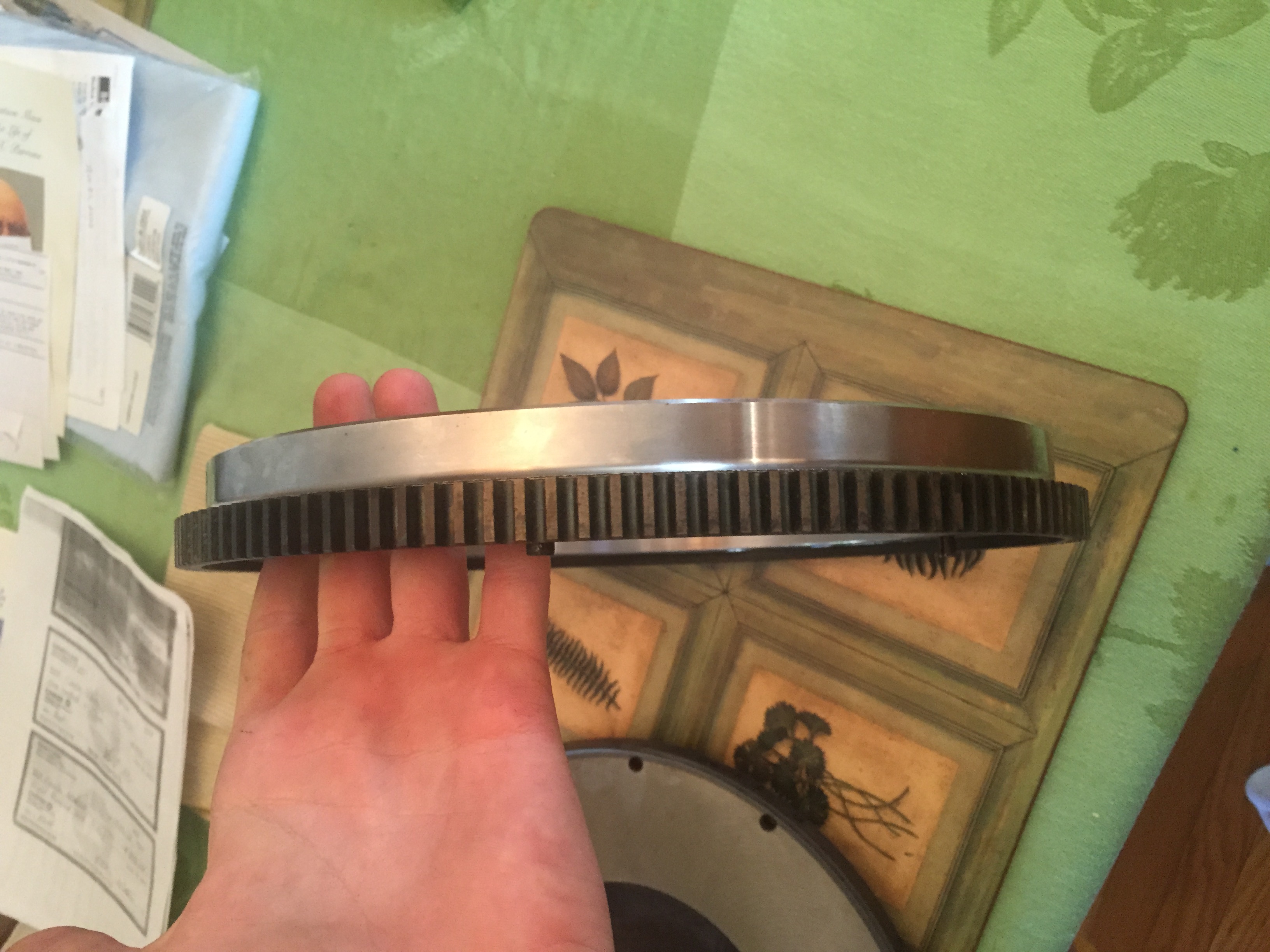

Am I just being dumb.. this is very likely, as im also working on studying for finals.Click to view attachment Click to view attachment
QUOTE(Cfletch @ Dec 8 2014, 12:39 PM) *
The ringgear goes on the surface side of the flywheel. The pins are used to locate the pressure plate to the ringear, not to mount the ringear to the flywheel.

Maybe this pic helps ...

so like this?Click to view attachment Click to view attachment there is no end to my stupidity lol-2.gif
QUOTE(Cfletch @ Dec 8 2014, 01:37 PM) *
so like this?
Yes, that's more like it. Does the ringear fit flush with the flywheel? Hard to tell from your picture.
Cfletch
No... but it could be because I heated up the gear and cooled the flywheel. Hopefully thats why, if not what would I need to do?

It also looks like your ringgear is missing the mounting holes to secure it to the flywheel.
On mine, the pins were removed and the holes reused to countersink bolts to mount it to the flywheel.
The other 6 remaining holes are used to mount the pressure plate to the ringgear.

Is the new resurfaced area flat all the way to the flange 360 around ?? I looks like the resurface may not be 100% centered to the flange, leaving a step ??
Andy the ring gear is part of the spacer on this style..

I know that but if you look at his picture, it looks like the ringear does not evenly touch the flywheel surface.
If it sits on the outer lip, the flywheel needs to be machined to make it sit flush.

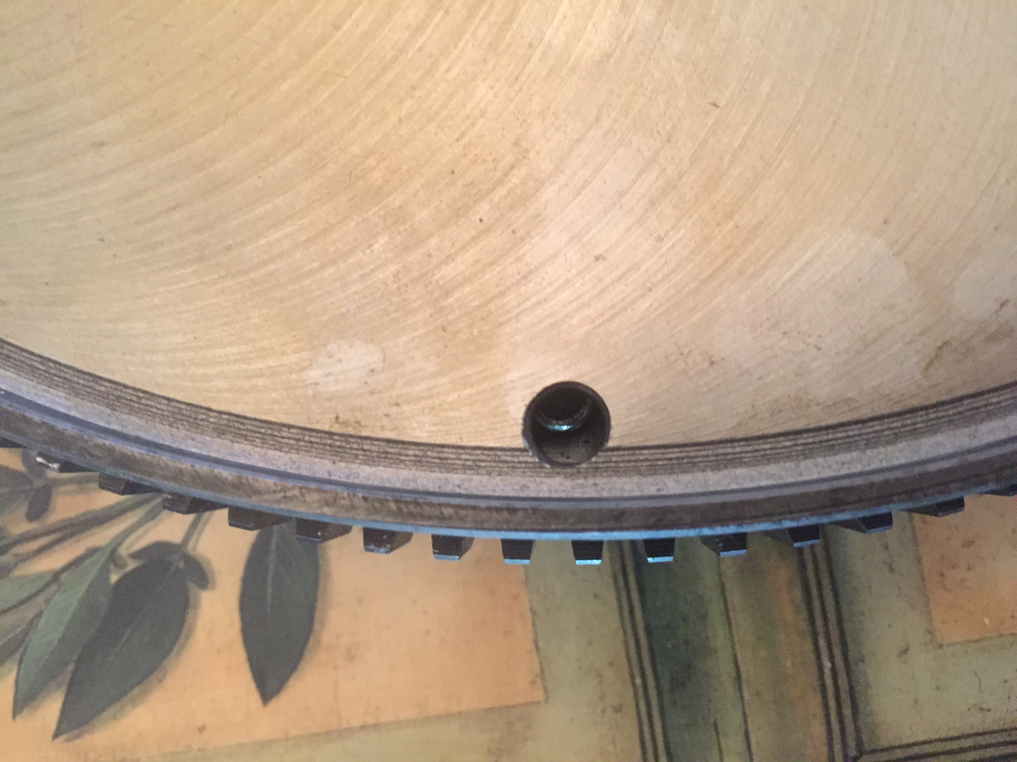

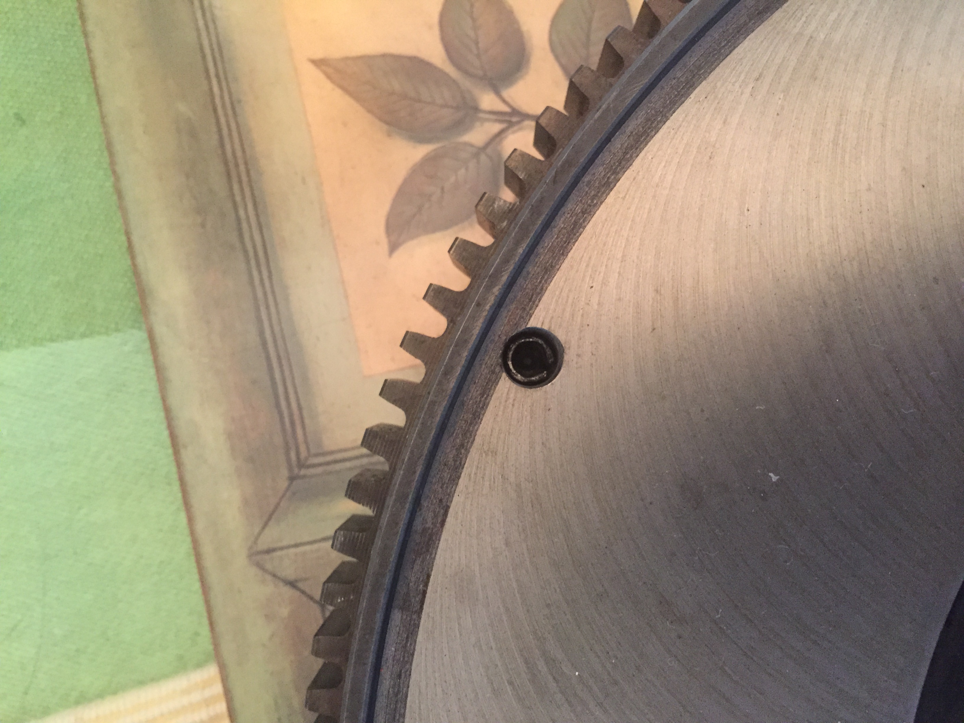

heres some close ups to my flywheelClick to view attachmentClick to view attachment
sorry for blurryness but you get the gist
QUOTE(Cfletch @ Dec 8 2014, 02:00 PM) *
The ringear is supposed to fit inside tightly and make full contact with the flywheel surface.
Also note that the inner edge of the ringgear is often chamfered and can make it appear as if it doesn't sit flush when in reality it does.
