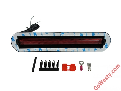

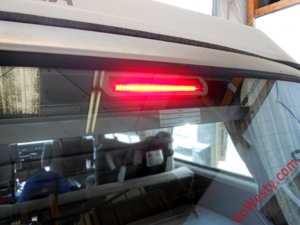

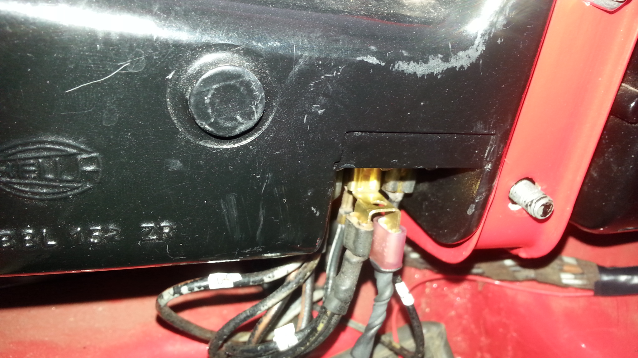

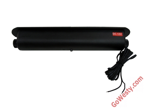

Let me update this to say:
This is an economical ($25-30 part), easy & fast (1-2 hrs to stick-on & wire into tail brakelights/harness) for a quick 3rd Brake Light addition. This light unit is enclosed with wires & adhesive face to mount it to your rear window - no screws nor clips needed to mount the light & no reflecting glare off the glass.
You'll need to look at your 914 wiring diagram to see where best to wire it, but they can be dropped down behind the rear backpad & into the trunk &/or engine bay to tie into the brake lights & pull off any easy existing screw to body for ground.
This part is probably also available elsewhere - maybe cheaper - & is on sale in Jan 2015 at GoWesty (they put them on sale a couple of times a year as Monthly Specials).
There are also several other more expensive & complicated solutions discussed below & with links by other posters, if this doesn't suit your liking. .....
This should also work well for those who want to add a 3rd brake light to their 914 at reasonable cost, but you may need some extra wire to reach the taillight buckets/harness to tie into.
http://www.gowesty.com/ec_view_details.php...gory_parent_id=

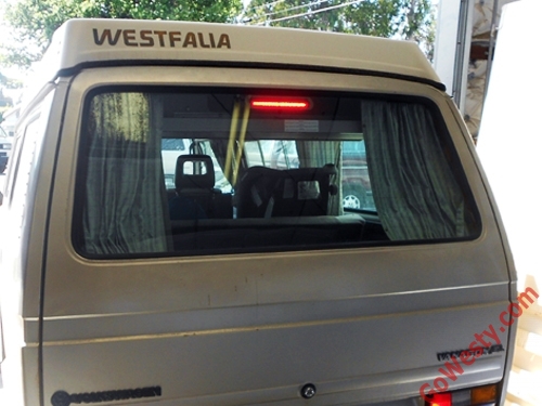

I put it on our `88 Westy as per their instructions at the GoWesty website after my wife had gotten rear-ended in it a couple of years ago, & it works well & adds visibility to our "brick on wheels"! blink.gif

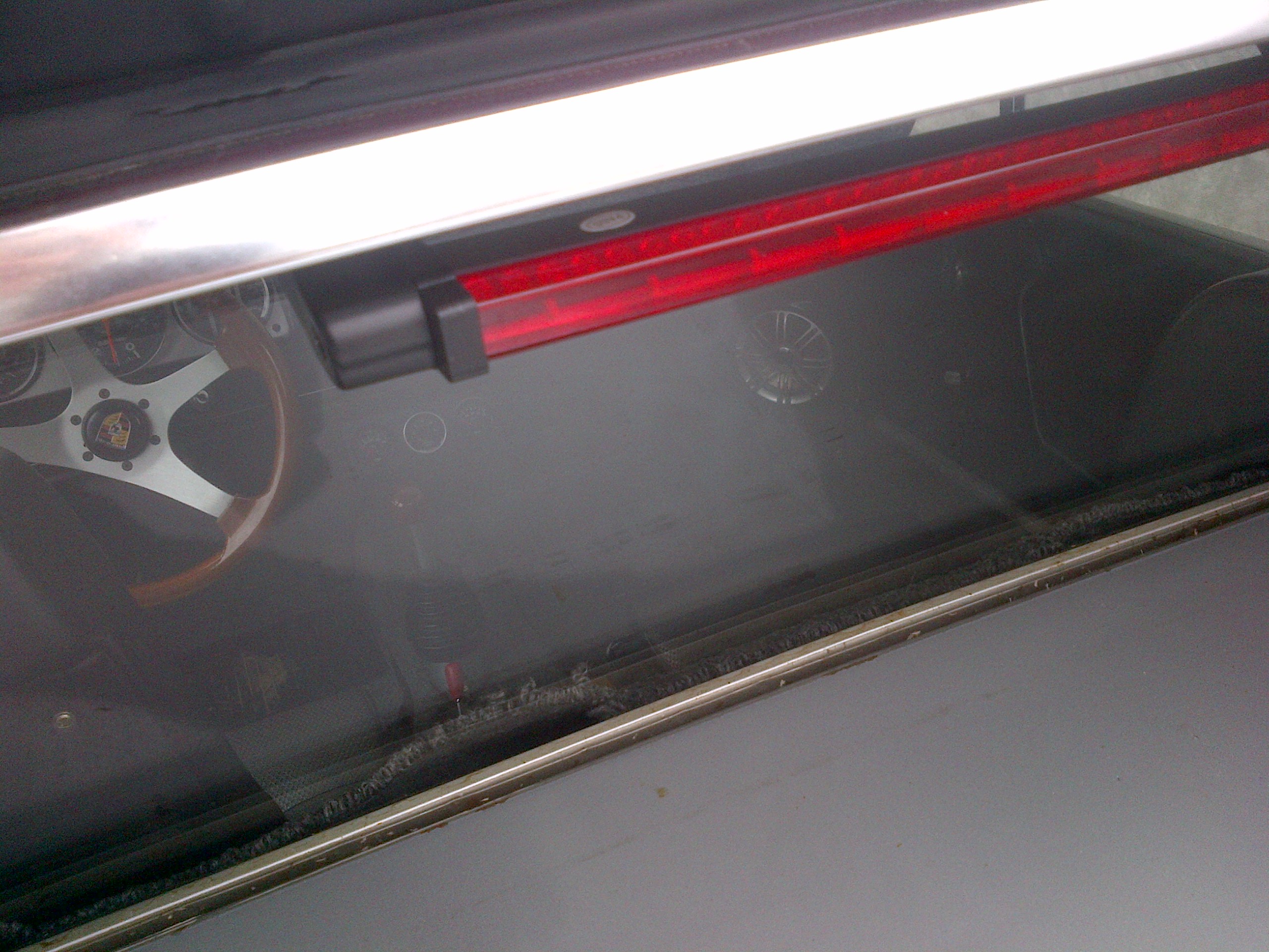

I saw a great solution for a 3rd brake light at RRC. Ernie had a unit from an 80s or 90s Chevy Suburban or Blazer- they bolt on to the upper tailgate with 2 bolts and come off just about that easy. The 2 wires tie into the brake light lead and a ground while the existing 2 bolt fit through the grill in the engine cover and bolt back up. Easy! Simple! And looks pretty damn good... I know, I know, THIS THREAD IS WORTHLESS WITHOUT PICS!!! I ain't got any but go to your local boneyard. They've got at least 10 of em there and they're cheap. Hell, buy 2 and give one to a friend as a late Christmas present! santa_smiley.gif
Cuda911
Hmmm... yes... I'd like to see some pix of this.
mgp4591
QUOTE(Cuda911 @ Jan 2 2015, 02:44 AM) *
They're mounted on the tailgate surface so they're designed waterproof from the factory- wish I had pictures to show you. I was thinking maybe 2 of them, one on either side connected to the turn/stop lights so you've got both signals and brake lights visible from above the taillights. More visibility= more safety.

The GoWesty one sticks onto the rear glass - so no reflection is possible - period. It's a clean LED unit & adds that is enclosed from the back (drivers vision) side.
This is on sale for $25 now - regular price is $30 - so I sincerely doubt that a Volvo part is going to be less than that!
I also doubt that the Volvo one is any brighter than this multi-LED unit.
It's an interior mount, so no need to be waterproof, although the casing appears to be similar to some other exterior trunk lid mounted ones that I've seen.

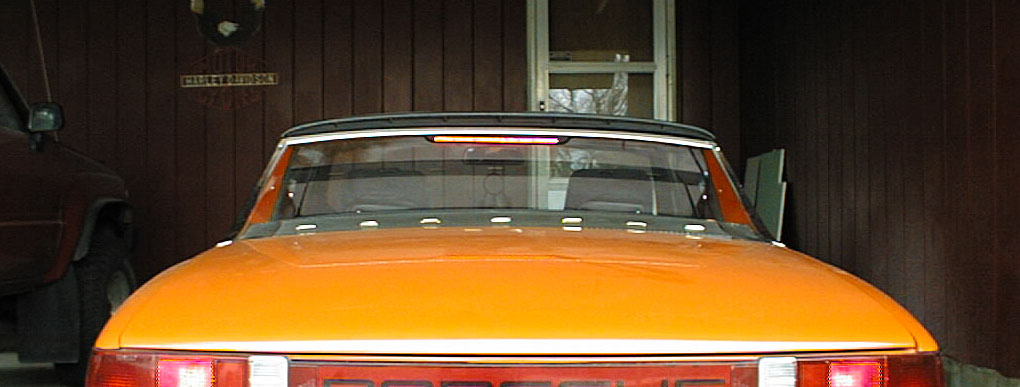

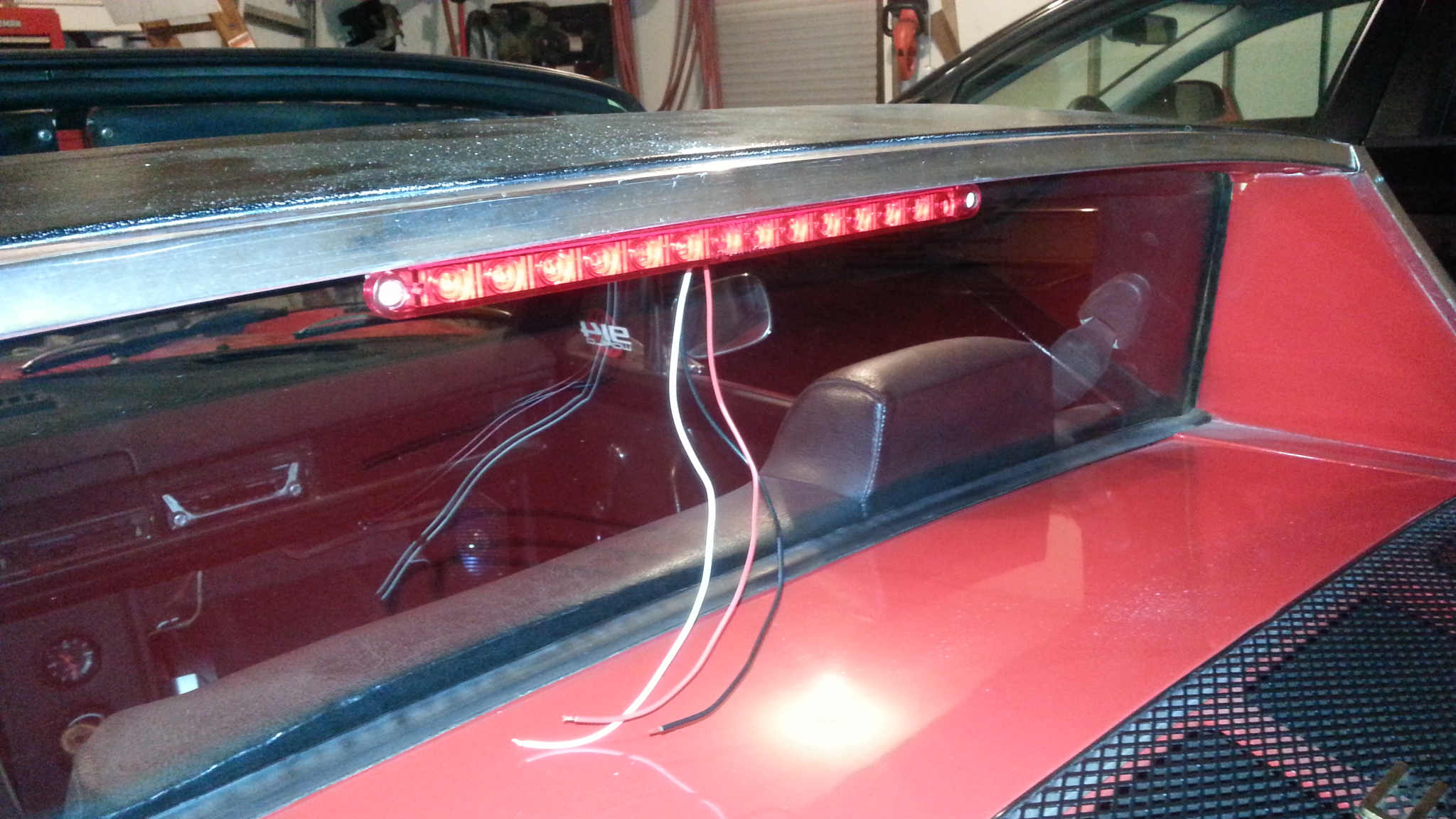

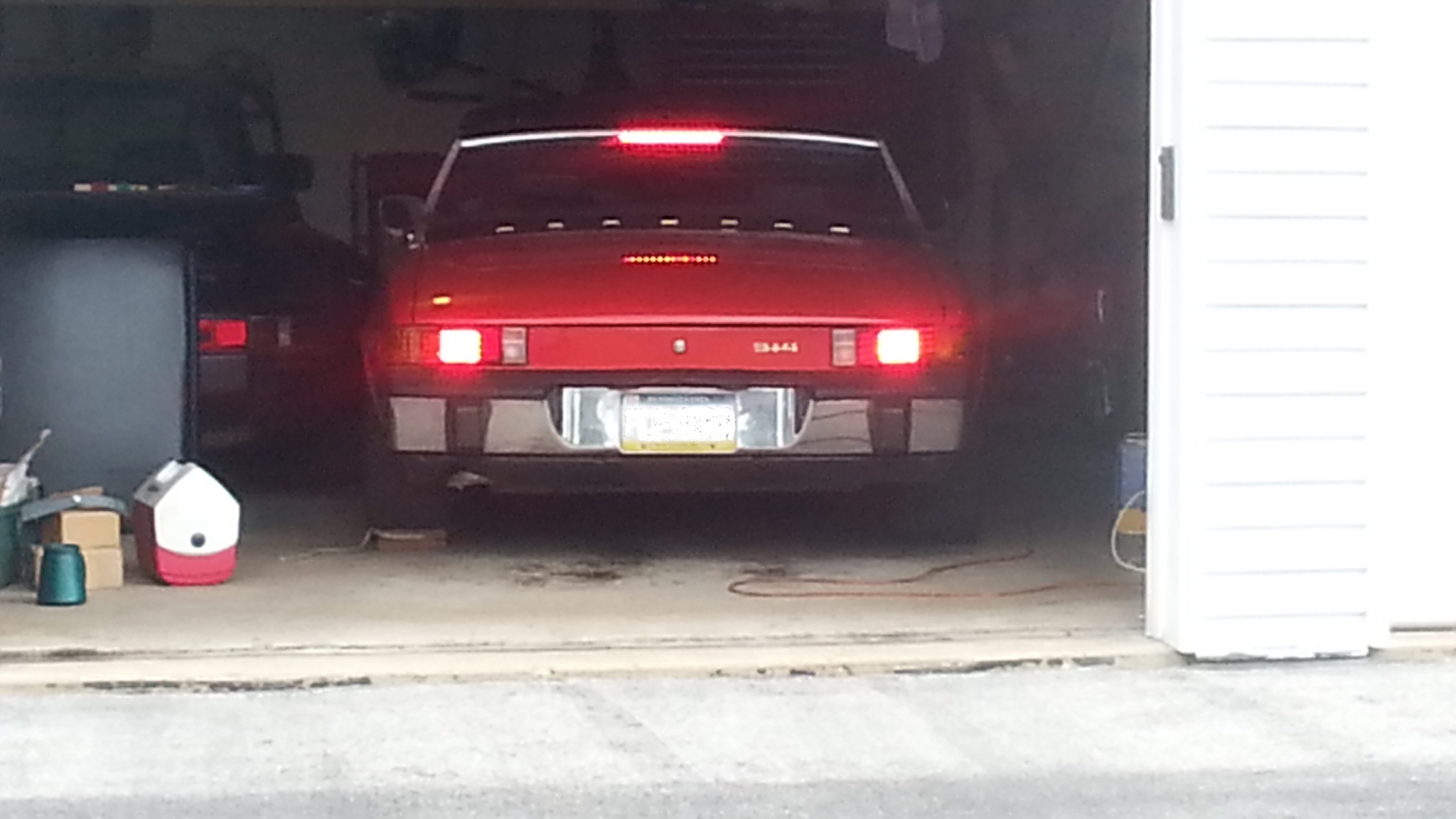

I did this; Got the idea from another members post and the light from banggood.com for less then $10 shipped (might have been less then $5).
Ran wires through trim and into engine bay then to trunk. took maybe a couple of hours total. another possible solution.
No glare, under cover and works great. no turn signal, just a third brake light with 26 LEDS.

How did you attach it to the underside of the roll bar?
BTW - the GoWesty one is brake only too.

It had the sticky pads. so if need be you can remove it, but then will need to get new glue pads. I got a roll of 3M outdoor adheasive strip for maybe $5.
We also used this on my buddies 356 and attached it to the inside of the window. you can adjust the angle of the light. On his you can see a reflection on the glass when it is on but it doesn't affect the view out the back. its just a red glow.

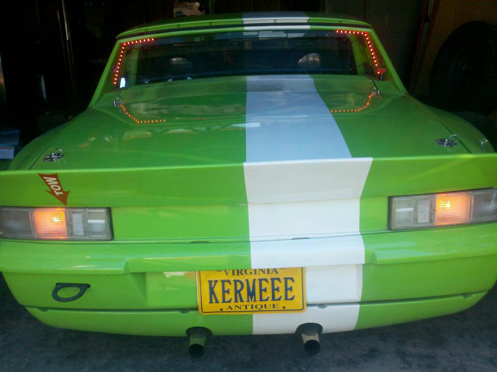

wndsrfr
QUOTE(Tom_T @ Jan 3 2015, 01:39 PM) *
IPB Image
I did the ones on Kermee using $25 strip LED's from Autozone. They have adhesive backing & stick really well under the Targa bar. They're tied into the wiring back at the rear tail light harness. A bit of noodling around with a couple of RadioShack diodes on each side provided turn signal functionality as well.

Just this weekend I did a 3rd brake light on my own 914 using one of these,
http://www.amazon.com/Custom-Dynamics-Knig...ag=theampfor-20
I mounted it facing down, underside of rollbar chrome. (will post photo later).
I have to say that it is a definite attention grabber and it looks factory installed. I used the mounting tape and did not cut or tap any wires as I picked up some piggyback quick connects at Radio Shack and simply used the existing brake light spades. Ran the wire underneath the chrome strip and through trunk. Needed a bit of extra wire but since these are LED, you can use 18-20 gauge. Again, you would really have to look for anything that looks not original. Took me a total of maybe 30 minutes.

That's comparable time/ease on installation to the GoWesty one, & it too is also reversible in using the adhesive double-stick tape.
Please do post your install pix here when you get a chance!
BTW the GoWesty kit included the piggyback connector also for the Vanagon/Westy install, but I suspect you'd need extra wire for it on the 914 case as well.
I noticed in the description at your link to the item above, that it also includes the TS flashing + 3rd brake light function, so that's an added benefit.
I wonder if it could also be installed inside the cabin under the rollbar? idea.gif

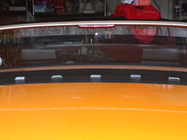

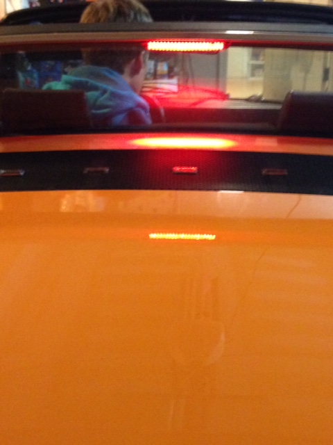

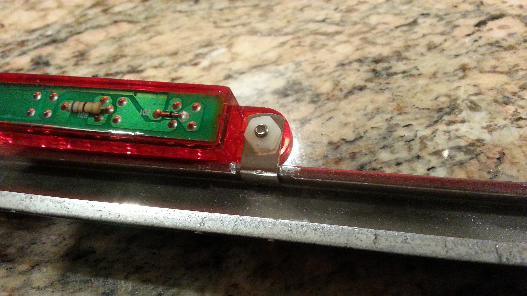

There should be no argument discussion on which 3rd brake light solution to go with on your 914. They all NEED a 3rd brake light. If you don't have one on your 914 you should be looking into a solution.
Don't wait until this happens to your 914 before installing a 3rd brake light. The 3rd brake light may not have prevented the young girl from slamming into my 914 but the 914 would have had a larger brake light footprint.
Now I'm using United Pacific 38949B - United Pacific LED Taillight Bar available at Summit Racing. They come in 6, 9, and 12 inch lengths. This is the 12 inch model.
My goal was to be minimally invasive to the car and not cut or splice anything into the wire harness.
The light doesn't block any rear view as it is hidden because of the interior roll trim.
I used 2 right angle supports to attach to the roll trim. A little filing of the rear of the roll trim for the angle brackets are the only modifications to the car. The wiring is run behind the roll trim.

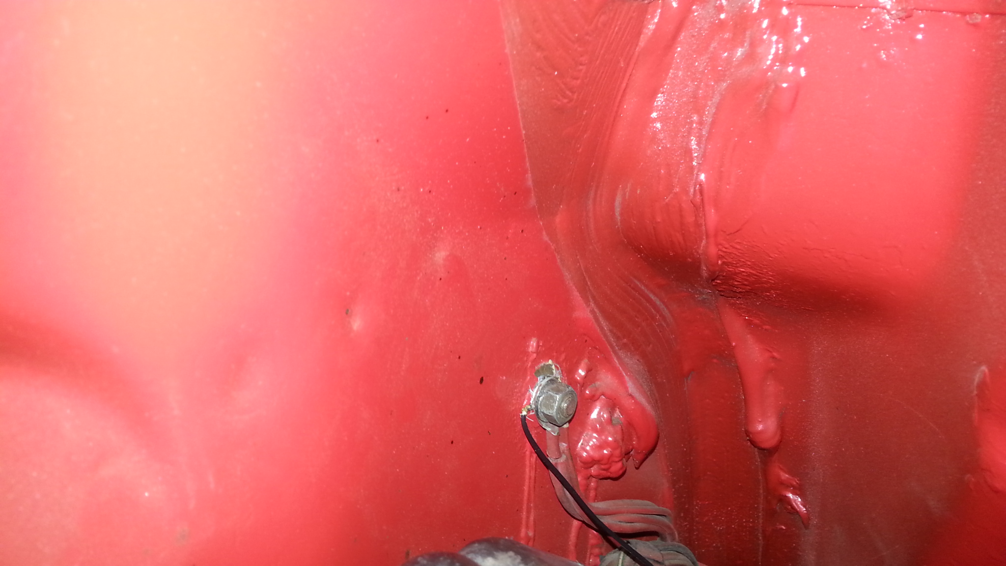

Ground attachment behind the relay board.
Used a piggyback spade connector to tap into the brake circuit.

Great pix Jerry, I'm sure those looking at this will appreciate them! thumb3d.gif
I realize now that I should've done a mock-up of the GoWesty one on my 914 for pix for others before mounting it on my Westy, so that others could see that alternative too. dry.gif

PS -
This is the GoWesty sold unit by itself for size comparison to the others on here:
Click to view attachment Click to view attachment
I just measured mine on the Westy, & the overall unit is 9" W x 2" H - which includes a 3/8" flat flange all around for the sticky strip to adhere to the glass, & the back housing is 8-3/8" L x 1-1/4" H & 1-1/4" D - with a standard 1/2" H x 8" L LED strip that swivels within the housing to keep it level to face out properly (so no need to invert it for the 914's back-sloping rear glass).
I think that you can tuck the upper mounting flange up between the 914's interior upper rollbar pad & the glass, & simply trim off the lower flange if it intrudes into the vision area too much. Anyway, that's my thoughts.
Because this is set up to mount to glass & swivel to any angle of rear window slope, I'd bet that they are also available elsewhere online, FLAPS, etc. as well.

Kermeee had that set-up plus a L & R down-leg, which I assume the verticals are the turn signals portion at the L & R sides.

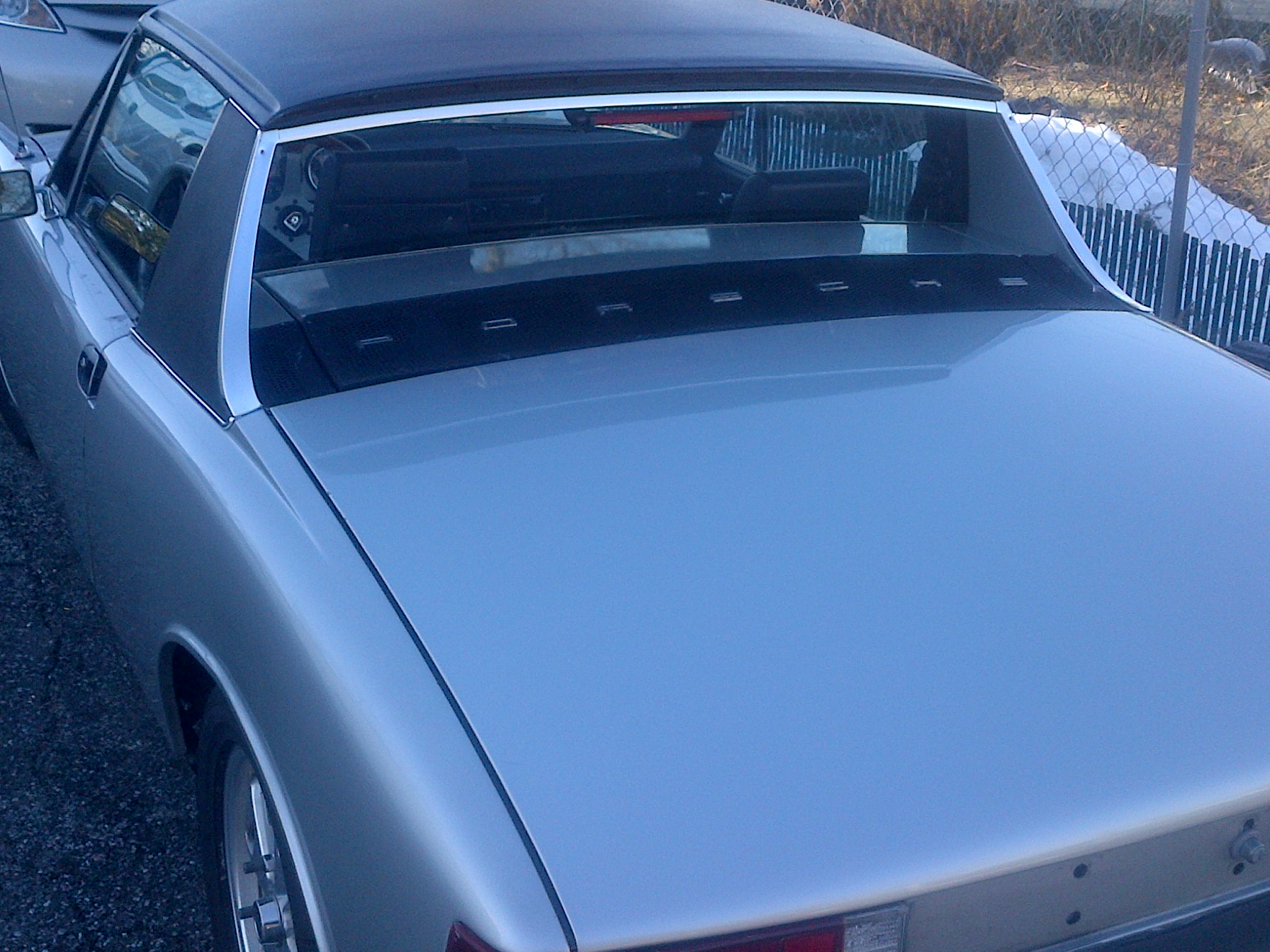

IMHO, it's better to mount the third brake light low (on the engine lid) because the upper part of the roll/targa bar seems like a good idea until you realize how much it can block your rear view mirror.
The corvette unit can be polished as well. drooley.gif We did it on a customer car.

Amphicar770
QUOTE(Amphicar770 @ Jan 3 2015, 11:52 PM) *
Looks like a nice solution.
I did not enable the running lights (just snip and insulate blue wire). The flashing stop light feature definitely commands attention. I put a piece of black electric tape along the window side so that it does not light up the cabin. If I were starting over I would probably just use some flat black model paint on that side. Given that the 914 sits so low, I like the fact that the light is mounted up higher where SUV's and minivans are more likey to notice.
