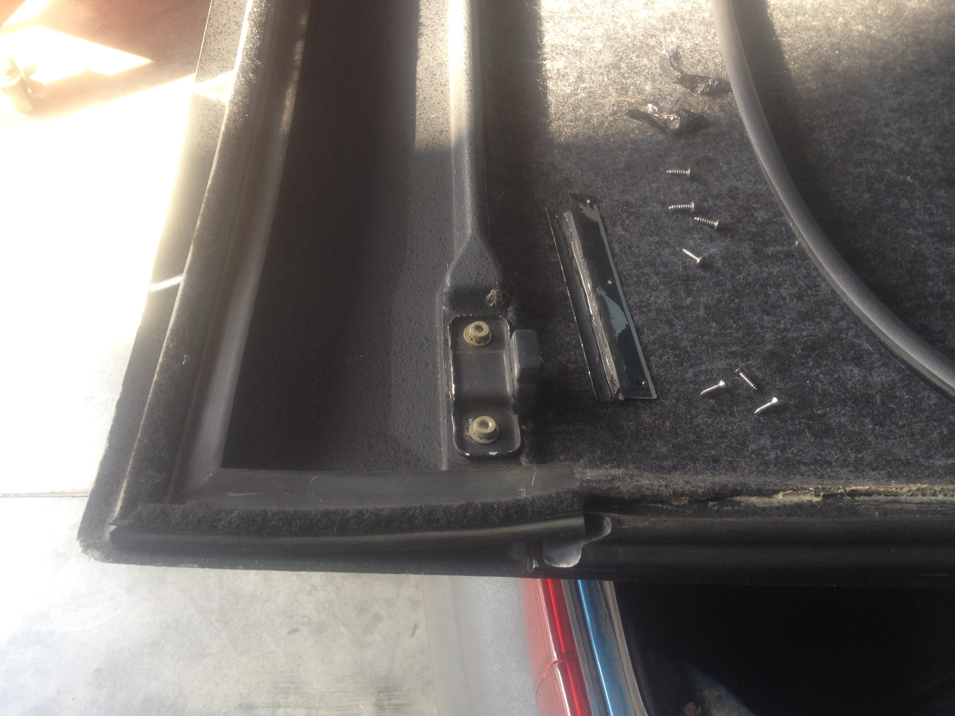

I'm asking more about the side metal piece(s). They are mounted between the top and the seal on the sides (it is not visible with seal installed) whereas along the rear of the roof/seal, the metal trim mounts above the seal (it is visible).
This piece has a "flat" bit (shiny in pic) and a "curved" bit (black in pic). I have read (don't have the link(s), but search for Targa Top and you'll find them) where some have trimmed the curved bit off as it tends to interfere with the new seal (not a product issue) and others have a different solution.
Just looking for ideas, I will likely trim it all to fit and just ensure it is secure and properly located during install. I suspect it will cure the rattling regardless.

The metal will mount on top of the seal just like the OEM. Do the corners 1st. The metal is a good guide for the holes as they will not move. As far as trimming the seal. It needs to be fitted to the roof. The vertical targa seal should touch the corner of the other seal (targa to window seal), and the rear seal you have should but right up against it. Assuming that your targa to window seals are sealed correctly on the outside corner, the rear seal should end right at that joint. One of the reasons I make these longer is for a perfect fit. You will have to check before you cut as you may want to adjust the targa to window seals.
A piece of trivia for those that don't know NEVER pull the targa to window seal through the track. You may think you have compressed it back, bt rubber has memory, and if there is ANY tension, it will be relieved over time and allow the seal to "shrink" back to the manufactured length.
The correct way to install is the outside edge 1st, then pop in the inner track. Also, if you need to trim a new carpet knife and some warm soapy water and you can cut it like butter. You can actually get it to seal very nicely, just shaving off a little at a time until it compresses when the latch is engaged. It makes a wonderfully tight seal at the corner.

And I just noticed the short piece of metal in the picture. It goes under the seal and is glued to the seal. There is a top piece that will sandwich it. So you can dry fit and use a little glue once it's installed to hold it onto the seal. A small dash of black silicone would work well. Not required, but helps put a little more pressure against the roll bar.

"POP" the inner track in, I'm referring to putting the outside edge in the track 1st, and pushing the inside edge in with a screwdriver carefully. So not to scratch the chrome track. You can see from the profile why the outside has to go in 1st.
